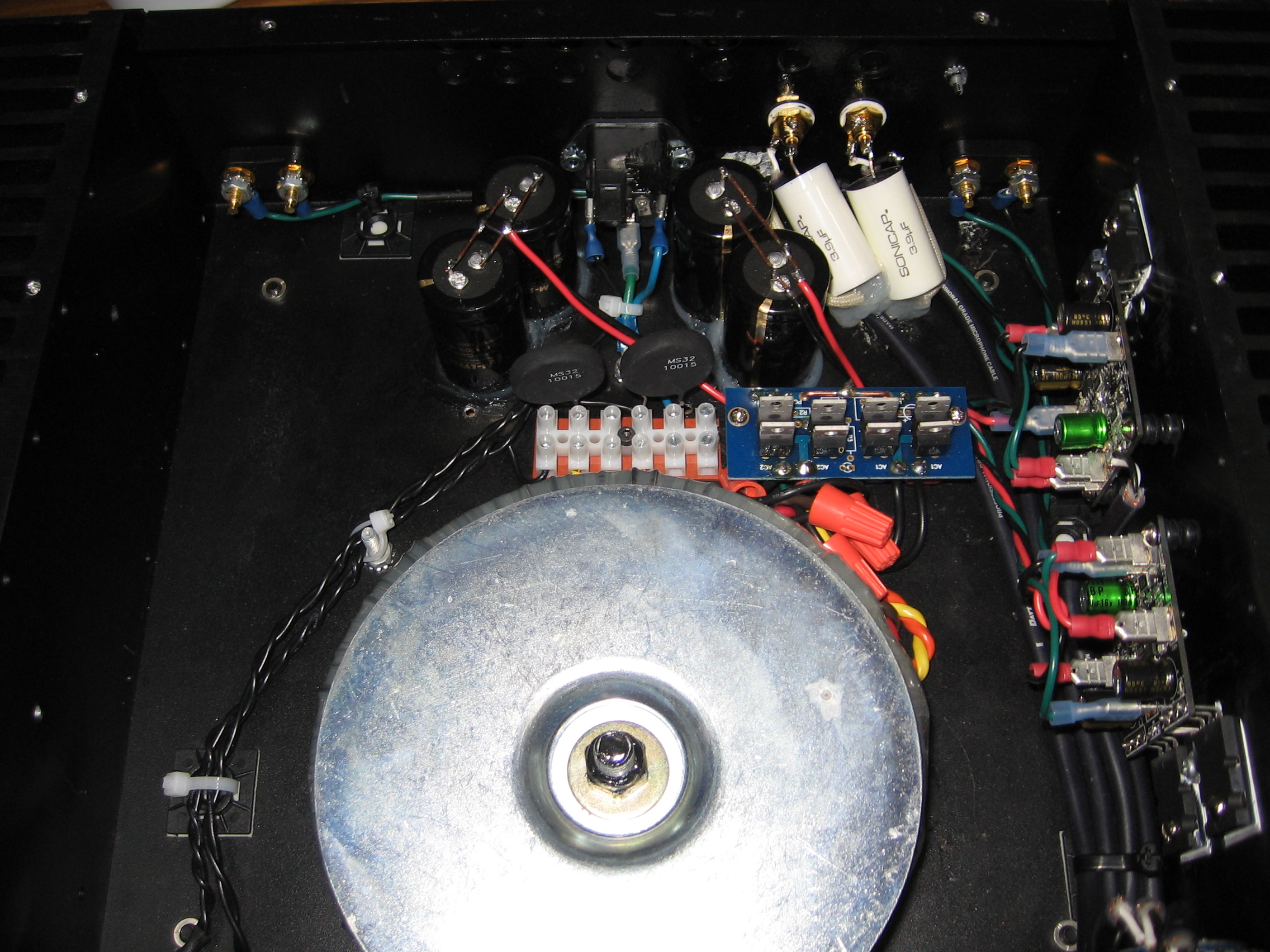

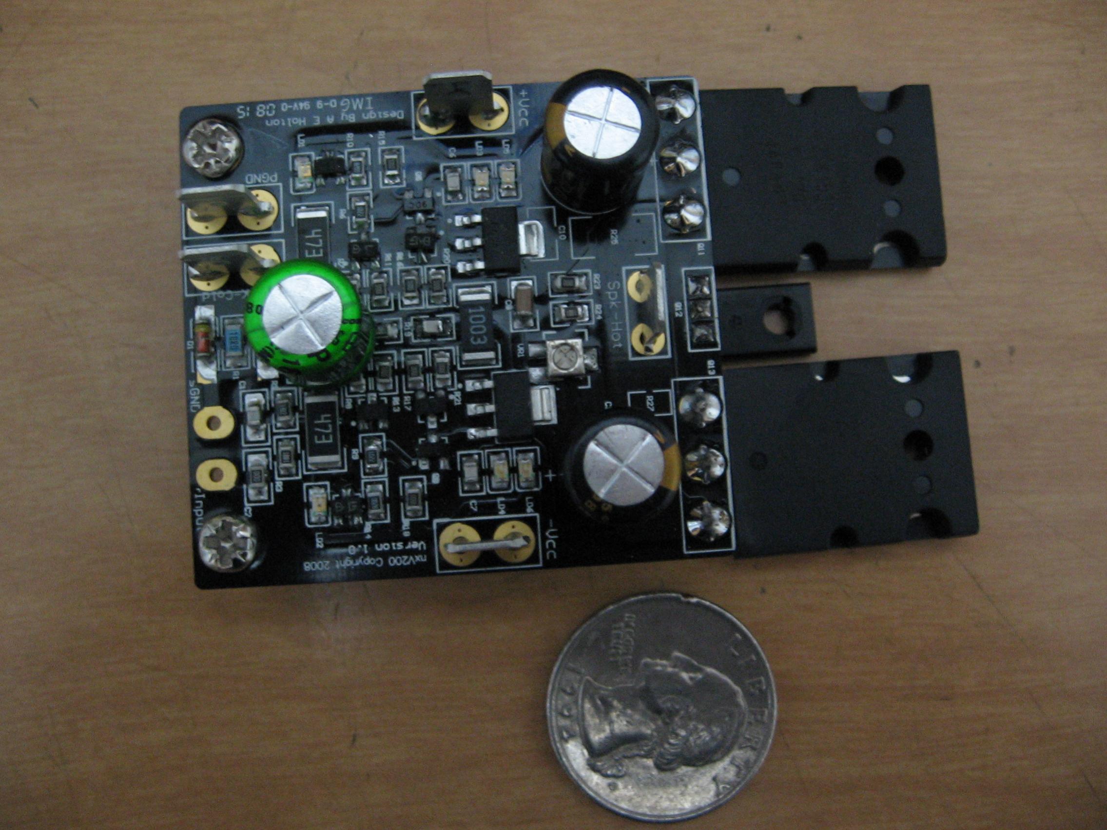

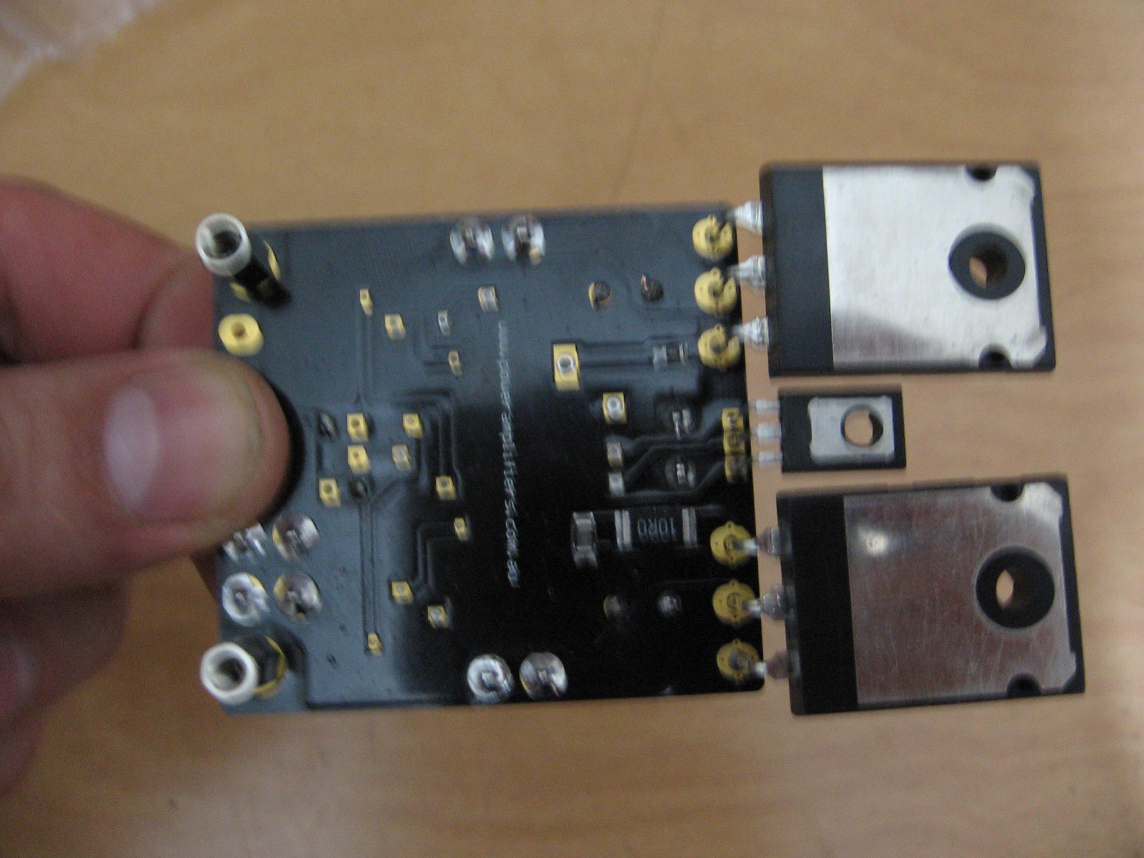

Ok, I have had good results from these two sources. The first is with Peter Daniel Audiosector.com the LM3875 kits are as easy as it can go and they sound really good, I would sugest to use a lot capacitance at least 10,000uf per rail. The kits come with just 10uf caps. and the other (My favorite) is from Aussie Amplifiers I got the NXV200 kits, they are small modules but Carrie big punch.
the sound is wonderful and believe it or not this NXV200 kits if they are married with an adequate power supply, it will compete with amps costing thousands.
The kits are top notch quality. Check pictures.
These two providers are excellent but you have to do your homework before you decide the one you need.
