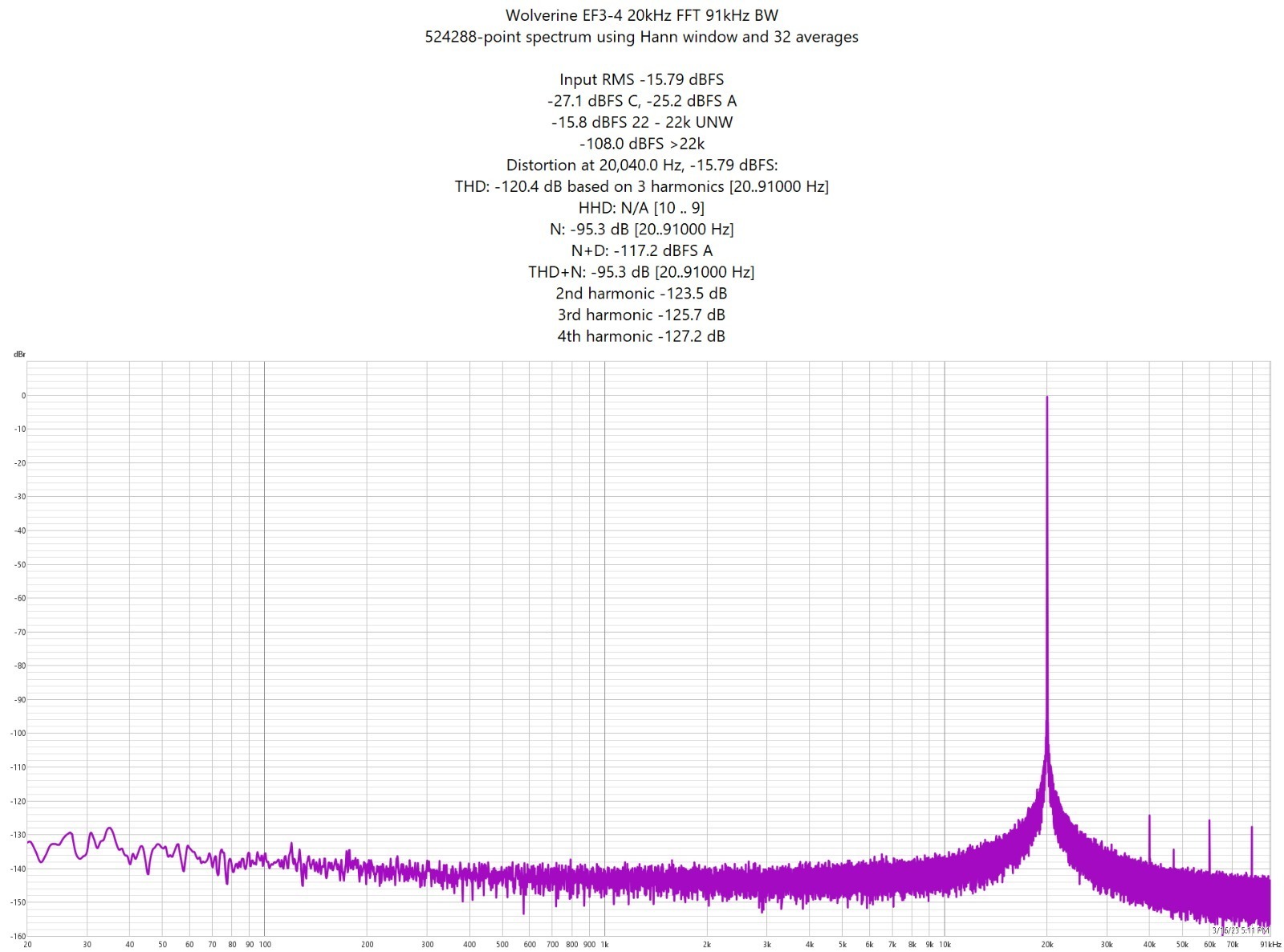

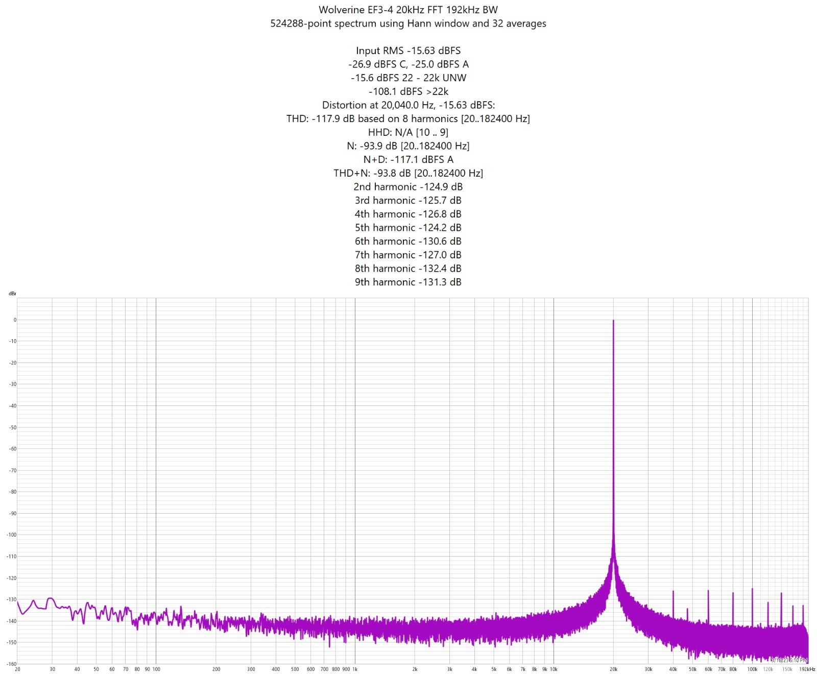

found near-perfect agreement with simulation.
This only applies if the simulation models are accurate and additional parasitics are placed in the appropriate locations on the simulation schematic to immulate the behaviour of the pcb. Inductance, capacitance etc.
We added all that to our simulation. This increased the accuracy of the simulation predictions.

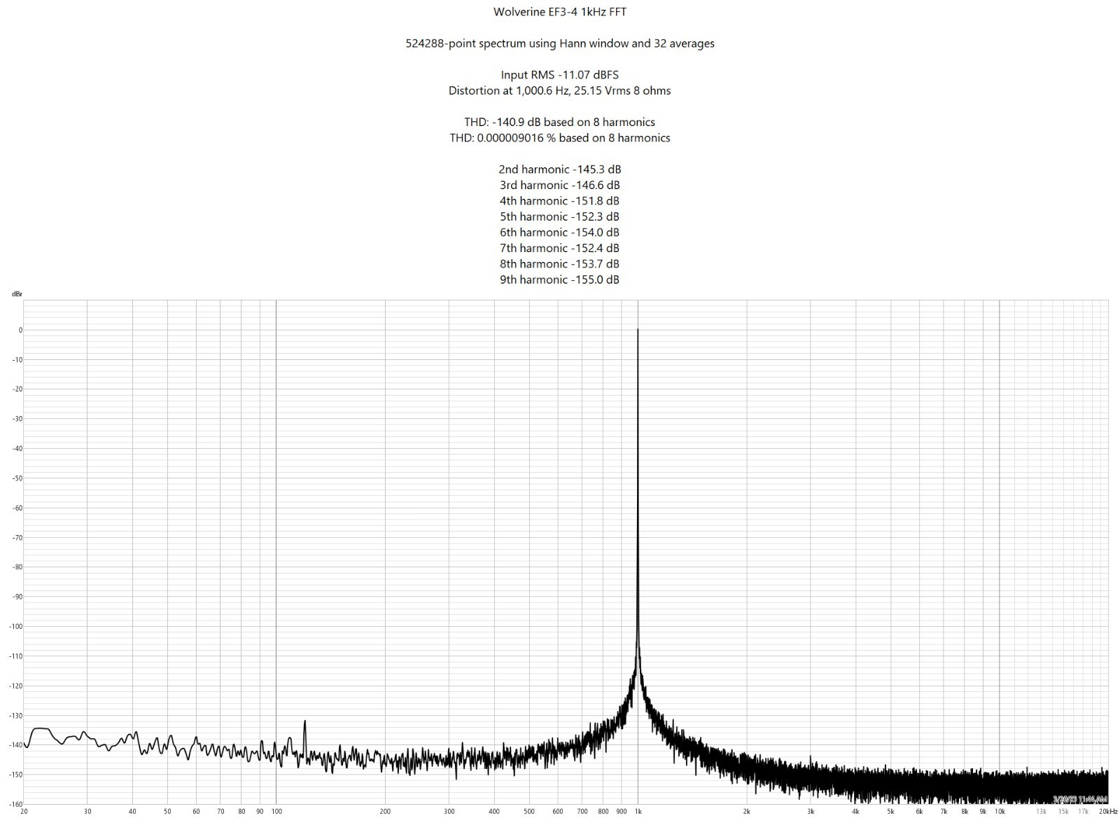

The Wolverine was tested at 80wrms we felt this level represented an appropriate amount of power for home listening.
Plot attached by @fireanimal
