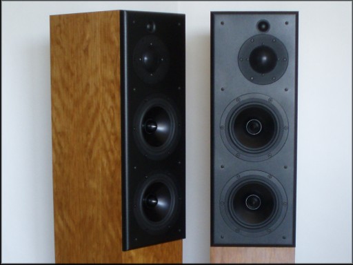

I've built 3 of Paul's designs so far, the ZX Spectrum, the Overnight Sensation and the Classix II, all of which sound and behave pretty much exactly as he says they do in his descriptions. I have no doubt that the Tarkus performs pretty much spot on with how he describes it:
"The Tarkus were designed to play loud, play clean, and to bring rock recordings to life.
Rant on: Unlike classical and acoustic music, Rock recordings are not meant to emulate a concert hall. With rock, everything is close-mic'ed, sent through effects, and mixed at a console. It's a studio sound, and it is what rock sounds like, and there should be no shame in that. Furthermore, the production of rock music is part of the composition itself. Consider for example the work of: George Martin (The Beatles), Brian Wilson (Beach Boys), Alan Parsons (Pink Floyd), Trent Reznor (Nine Inch Nails), Phil Spector, Ted Templeman (Van Halen), Terry Date (Pantera, Soundgarden), Mike Stone (Queen), Bob Rock (Metallica), David Bottrill (Tool, King Crimson), Rick Rubin, Andy Wallace (Nirvana, Jeff Buckley, Rage Against the Machine).... The list practically never ends.
And it's not just rock music that is so heavily influenced by its production. Other genres such as Country, Pop, R&B, and Hip Hop also rely on recording production as an integral part their sound, and the composition of the songs themselves. In some ways, it boggles my mind that more speakers aren't designed with this in mind. Rant off.
The Tarkus are indeed capable of producing the "pant-leg-shaking sensation" when cranked up past 100 dB. However, at more conservative listening levels, say 80-90 dB, I have found myself very surprised to hear depth and resolve in rock recordings I never would have imagined were there. Even at "quaint" levels of 70-80 dB, the Tarkus are still a lot of fun to listen to, and their ability to play low bass confidently still comes through. In fact, I think the thing I enjoyed the most from this design was the ability it gave me to differentiate the kick drum from the electric bass, and hear them separately--not sort of "mashed together" as is the norm on smaller speakers. (To explain further: kick drum is typically identified in a mix by the attack around 2-4 KHz. This way, you can hear it on any old speaker. What you typically do not hear on smaller speakers is the actual resonance of the kick drum, which is very low, anywhere from 100 Hz down to below 20 Hz, depending on the size of the drum and its tuning. You can rarely pick this out on a normal speaker because it gets mixed up with the electric bass (or is removed altogether by the mix engineer). The larger woofers in this design, however, let the two coexist, which I really enjoyed, being a drummer and all)
So enough talk. Guys have been clamoring for something bold and loud, and this is my contribution. Forget the Telarc, Mapleshade, and Sheffield Labs CDs--these speakers are for the rest of your collection! (You know, the stuff you'd rather be listening to.)
yeah, i think I'm going to build the tarkus. a few people have recommended it already. seems like a good first build.
and crossovers seem like tricky business. especially if you do them yourself. I've already started reading about them. i'll have to get some of this software i keep seeing that helps people fine tune speakers.
Iggy.....Hi there....Looks like someone here with the Tarkus has done your "homework" for you....That said, how are your woodworking skills?? The enclosure is an advanced design & can get beginners frustrated....

Yes, it sounds like you know your way around the sawdust pile...What I was trying to get across was....Make it your own. The Tarkus seems to be a well thought out build....but you can change things for the better, according to you own tastes.
The Tarkus builder has some apparent Math work done...note the Bass driver is angled up slightly, now this could have been done scientifically for two possible reasons (That I'm aware of) 1) The driver is angled up so the listener is more "In line" with the driver...It's pointing AT you...this assumes you will be far enough away as to be "in line". 2) The angled front baffle was created for an internal volume of mathmatically "random" proportions.
If this baffle was created for esthetics alone....you can "do as you please" in this regard.
No doubt the spacing between the three drivers has been correctly calculated & should not change. Now...the driver arrangement along the vertical axis was most likely a rule of thumb decision. There is, a mathmatical modeling of "where to put the driver" on a panel....the location within, say a square (Not the best) front baffle...lots of math here!
These calculations can get intense sometimes.
The two seperate enclosures (Bass & Mid/tweet) could have been mathmatically derived...one would have to ask the builder......I think is was again an esthetic decision.
There are two enclosure dimensions that are/were used. The "Golden ratio" & the "Acoustic ratio"...The acoustic ratio is a standard mathmatically derived dimension.
All in all, make it your own....perhaps you can come up with something more esthetically pleasing, without "degrading" the sound quality.
