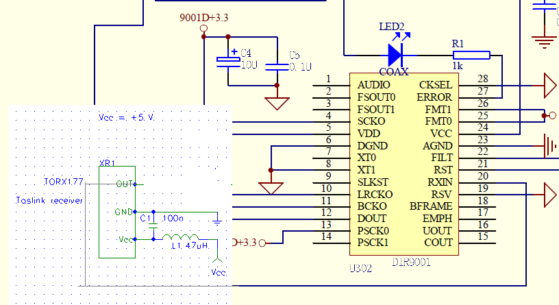

I would like to use this optical->coax converter to connect LG TV to my Wolfson diy DAC (the scheme is in att). One thing confuses me a lot - where should I connect ground of the converter, should it be 'IA+' of 26C32 on the Wolfson scheme where Coax input is or the whole conversion would be a wrong approach?! I mean that it's possible to connect TOSLINK directly to DIR9001. I have found few links, but didn't get completely how should it be done:
SPDIF decoder (receivers VCC pin could be connected directly to +5v via L1 or somewhere else too?! pls see att)
audio DAC with 9001 and TOSLINK
I would very appreciate if anyone could help me with the simplest way connecting toslink to DIR9001 🙄
A 5V TORX part into a 3V DIR part raises red flags. How is voltage limited to the DIR9001?
Yes, that's how they mark them. 177 and 179 are interchangeable. 177 is better part in my estimation. Though it doesn't have the chassis mount screw so more stress on PCB solder joints. Both are fine for optical links.
hi Iain McNeill,
thanks! seems I got the point. Voltage is limited to 3.6v on DIR9001 according to the manual, so 5V torx part as you've said will not suit then...
What could be the solution in this case? Making separate optical->coax converter and then connecting to coaxial input of my DAC?

Hi dtses, The circuit works fine because there is 3.3 volts supplied by a regulator. The DIR9001 is on 3.3 Volts, the DAC chip and Torx are on +5 Volts. The input signal compliance isn't an issue. I hope that answers you question.
hi Torchwood421,
all in all, could I use in my diy wolfson dac torx179's connection scheme like in microdac-3 (scheme is above), I mean direct torx's signal to RXIN of 9001?
will the circuit in 5th post work with COAX input of my dac?
