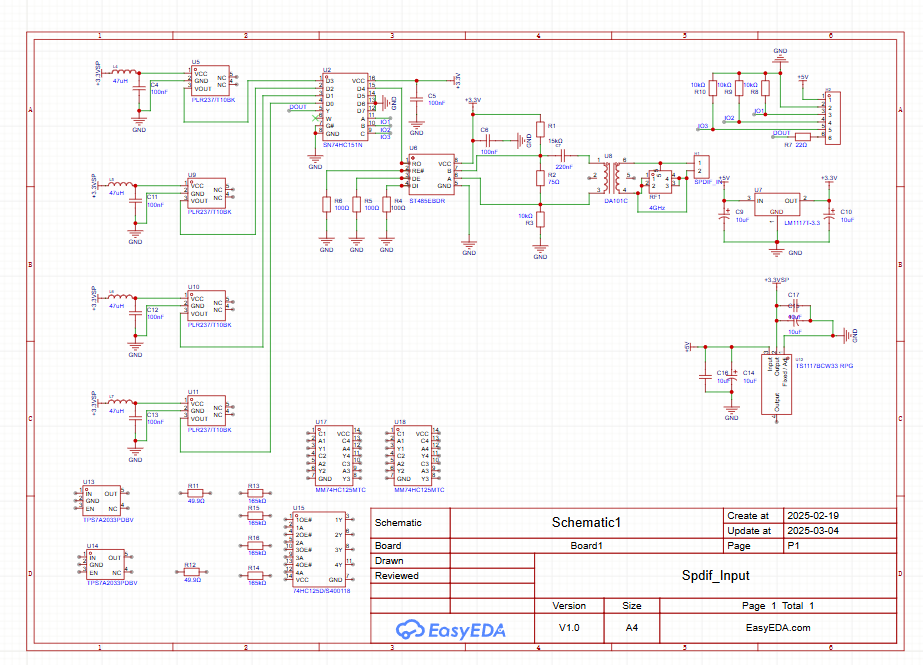

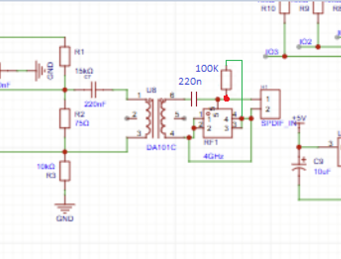

DA101C pulse transformer added
one 220nF cap at DA101C skipped

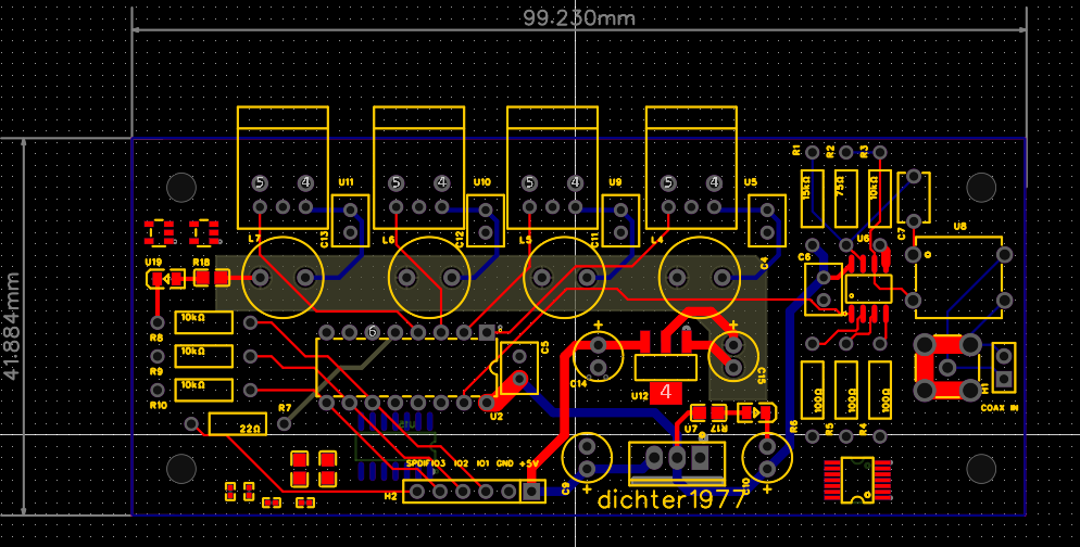

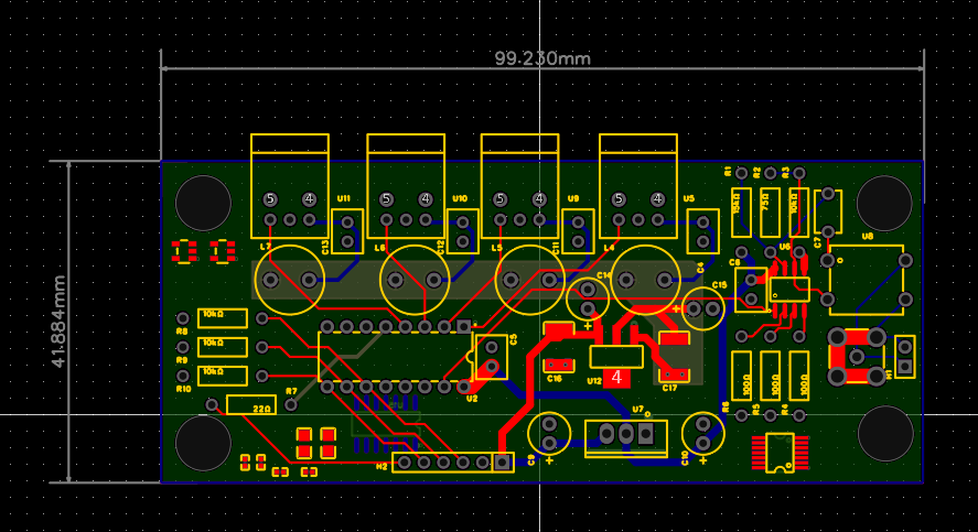

seperate LDO for the toslink inputs; i had designed with TS1117, AP1117 also possible because of same footprint, decision depends on online availability. For the decoupling capacitors, i have added 2 footprints one through hole and one smd. After another look in the TS1117 data sheet i am uncertain, they prefer MLCC capacitors, other type of cap is available as through hole version.
added a mini 75Ohm mini coax socket, at the moment i don't not have audio source with just coax spdif, everything is with toslink. But you never know, if it is necessary later on, a coax input can be easily added to the housing.
added some footprints for solder checks, at unused boards
Feel free to comment, please.
I don't like the idea with the to footprints for one cap, i had decided to use trough hole, because i have some in stock and everything available as TH.
As last change, on each voltage regulator output a led was added, to create a minimum load for the regulators and optical indicator. The assembly is optional, just planned in.
If there are no further hints and critics, i would like to go with this version.
There is always a load isn’t it?

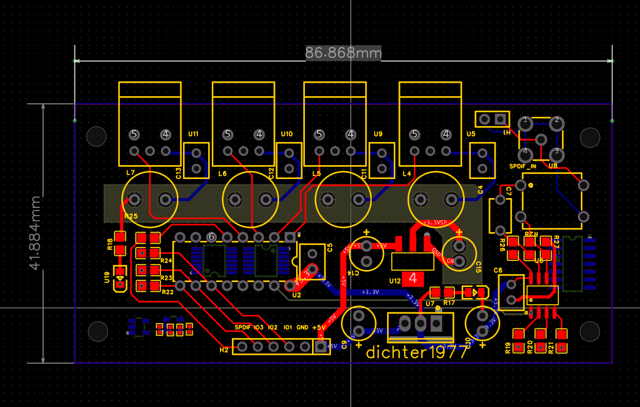

Still think the coax connector should be either RCA or BNC in the same direction as the others. This is such a design choice regretted when a (normally superior) coax interface device will be connected. The way it is done now will require an ugly extension cable. PCB mount BNC have the benefit of having a large nut to mount the complete PCB to the plastic casing.
I solve the SMD/TH cap choice by having footprints for both. Costs nothing.
The 45 degree corners of the thin PCB tracks come too close to other pins without a valid reason. They also not go in the middle of for instance L7 pins. Ugly. Solved by adding more corners.
Having both large TH resistors because you have them AND SMD resistors is weder Fleisch noch Fisch 😉 and also frowned upon by yourself later on. As an example: 0805 10 kOhm and 0805 22 Ohm at the left make the board smaller and/or connections are shorter. When also done at the coax section the PCB can be smaller with same functionality. Smaller usually means more easy to mount in a device/casing.
Not sure, how much load it has without input signal. The AP1117 data sheet includes a minimum load row. Is optional, as you said costs nothing, if not needed.
I is there an advantage from electrical point of view, mounting the RCA/BNC connector to the board. I would like to prefer the more flexibility in mounting the connectors. Housing is an open decision, regarding size, material and so on.
Yes, was always planned as XOR solution.
Good point with the 0805 resistors, at the moment soldering the ST485 is the challenge for me. IMO this would at more challenges form me. Nevertheless i have to improve my solder skills in the future, because the board with Teensy has to be SMD and size will matter.

I follow the advise of a coaxial connector. And regarding the mechanics, if you have used M3 hardware, make sure you have a circle of 7mm diameter around your holes free of everything. No pads, no components, no traces, no via's. Top and bottom. then you can be sure that even if you use a bolt with a washer and a metal pillar at the bottom that it won't make contact.

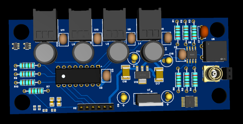

So i had done the most brave decision in my live, and switched the resistors footprints to 0805 and saved 13mm of width. Hopefully the tracks looking better.
Do you have experience width in pad via? Jlc is offering via under pad, maybe i have to check this with jlcpcb.
A DC blocking capacitor and its discharging resistor could be put in at the input side of the transformer, they are good to have just in rare case of hostile potentials presence.
What is the risk? Destruction of the Transformer, voltage breakdowns or something else. Can i use simple diode to shorten these voltages if there are to high?
Yes i will use M3 hardware, i had a look and it should work without any unexpected contacts. Generally i plan to keep the housing GND-free. For the power supply, 2 torodials will be used, one for analog and one for digital section. If the housing will be from metal only earth potential will be added, because of safety reasons. Generally the pcb holders coming out of a 3d printer, ESD protektion is also a point.
