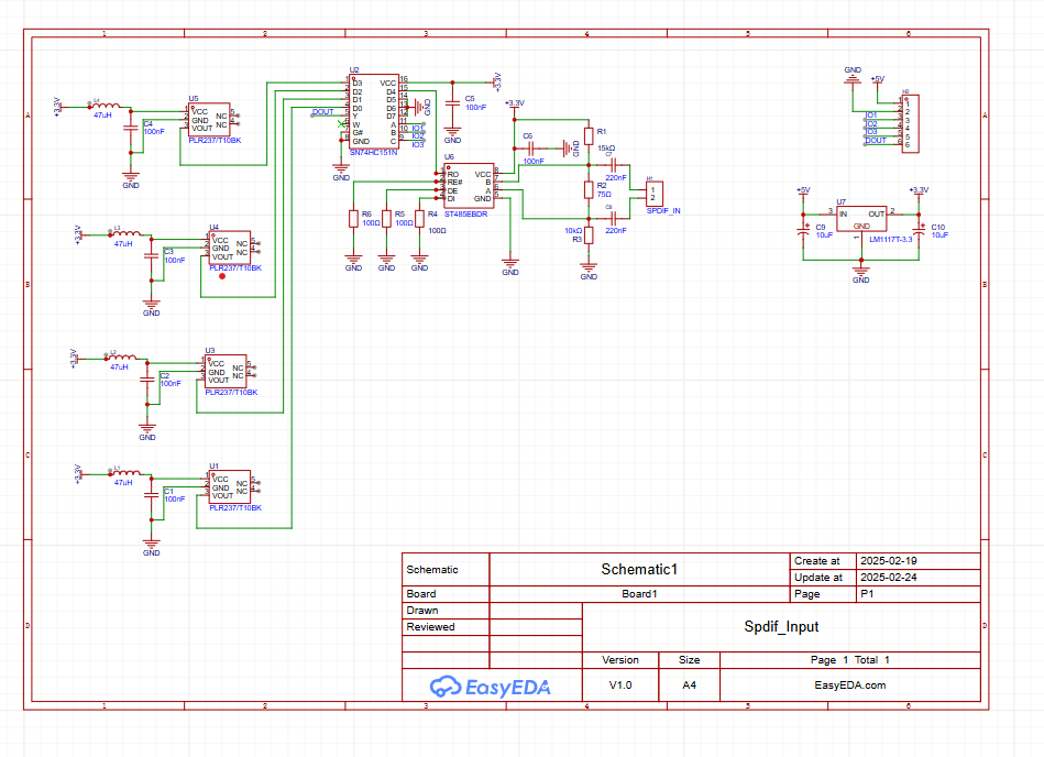

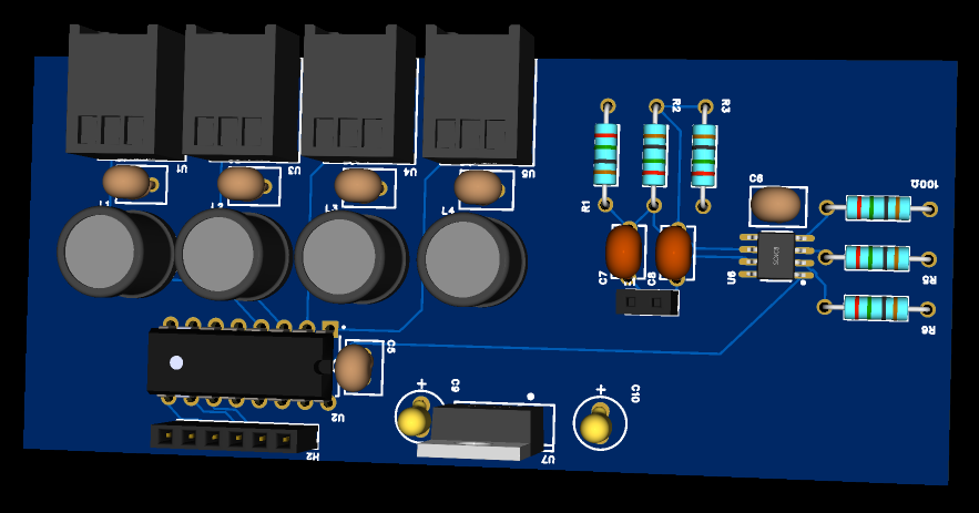

i have created a draft for an input selector that should switch 4 Toslink and 1 Spdif input to one output at cmos level. The switching itself should be done by HC151N. Dout is going to a Teensy4.0 SPDIF_in, the IC will be controlled by that Teensy via the IO-lines. I would like to ask for your support to find some mistakes or improvements, because. This is only my second pcb design and I am not experienced in this.
From my point of view, it would be better to decouple the Spdif_in by transformer, but which one to choose and how to connect? Should i pull down the IO-lines? Anything other to criticize?

Your circuit would work just fine. Murata DA101C is a good transformer. Just hook it up to H1.

I would go to a CBTLV3251 instead of the HC151. Same pinout and function but only in SMD available. These are simple fet switches, very wide band, minimal propagation delay and skew.
If i am not wrong, the HC151 is also buffering the signal, the 3251 is just switching. From my point of view, the propagation delay doesn't matter as long as ON/OFF has the same. Please correct me. Maybe i will add booth ICs to the PCB, so i can do some experiments and check whats better. Thanks.
Should i add some series resistors in the data lines as termination R?
Yes, the HC would also buffer the signal. But how long are your traces going to be? If you are staying on the same pcb, not going with a cable to another pcb then you really don't need a buffer. That 3251 is more like a relay, that is why I like it.
Also (more) important is if you are confident with SMD.

Dear OP, the transformer is only meant for coaxial S/PDIF. TOSLINK doesn't need a transformer as it is optically coupled interface.
Besides, the TOSLINK receivers are TTL and can therefore be switched via digital MUX, as opposed to analogue switches. As you've correctly guessed, the MUX is also a repeater that buffers the TOSLINK rx which has hardly any drive capability.

I would like to prefer the Murata DA101C for the coaxial input, but it is not easy to buy here. If i am not able to get it, would switch to the Pulse transformers.
The Signal is going to an other board (that has to be created), where the Teensy is mounted. --> HC151N Nevertheless thanks Havoc.
It is planned to use VCC of 3.3V, because of the Teensy inputs. I had checked the H/L levels in datasheets of the TOSLINK receiver and HC151, it should work. It is LV-TTL😉.
