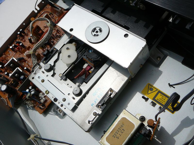

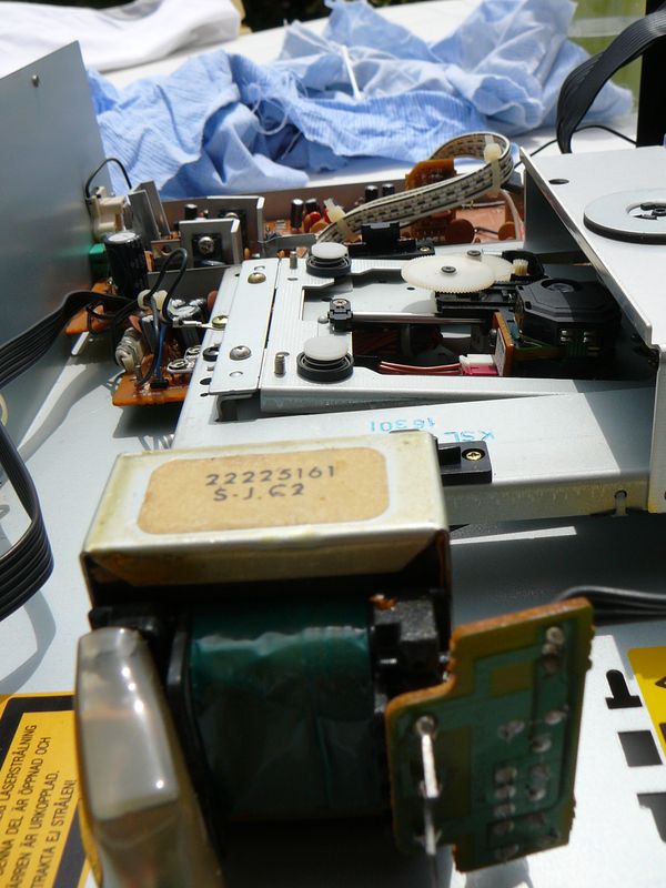

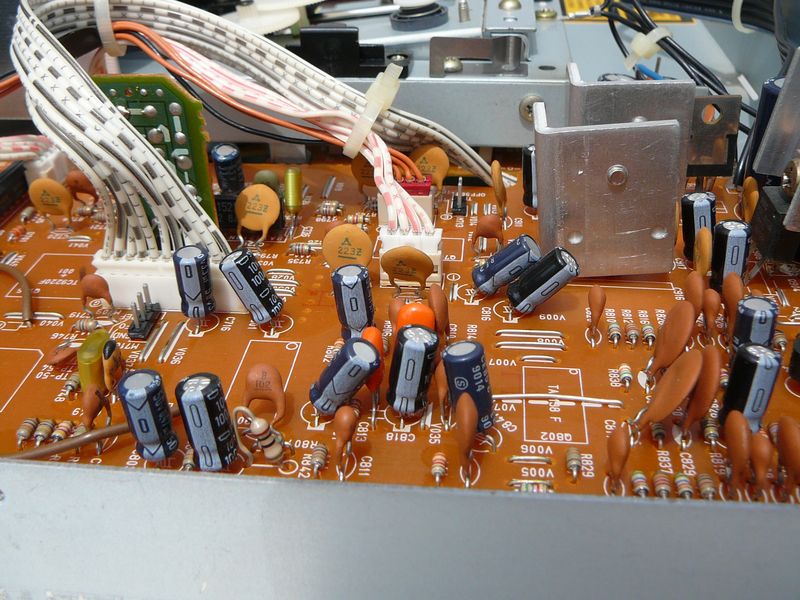

I bought this player in order to practice upgrading - I already have a pile of parts to use, so just needed a suitable player to work on.
I figured these upgrades would make a worthwhile 'phase 1':
  • Replacement of transformer with dual output torroidal.
  • Replacement of PSU circuitry with discrete capacitance multiplier type
  • Addition of secondary PSU running off second winding of transformer
  • Clock upgrade using Chinese circuit board I already have, running off secondary PSU
  • Replacement of electrolytics in signal path with polypropylene, possibly replace resistors in signal path if they are carbon types.
Then as phase II:
  • bypass onboard DAC and install upsampler and DAC boards (already have these)
  • install analogue output stage (buffer)
Thoughts, comments?
