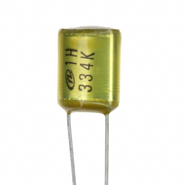

I'm not so sure there are any tants in there. That looks more like a monolithic filter (coil etc) of some sort encapsulated in epoxy.
I didn't see any tantalum on the board. However I was curious of what these clear things with capacitance markings were. The only thing I saw similar online were some pictures of similar ones that were supposedly glass...

With that said. I'm leaving them alone until I get my capacitance meter on them and see IF there is a replacement for anything like this. Most likely I'm just going to leave them alone regardless of what they test out. (Unless shorted of ourse)
They are plain old polystrenes, very common and sometimes might be referred to as 'Suflex' types.
Leave them be 😀 Tuner remember... even moving them could alter the alignment of the RF stages as you change the stray capacitance and inductance as they relate to other nearby parts.

Polystyrene. Don't touch, they are sensitive to heat (your soldering iron), but are otherwise not failure prone. The orange round blobs behind them on your pic there are tantalum. Those are the only caps in there that actually need replacing.
Do you mean the little yellow ones?

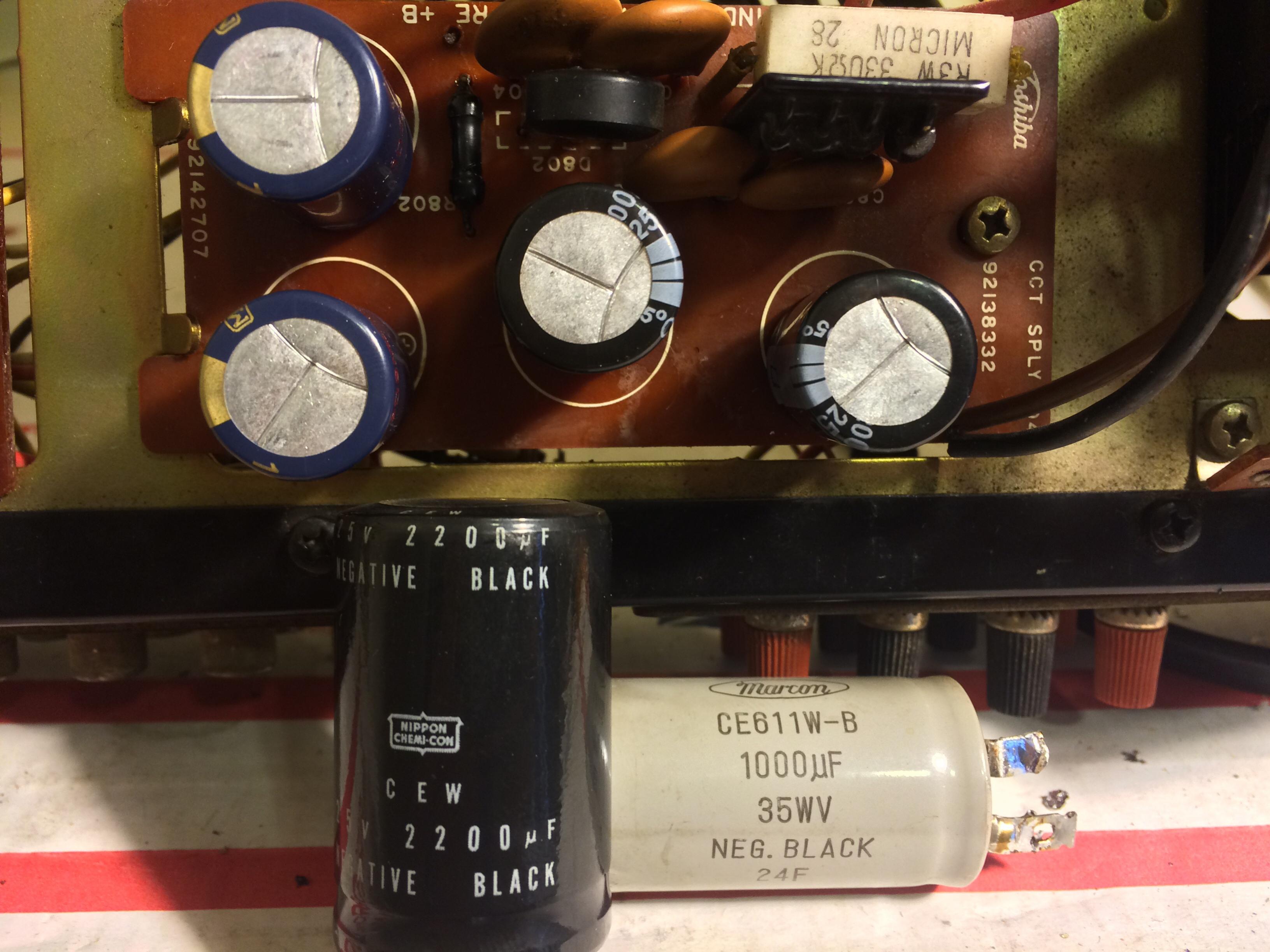

Ripple current rating is (one) of the important factors when choosing replacement caps for a PSU. Modern caps are much smaller than those of yesteryear but it pays to be sure.

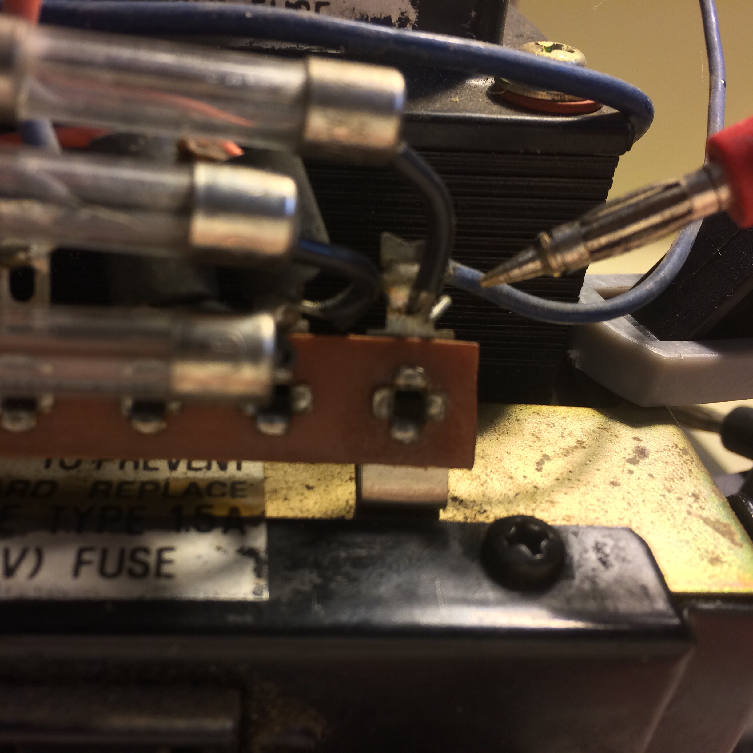

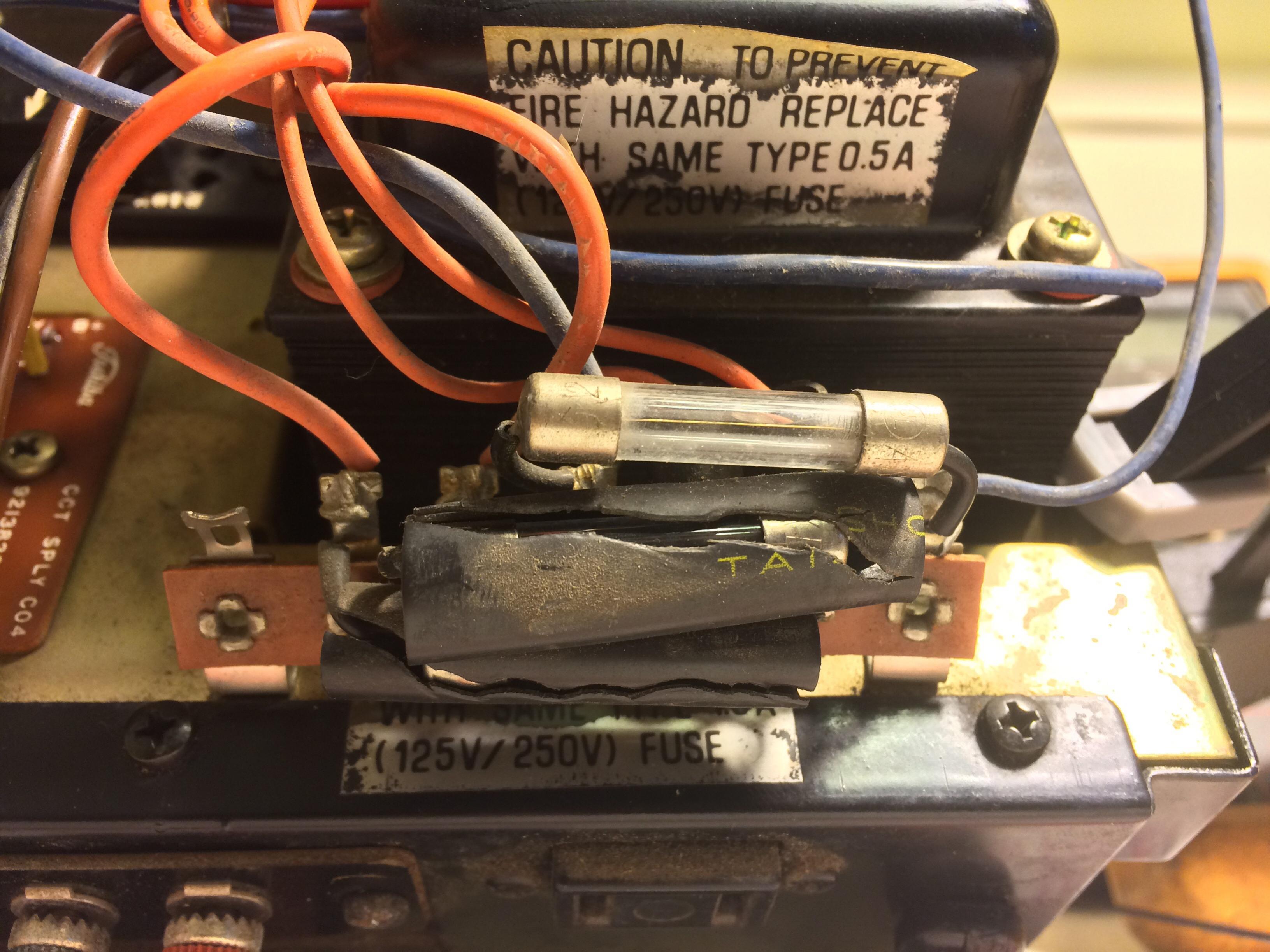

A soldered fuse is infinitely preferable to a holder... if you worked in a service dept you would be amazed at the number of faults/intermittent faults directly attributable to holders that had weakened and were causing an intermittent or high resistance connection.
Ok so I'll get new fuses and probably run new wire to the solder tabs. As far as ripple current, I can tell you exactly what the new ones are but have no clue what the old ones were. Every cap I used was nichicon low esr type
If that stereo is less than 100 watts, I doubt the designer even looked at the ripple current ratings on the caps. Because in practice at normal listening levels it just isn't that high. And the new caps are likley better anyway.
