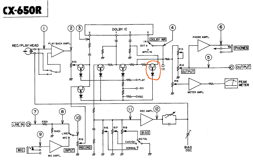

They would normally work in playback mode. Do they?
If dead both ways: the LED "meter" circuit is normally on a separate power node than the audio. Trace wires from power board to meter board.
Can't find the schematic. Let's look at another deck- they are all more alike than different. We see that on this one (and most that I have seen) the meter just echoes the Line Out jack. So does that work?
This one has a chain of JFETs to switch the in/out of the Dolby chip between Play and Record. One of those may have quit.
I hope someone with specific interest jumps in.
Yes, it could be as simple as that.
