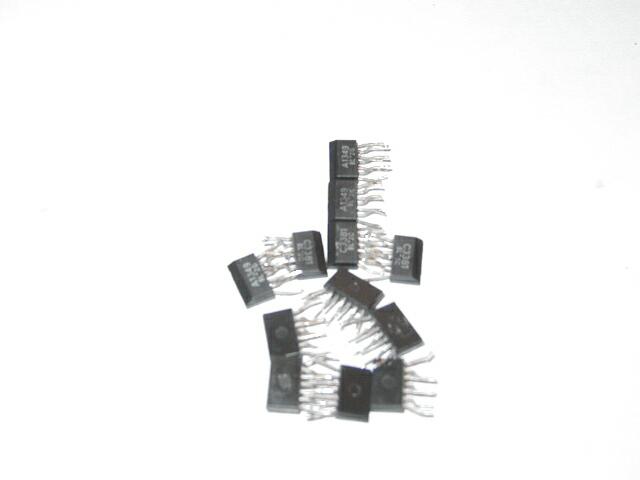

Dual transistors
All the SA1349/SC3381 I have on hand. I am hoping to put my finger on some more.

Ooopsss!!!
I did not check whats was posted before replying to the "New Law" thread... Sorry!!
For the Spice model..
I have not been able to find any other on Toshiba 🙁 than the one Harry shows.
Toshiba does not supply many on their homepage. Sadly.
