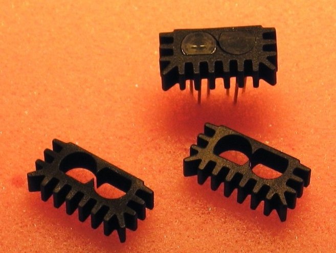

Firstly I want to draw attention to all with heatsinks.
The photo we posted in the other thread somehow got mirrored. Peter Daniel has potted it well.
I attach the correct orientation here.
As to gluing :
How to describe a simple procedure over the internet so that you all understand ??
Let's define orientation first.
Top is as it is upper side in the photo. Bottom is where the legs of the JFETs come out.
Assuming you use arctic silver, or any metal filled epoxy with small particle size (<20µm).
Mix small quantities of the adhesive with bamboo or wooden toothpicks.
Then smear the entire inner wall of the heatsink, and the outer surface of the transistors with a thin layer of glue.
Insert the transistor into the hole. You will probably squeeze out quite a bit of the glue, but it is unavoidable.
Whip off all the excess glue on the top surface with a cotton bud. There is no electrical connections here, so a bit of excess glue would do no harm.
Now place the heatsink with JFETs upside down on a piece of waxed (baking) paper, with the legs pointing to the roof.
Carefully wipe off excess glue on the "leg-side" face of the JFETs, making sure that no glue remains between the legs.
I use a pointed SMD tweezer to hold a very small cotton ball dipped in a bit of acetone for the purpose.
You can leave it to cure in this position.
If there is still excess glue left after curing, remove them with a scalpel.
We apply vacuum to help remove any air trapped and the glue to penetrate.
But this is way too complicated and bring marginal improvements.
Try to practice with toothpaste first. You can still wash them out later.
If you have glued incorrectly, and need correction, no panick.
Just dip the whole thing in boiling water.
The epoxy will soften sufficiently that you can push the JFETs out with a tweezer.
Make sure you clear off ALL old glue before regluing.
Hope it helps.
