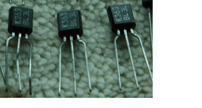

All,
Now I can provide matched quad K170BL/J74BL (K170 x 2 and J74 x 2 pcs) at $5 each. They can be used to replace one K389 and J109. I sort the jfets in 0.2mA each group. Shipping is $3.
