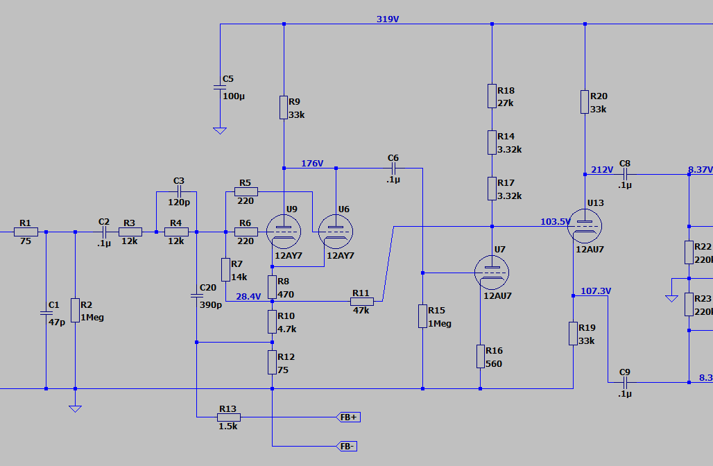

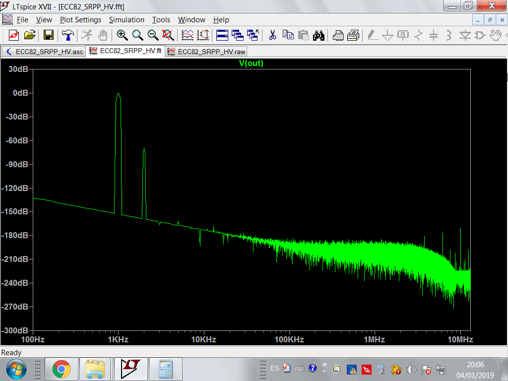

Yes it was classic SRPP, very similar to what you presented, 300V regulated B+ and 1K (820 also) cathode resistors.

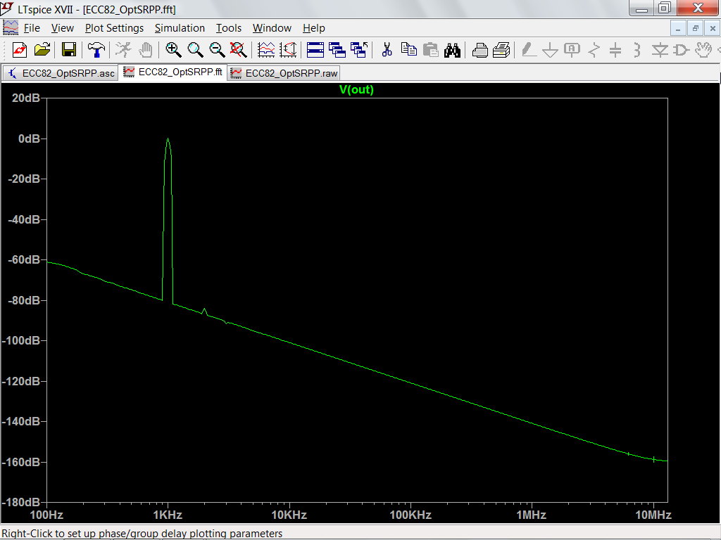

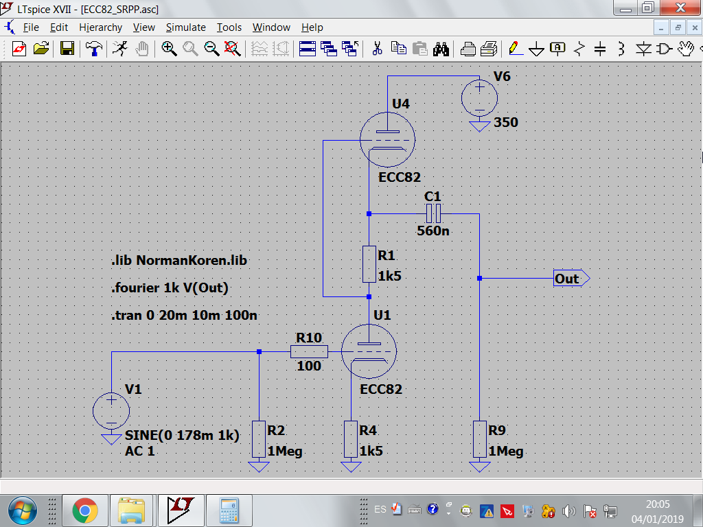

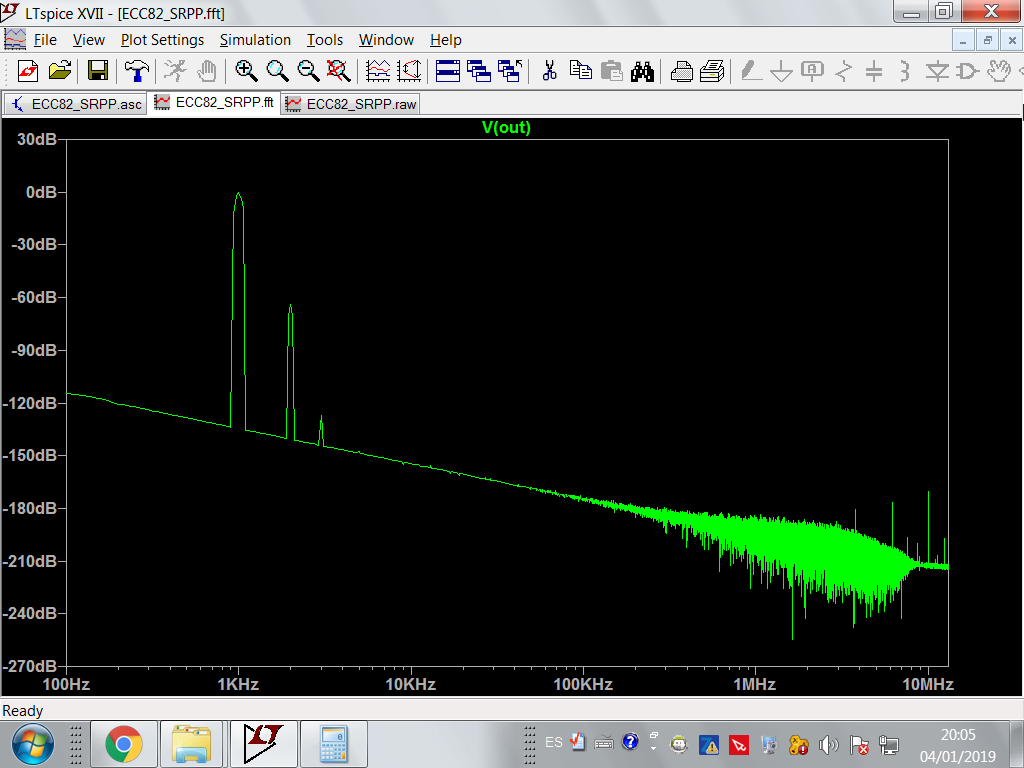

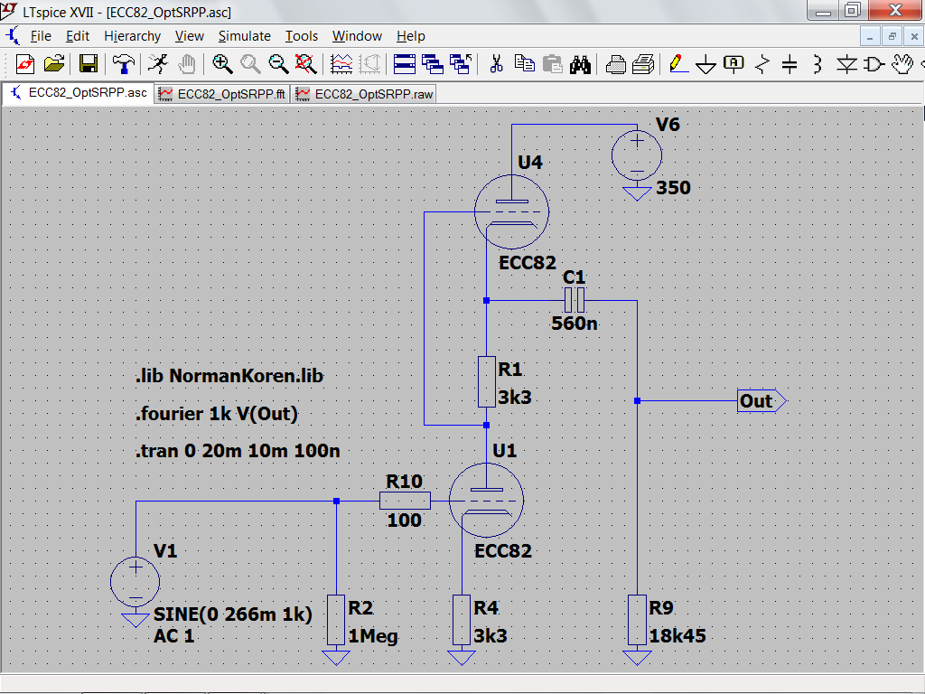

The interesting thing about the SRPP is there is a definite null in THD if you vary the load resistance. The amps these drove had 68K input impedance. No longer remember what the optimum value was, and pretty sure it varied a bit from tube to tube!

In most cases the SRPP optimum load resistance is significantly smaller than the SRPP output impedance, so you get lower distortion at the expense of lower gain. OK if you know what the load impedance will be and it is in the relevant range. In most audio circuits it isn't so the SRPP gives no real advantage. In most cases a mu-follower will be better.
