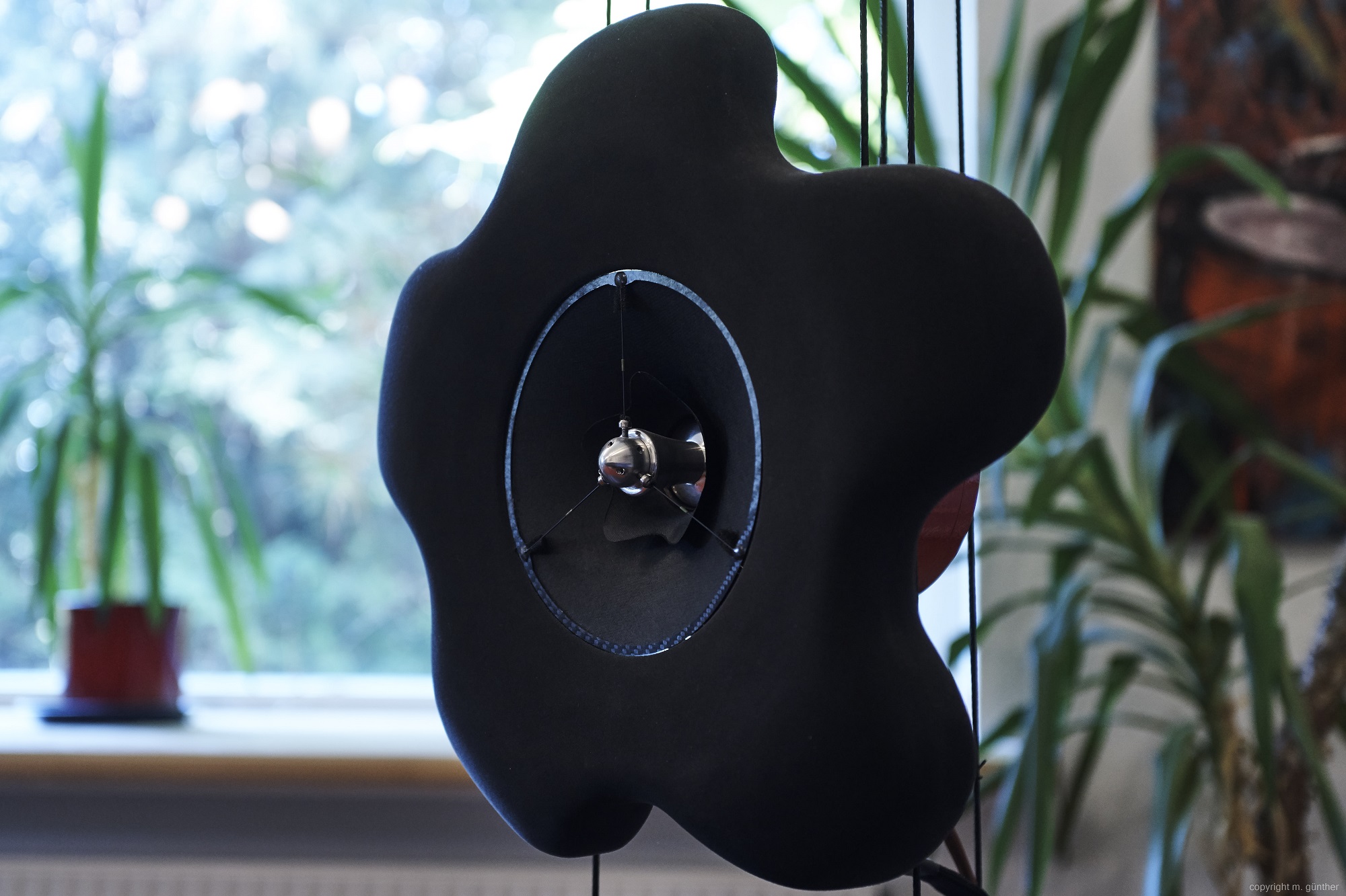

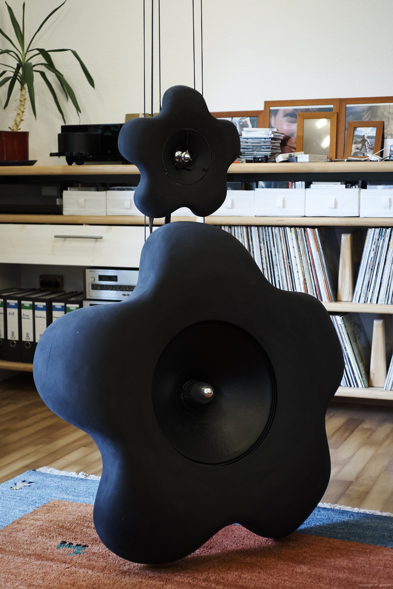

Hi James,
The baffles have been built from EVA foam with a density of 100kg/m³, from 4 cm sheets glued to a stack of 16cm (for the bass baffle) with black epoxy. The petal form has been routed in 1 mm increments and then has been sanded to a smooth surface, the baffles have a very luxurious appearance in nature, like being made from a block of suede.
The bass driver is an 18" AE Dipole 18, the bass baffle is 93 cm in diameter.

Hi James,
The density of the material used was chosen due to the fact that the baffles should fulfil a mechanical job as well, separating front from back waves. Too "sloppy" would have probably not been of any good... and a certain rigidity has helped insofar that I was able to route and sand the complex shape.
With the flowers, I didn´t really mount the drivers onto them, instead I mounted the baffles onto the free-swinging drivers by means of a rear ring of the same material which clamps the whole thing onto the drivers frame. The baffle and the ring have wooden inserts to provide rigidity when the clamping force is applied by a set of screws, but contact with the frames is only by 2,5mm sorbothane inserts.
