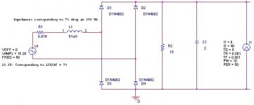

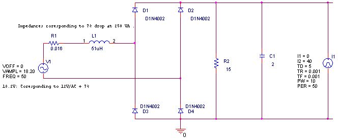

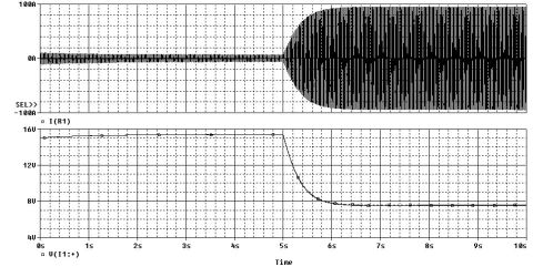

I did some simple simulation and came to the conclusion that I would need a 12V transformer, not 9V.
First the schematic of the simulation.

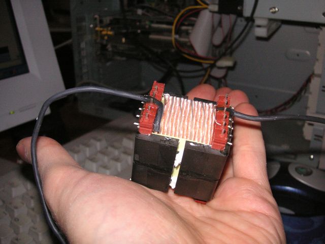

Eva said:
Why are we not dead? We are still alive because creepage requirements are outrageous. Magnet wire enamel has usually over 3KV dielectric strenght (more like 5 or 7KV) and mylar tape also whitstands more than 3KV per layer. Furthermore, in order to start an arc between two needle shaped electrodes placed 5mm apart, more than 5KV are required, and this is the worst case, since 50KV or so would be required in order to start an arc between insulated round electrodes placed 5mm apart (like magnet wires).
I guess 15kV would do the job for two round standard enamelled wires with 5mm distance.
Eva said:
Chocoholic:
Now try to figure out how much voltage is required to get an arc between two insulated magnet wires placed 10mm apart 😀
And even though, I'm sticking to 5mm creepage, and this already makes my transformers far safer than most ones everybody is using for audio. Then again, does tube gear dealing with 480V use 10mm creepage? No, it doesn't, and their chasis isn't even earthed!

Your Nokia phone charger, the first picture shows a "thick" yellowish wire, to me it looks like a "tripple insulated wire" which, if I got it right, use to be approved in acordance with the most common electrical safety standards, these type of wires is authorized as "Reinforced Insulation" and can be used directly on primary windings without any isolation.
For instance wire from Furukawa, (for a certain diameter and type as I have noticed), the dielectrical strength is upto around 25 kV.

Indeed, arcing in television sets is a problem in dusty conditions where humidity is high.
Eva, yeap, in here at finland we have those chinese pingpong atx power supplies also at market, TUKES(local authors) is withdrawing couple of models every year from market. Deer, IT-snälzth(IT-shcaisse) and Q-tec are worst **** of all time. I prefer brand names, namely Fortron-source. And yes, i have also opened my power supply, it is just fine as far as i can tell without hacksawing trafo to pieces. 😀
Eva, I guess that your 5mm creepage is enough if your equipment is grounded, even according to some safety regulations. Double/reinforced insulation is much more demanding, as we saw from chokoholic.
Kenshin, I can confirm what others have said about those small smps units, triple insulated "abnormal looking" wire is used in them.
In my opinion, double insulation is a total overkill for high power applications. I think that power amplifiers are the piece in the audio chain that should be earthed.
On the other hand, double insulation (with as much creepages as desired) is very easy to implement in low power audio PSUs where size is not strongly limited. Any potential ground loop issue is easily solved by using differential inputs or outputs (or both) and star grounding (to force loop currents to follow a known path).
Also, I'm thinking about building my own insulation tester. I have some medium-size and big 50Hz iron-lamination cores that I can dismantle and rewind as 100:1, 200:1 or 500:1 step-up transformers (this time with gentle creepages and maybe some epoxy).
I could bet that those chinese transformers with no creepage doesn't break down until well above 5KV (there's no better way to know than testing).

Also several high quality isolation tapes. But bobbins often are poor...
The stepped gap choke is a doubled EVD 36.
43 turns of 150x0.1 silk covered HF litz,
wound in three layers with interlayer isolation.
At low currents L=1.1mH.
At levels above 0.7A it changes to 330uH and remains stable
up to all area saturation at around 17A.
If heated to 100°C, this saturation may happen around 12A, which is
my worst case requirement at 120V.
...hm, somehow I am curious...

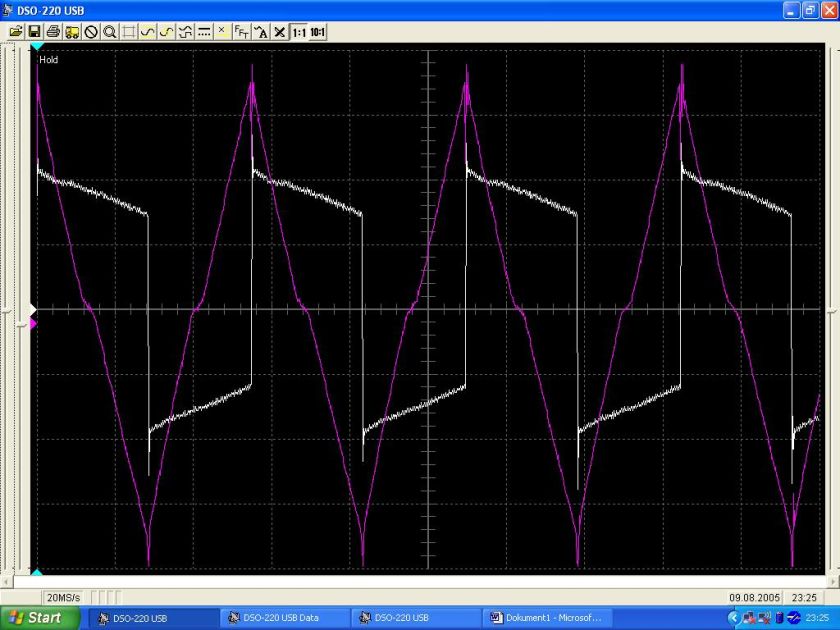

Sorry, I should mention:
White trace is the voltage across the choke: 100V/div
Coloured trace is the current through the choke: 5A/div
