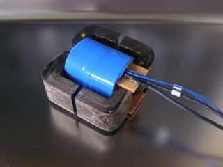

Hi Guys and Ladies!
Somehow I am not getting lucky with my PSU concept for my subs.
I planned to design a SMPS which would allow universal AC input and additional 12V car battery supply.
The part which makes me thinking is the line SMPS.
First I planned a PFC-Boost + Halfbridge Forward Converter.
With my lower power requirements (600W max. / 150W average), I started thinking about an Flyback, which would allow a simple single stage design.
BUT :
No matter which topology I choose there are several drawbacks already in theory.
-The safety standard EN 60065 (Table 11) would require enormous creepage distances for reinforced isolation. Safety class II is a must for me as I do not want to have a mandatory earth connection.
In case of a flyback I would end up in a minimum creepage of
12.6mm and in case of PFC-Boost + Halfbridge around 10mm.
...values which make a suitful small sized transformer difficult...
The leakage inductance for the flyback is critical anyway.
BTW: I found some cut core material, which can handle high
flux and HF operation (pic...).
-EMI filtering:
a) I would need massive X-Filtering.
b) To avoid HF-noise on audio signal ground, there would probably the need of screening layers in the trafo in order to catch the capacitive leaking currents from the fast switched high voltages.
Size and weight of all this will be at least the same like a 250VA torroid. :bawling:
I will need large caps ( 2F ) for the 12V battery supply anyway.
Coming from this it looks quite reasonable to use a simple 120V/240V ==> 10V torroid and a rectifyer instead of all the trouble above.
2F caps will lead to an acceptable low rippled 12V supply and
a traditional regulated push pull SMPS should then give stable
+/- 50V rails for the amp itself (or any other desired voltage).
So in my application the only remaining advantage of the
line-SMPS seems to be the possibility to draw sinusodial currents from the mains.... hm, who cares at such low power !!
What do you think?

Don't let outrageous safety regulations pi$$ you off. They were written just for that purpose, in order to help big companies to monopolize SMPS development (and EMC actually states for 'Eliminate Minor Competitors').
Have you ever seen a 50Hz standard toroid with three layers of mylar tape between primary and secondary windings? or even with a faraday shield? No! Most of them use a single layer of a low quality non-adhesive tape with some overlapping, that melts at approx 90ºC. Furthermore, they suffer from high primary to secondary leakage currents due to thin insulation and huge capacitance, so earthing is always required. They don't met any leakage specification, most brand-new big toroids will shock you if you touch any wire from the 'isolated' secondary windings with your feet wet on the floor.
Have you ever seen a 50Hz 'EI' transformer witn 16mm or 10mm primary to secondary creepages? No! They use no creepages at all!
Everybody is using these 50Hz transformers without trouble and nobody is messing with their manufacturers.
I hope you got what I'm trying to explain.
PD: I use just 5mm creepages (2.5mm per layer) and some plastic tubing for my SMPS transformers, and this already makes them *far safer* than most 50Hz ones. Earthing is a must anyway.

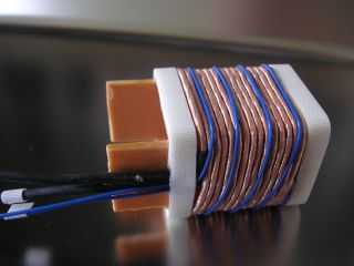

Attached a picture of my first winding trial for the flyback solution. 6mm margin tape on each side ==> with the additional
thickness of the isolation between prim/sec, I would get around
13mm creepage... The wires are isolated with a shrinking sleeve, which gives 0.6mm isolating wall thickness.
This design did not have interleafed prim/sec and the leakage
inductance was around 7µH. Not funny if you go for a flyback with
20A peak in case of 120V/AC.....
Even with interleafed construction, I guess still half of it will remain.
And I would have to consider the inductance of the rectifier loop on the secondary. Let's guess around 10nH, resulting on reflected 2µH on the primary side (Trafo: 15 turns : 1 turn).

...uhps, I forgot to say, that the pic only shows the primary and the
zero-detection-winding.
Then a triple isolation followed, which can be seen in the pic of my first post. And the secondary for measuring the leakage inductance was a
copper foil, full winding width and 0.3mm thickness.

EVA: I think you should be very careful to encourage people to ignore safety regulations. These voltages can be dangerous, so i think Chokoholic's respect for EN60022 (safety for IT equipment) is very well considered.
Chocoholic: Have you thought about a resonance mode push pull converter? IME they are suitable for high power jobs. But forget the 12 V input to the same converter, you will have too much copper on your main transformer. Make 2 separate converters and join them on the secondary side.

I already had a look at the assortment from Buerklin,
they offer potted, magnetic shielded and class II suitable torroids
for around EUR 100,- for 250VA or 300VA.
But this does not look for me like a bargain and also their primary
is a single winding, suitable for 240V only....
Is there a reason why you consider EN 60022? During my search I came to the conclusion that EN60065 would be the perfect match, its title is definitely adressing to Audio-, Video- and similar electronic gear.
Don't worry, not even EVA could convince me to ignore the safety standards. She's got the typical southern relaxed position in this regard, and please note: She also implements 5mm creepage her designs.
I am more the accurate German. I don't mind to work with non isolated kVs. But after closing the casing, it must be baby save.
..."...forget the 12V input..."
Uhps, you calculated that I would get current peaks of 300A on my
primary right?
I agree, that 500W PFC-flyback from 120V....274V/AC to 12V/DC is
is crazy. And honestly speaking in the moment this fact would be the only reason for me to try.
With respect to size, weight etc., my clear brain would indicate a
50Hz transformer as the heavy Electrolytic caps for 12V are necessary anyway....

Instead of margin tape there a special creepage spacers, which can be clipped on the bobbin.
If you are able to wind without margin tape or spacers, you ensure
that the windings will stay in place by a simple impregnation with varnish. Varnish also helps to reduce noise and improves humidity properties.
These are some evidences showing that safety standards are usually ignored in the equipment we routinely use in real life.
Most AT and ATX PC power supplies doesn't include any creepages in their transformers, altough their labels are loaded of approval symbols:
