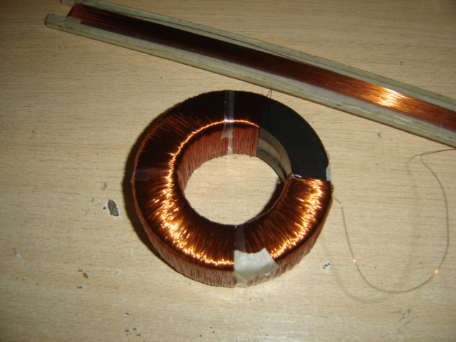

Sorry, I didn't know that there is available gaped toroid cores. certainly in my abominable country, neither a common core is available. I made my own toroids winding them at hand, but unwinding commercial units.
