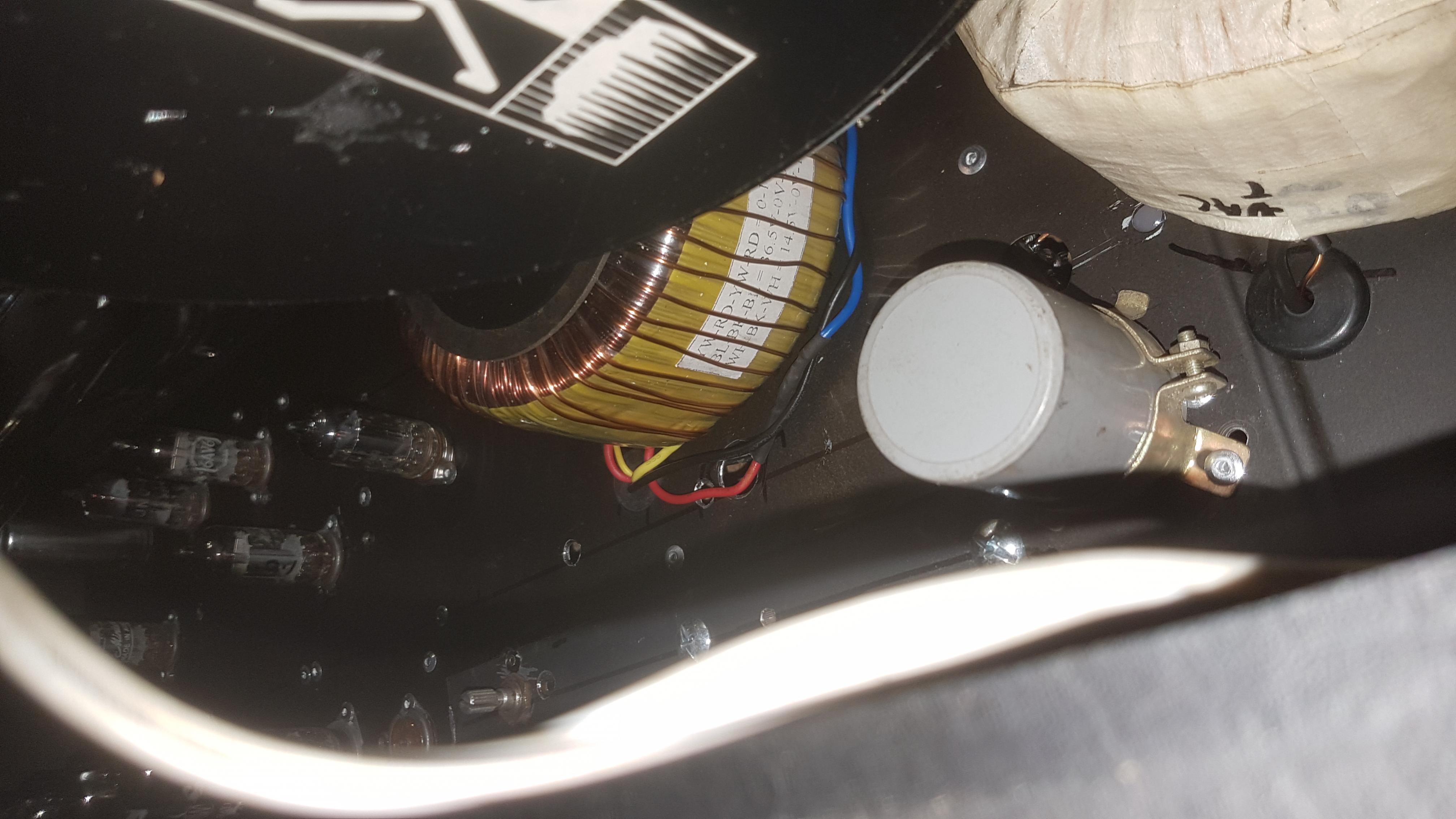

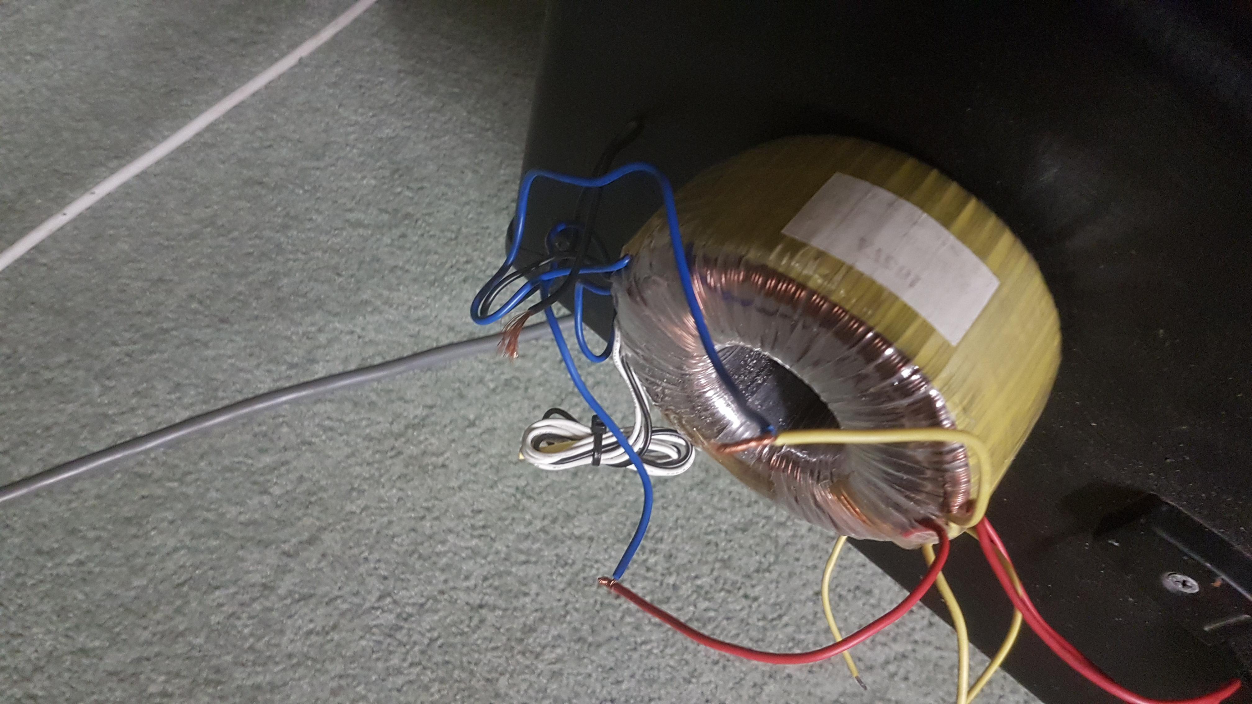

hi , this is all about the use of toroid transformers and changing them to suit your needs.... which is surprisingly simple to do and with good results ....
I went this way because i found more critics condemning them because they are not" HIFI" but neither are guitar amps...
No i'm not someone who thought i was the first to come up with this idea nor am i trying to be some sort of hero or whatever....when i looked for practical information on this issue i found very little....hands on stuff that is ....
So i asked myself ....how bad can they be ? ....and how hard is it to do ?
i did find some notes about how some folk used them in low power situations or how some used them in hifi situations and wasnt pleased with the outcome...and there are some hi end makers utilising the toroid trannys...made to their spec of course...
Well i wanted to make another guitar amp and thought if i dont like the converted toroids i will swap them out ......simple
the amp in the video was bought for $60 ...it was a blown solid state amp .....these make good bases because they are loaded and come with speakers and a chassis ....a great starting point
The tubes used are 6cz5 / 6em7 television valves....and 6av6 as preamp tubes with the addition of a brimar 6br7 on its own channel ....the PI is a 6c4 cathodyne style
A pair of 6cz5 ar good for 21 watts
Thing is you can make your tranny to suit whatever tube you have....
This amp is load , its sweatly clean and filthy dirty ...it ticks all the boxes needed for gigging , of course sound is subjective so some are going to refute what i have done here .......but its simple
Toroids can be utilised in this manor effectively ...and at low cost
this whole thing was about building a cheap affordable tube amplifier utillising parts that may have not been considered in the past, and this was less than $150.00AUD all up
