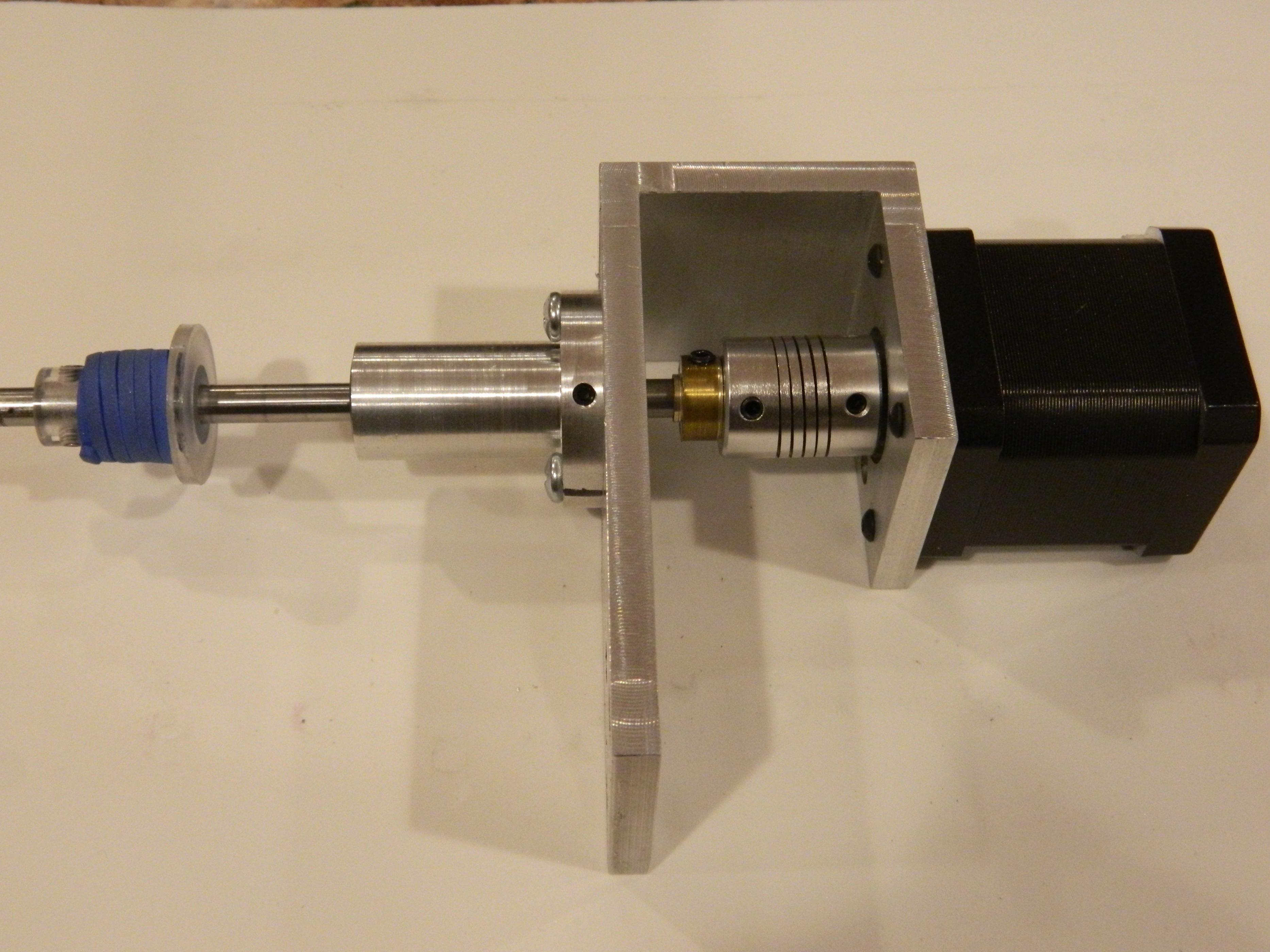

Lost the chain drive, used that u shaped section over, now there is a hardened steel shaft in place of the brass. It still binds a little bit, but really much better than the chain. I re-used an aluminum two bearing mount from an old project
Tomorrow I will order an Oldham coupler from McMaster Carr. Needs a 5mm end and an 8mm. Will end up around 30 bucks. It will be the most expensive part of the build to date.

Here's the newer direct drive for the toroid turning. That aluminum cylindrical part has two sealed bearings, one either end.
the shaft is hardened steel. Needed the cutoff wheel to trim it down to length.
Tomorrow and the weekend, I put it together and work on finishing the rings.

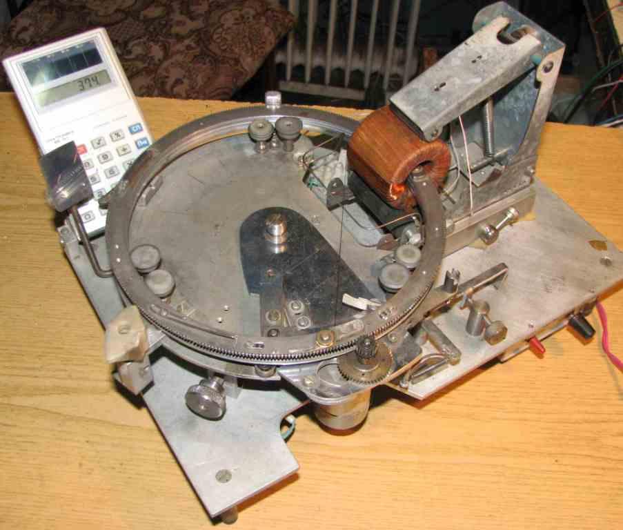

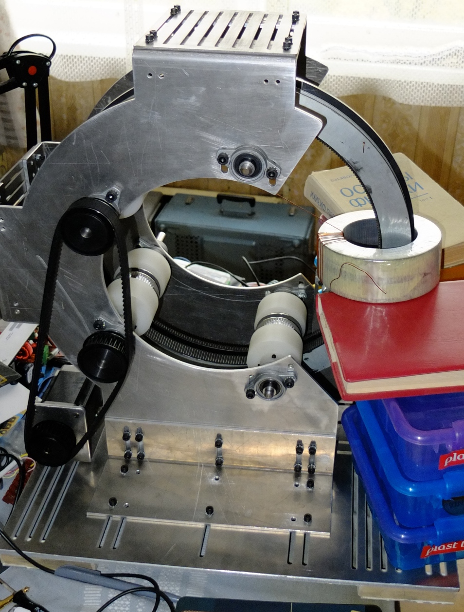

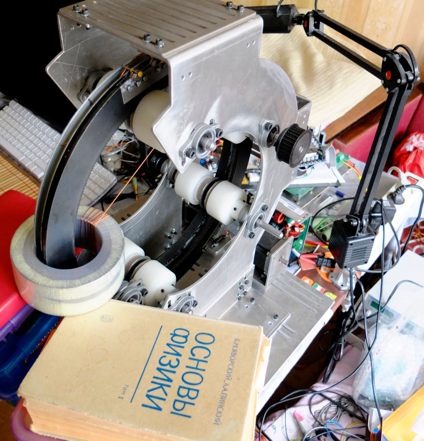

I tried to build toroidal winder back in 2013. It was semi-working prototype without roller calmp table for toroidal core (so I used boxes and books, and rotated core manually to determine if this costruction is workable). The external diameter of wire spool and shuttle is about 355mm (~ 14 inch). I abandoned this project because of the too high cost.
Pictures attached. So you can take some lessons from my achievements and mistakes.

Wow, very nice work. I note you were setting up the second ring to be driven as well.
The vid I saw has only one drive, so I went that route. But man, that was certainly an ambitious project, it looked quite good. I'm glad you kept pictures.

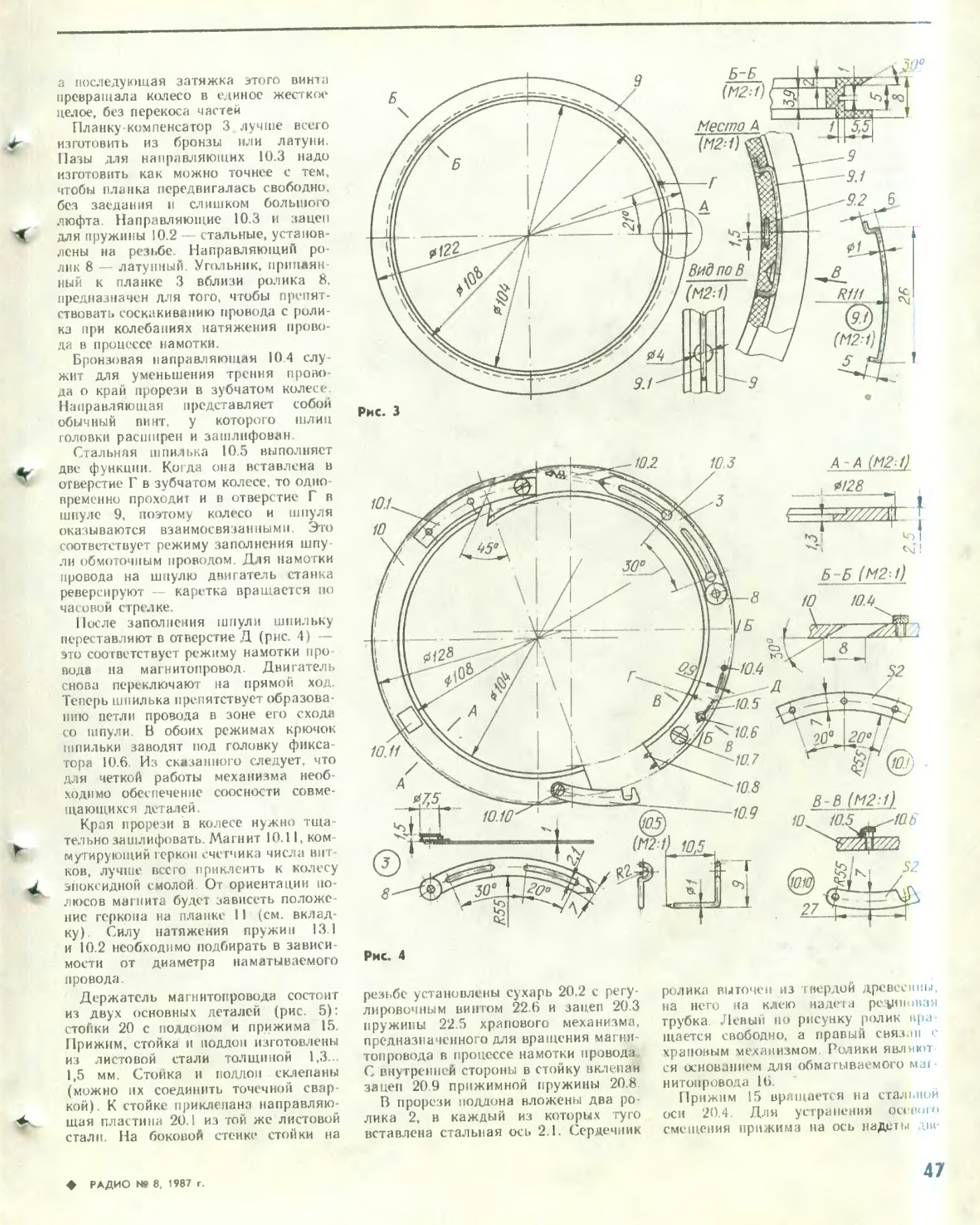

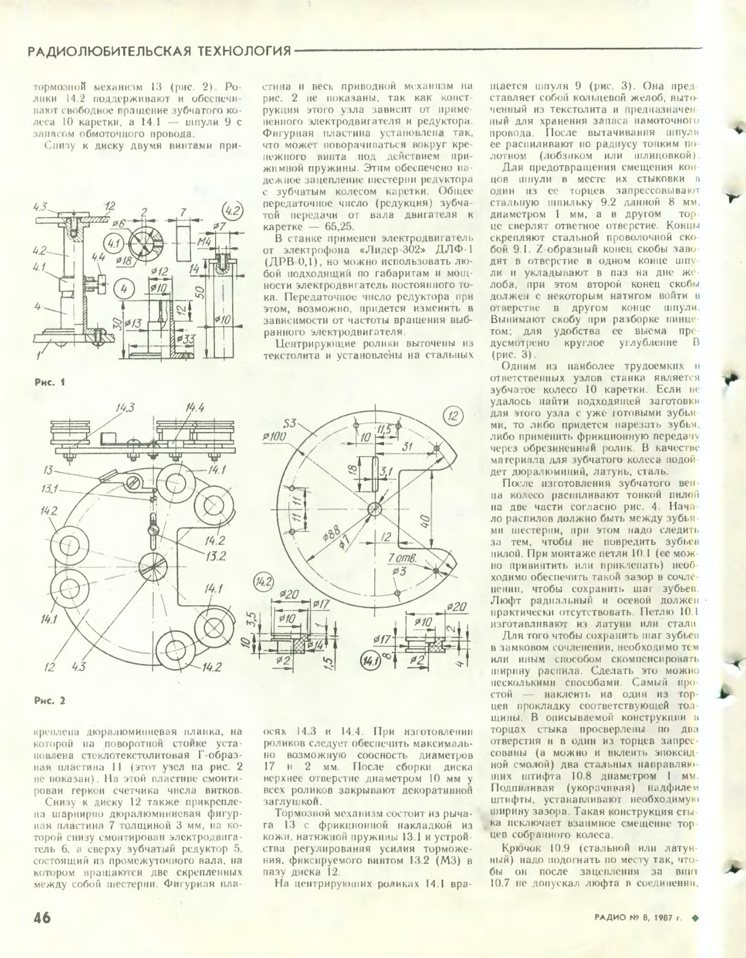

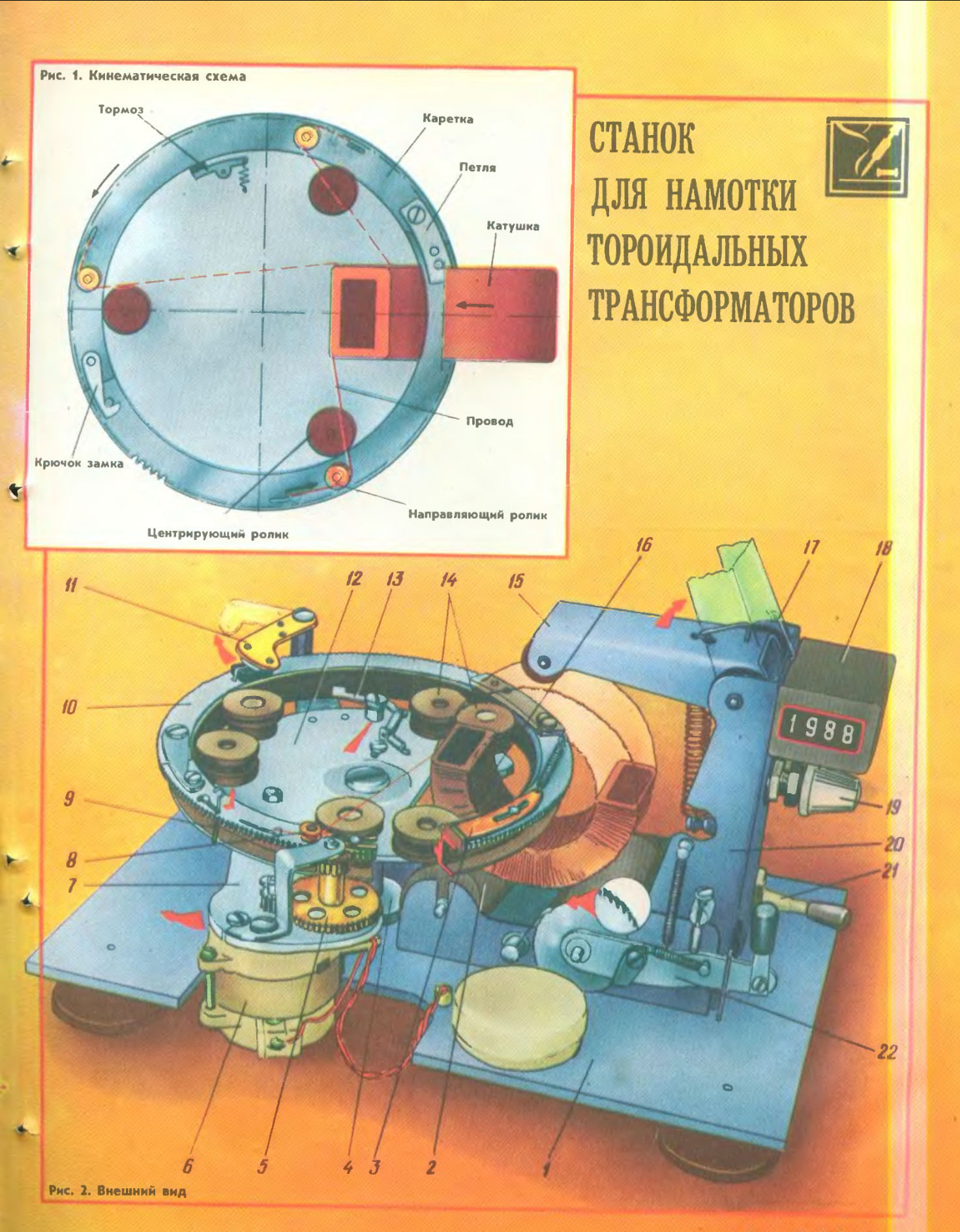

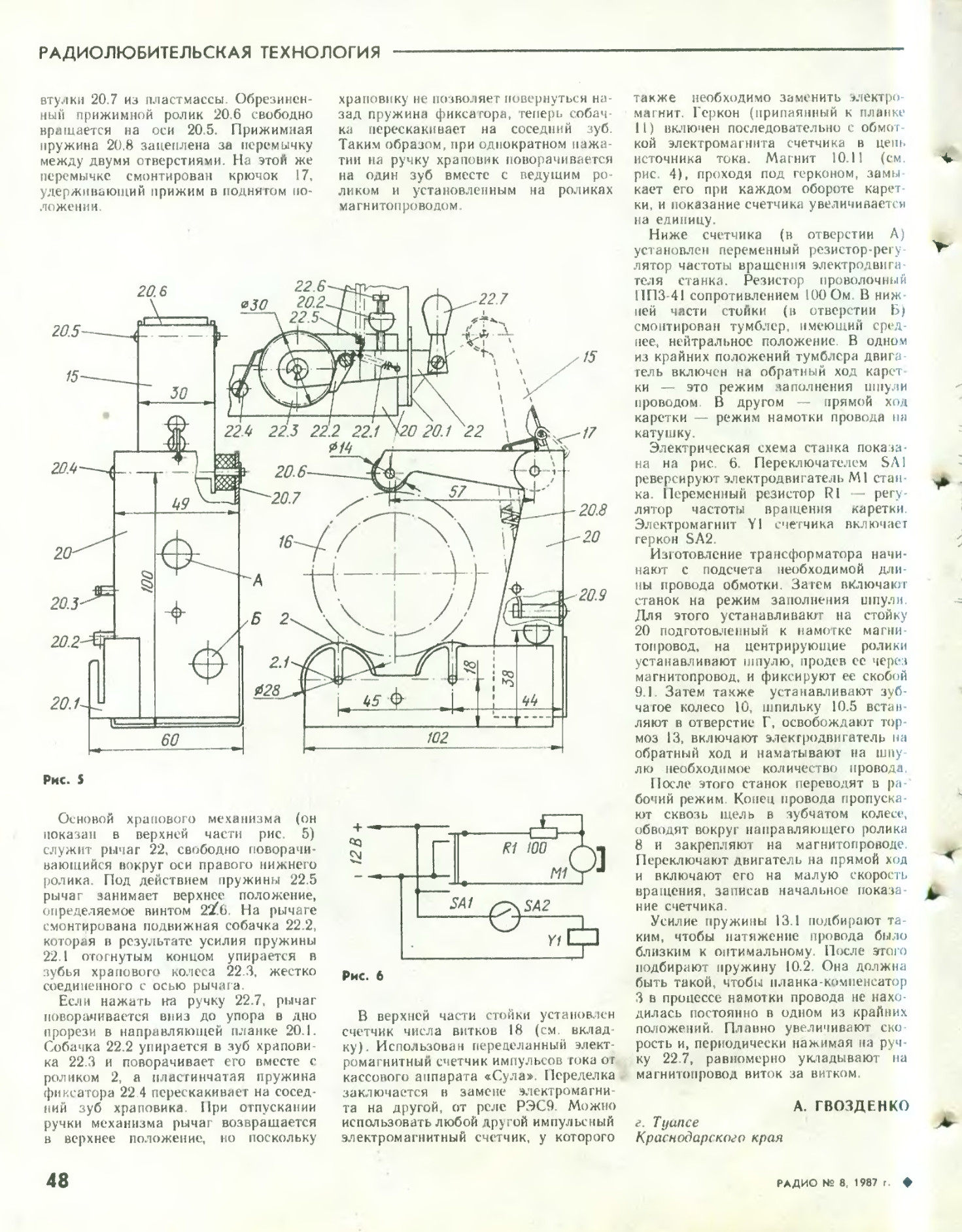

I draw my inspiration from an article published in Russian "Radio" magazine back in 1987. It included complete set of drawing of all parts necessary to build machinery. However, I decided for more classic build with vertical spool bobbin and shuttle.

The first pic, wow, it looks like it's been out in the weather for a few years.
It shows the wire exactly where I was concerned about wire tension. As the pulley moves toward the toroid, it's actually rolling on the wire towards the toroid.. I believe the source spool almost stops, but doesn't have to back up. That's the question for now.

From the magazine, the rings appear to be split in half. Not a bad idea. But since my rollers are OD, I think I have to keep the opening segment under 60 to 90 degrees of the ring circumference. If I build a second one, holding the rings at ID might be the choice.

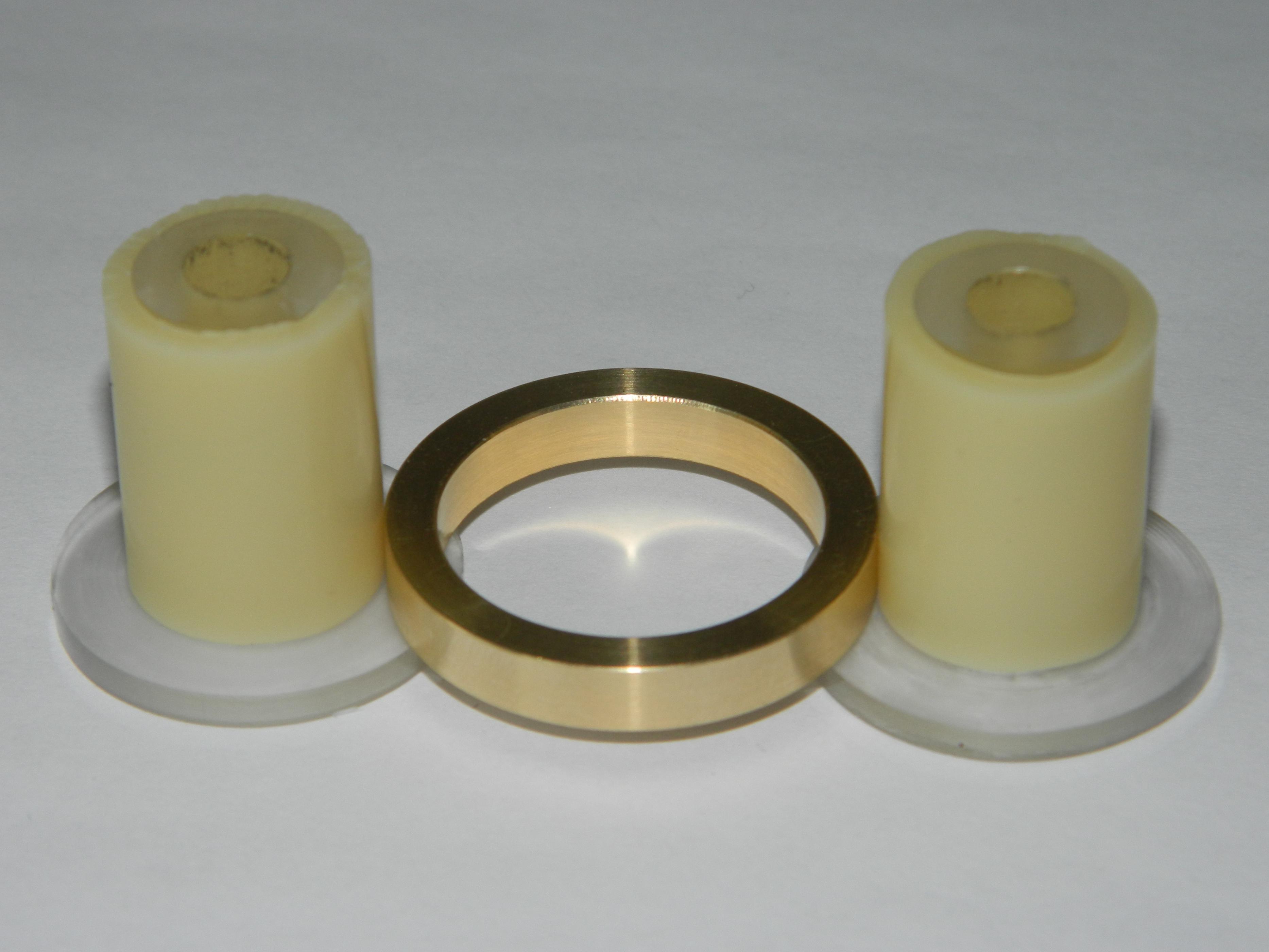

Received the surgical tubing from McMaster-Carr, they are amazing with their next day shipping.
I put the half inch ID tube on two of the toroid support parts. That blue foamy stuff was driving me nuts.
I think this tubing is going to be perfect.
Oh, the brass ring is a size duplicate to the high mu toroid we will be winding. I didn't want to compromise one of the real parts.
