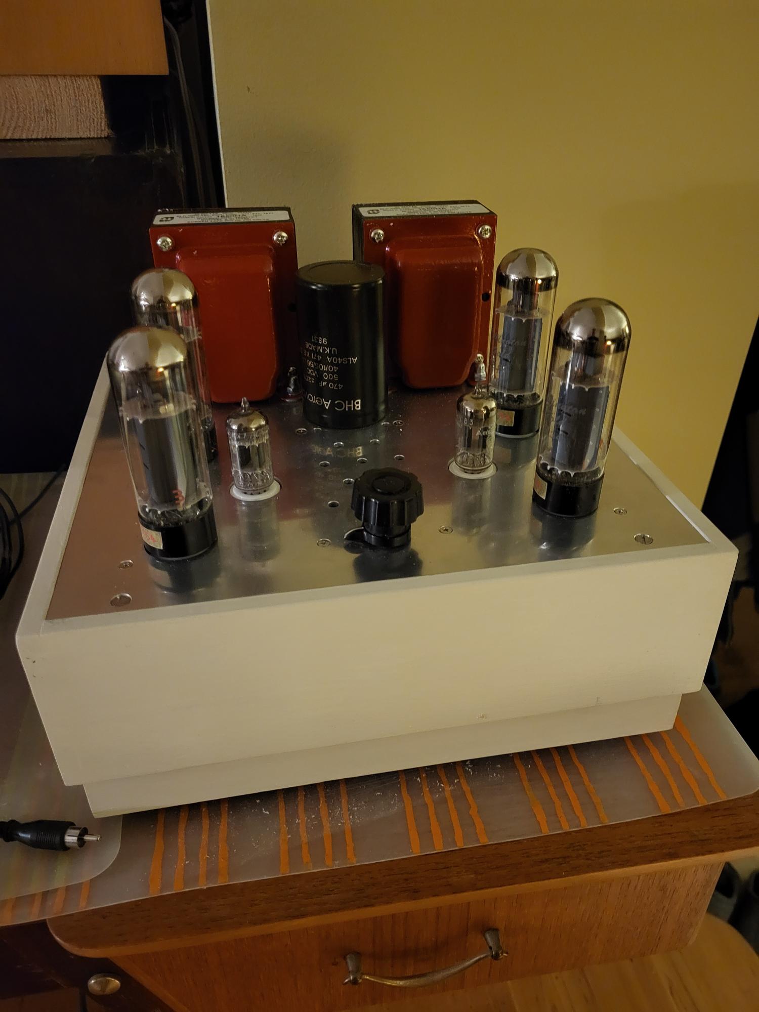

I don't use boards in my builds and I certainly don't piece together pre-made bits into a box full of circuit boards. That's not my style at all and I see zero challenge in it. If I do have to use a board, I design and produce it myself because I don't trust anyone to do anything right anymore.
Here's an example of my workmanship so you can tell that I'm serious...
I DIY because it's the only way to get what I need in life.
First came this mc/mm phono and line preamp, which I've made a bunch of..
Soon ill get started buying stuff for a 8/10 channel PA rig using all tube amplification and a tube mixer...
