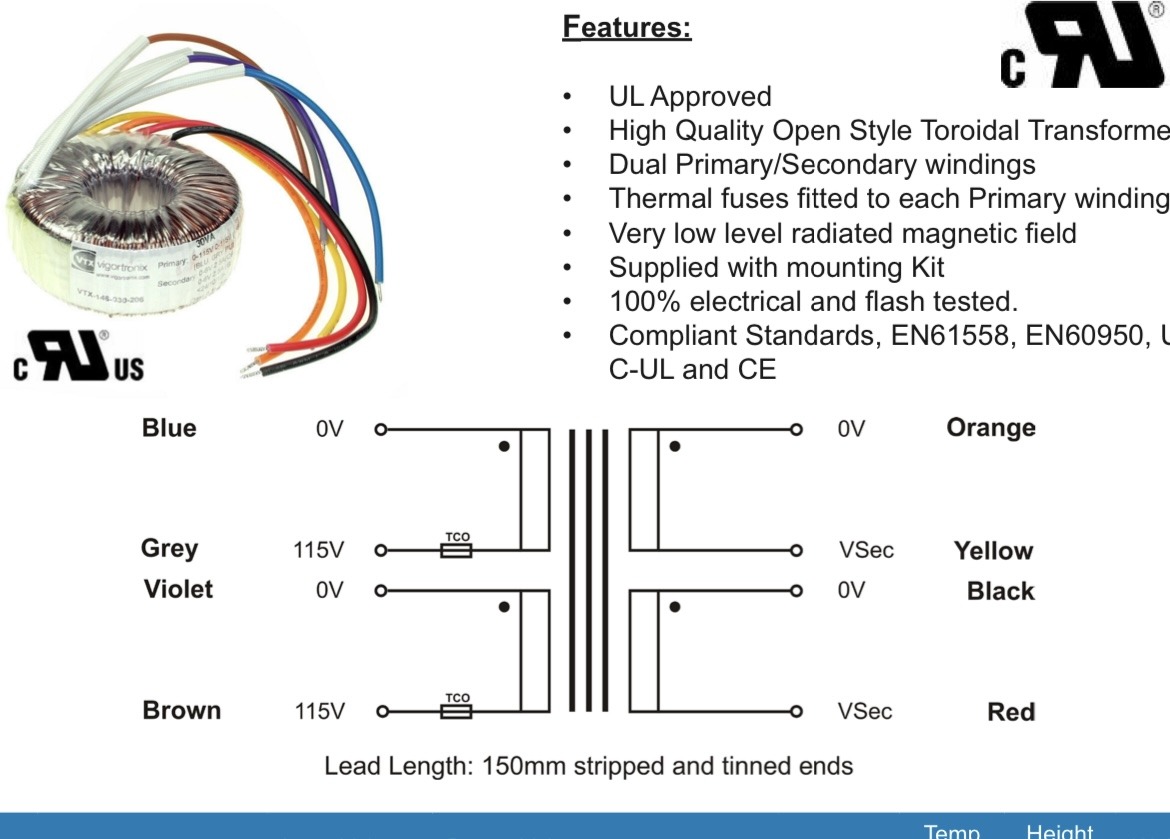

From the pic of the transformer I would have assumed the secondaries 0V would be red and orange and I agree the buck converter looks iffy, how is it connected wrt ground?

And image from transformer data sheet:
I notice that the actual secondaries on the image of the transformer are not the same order as in the diagram, but guessing that’s just the way the diagram is drawn for simplicity.

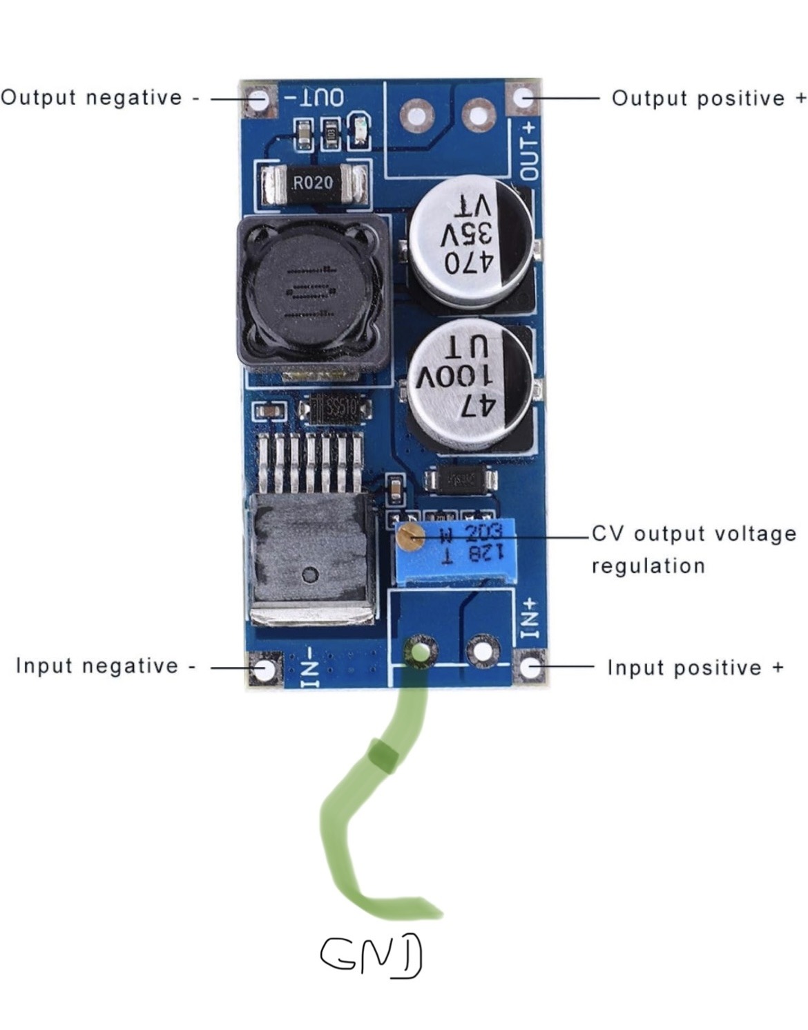

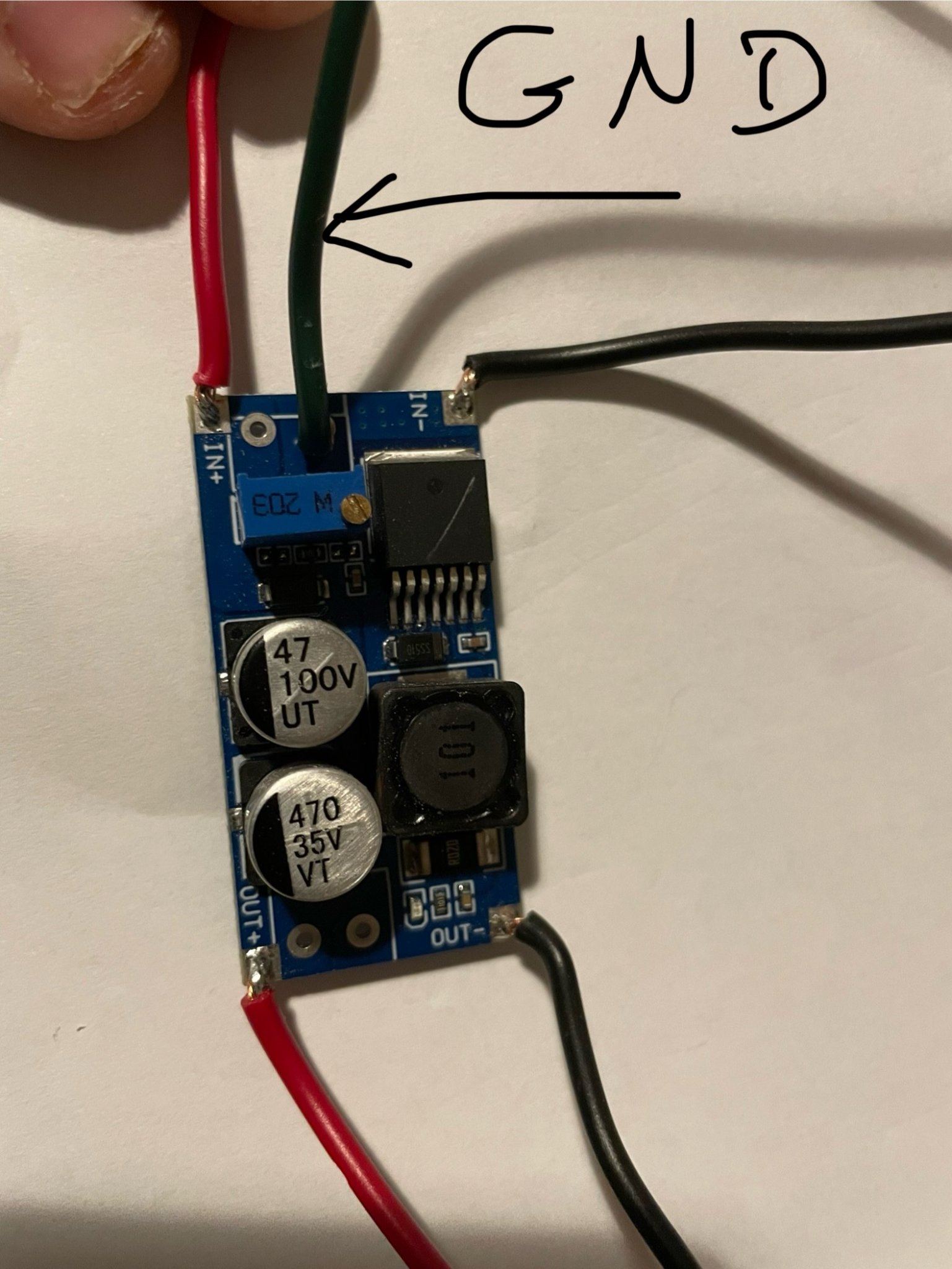

I had connected it to ground from the power supply rail to a point I was advised by a question I posted on Amazon. Shown below…. but now I look at it close up I’m wondering if it’s been attached to the positive supply in…Yes you should absolutely get fuses but they would not blow if you put it together correctly.
That looks like a short between In- and ground. The buck converter does not have a symmetrical input/output.
