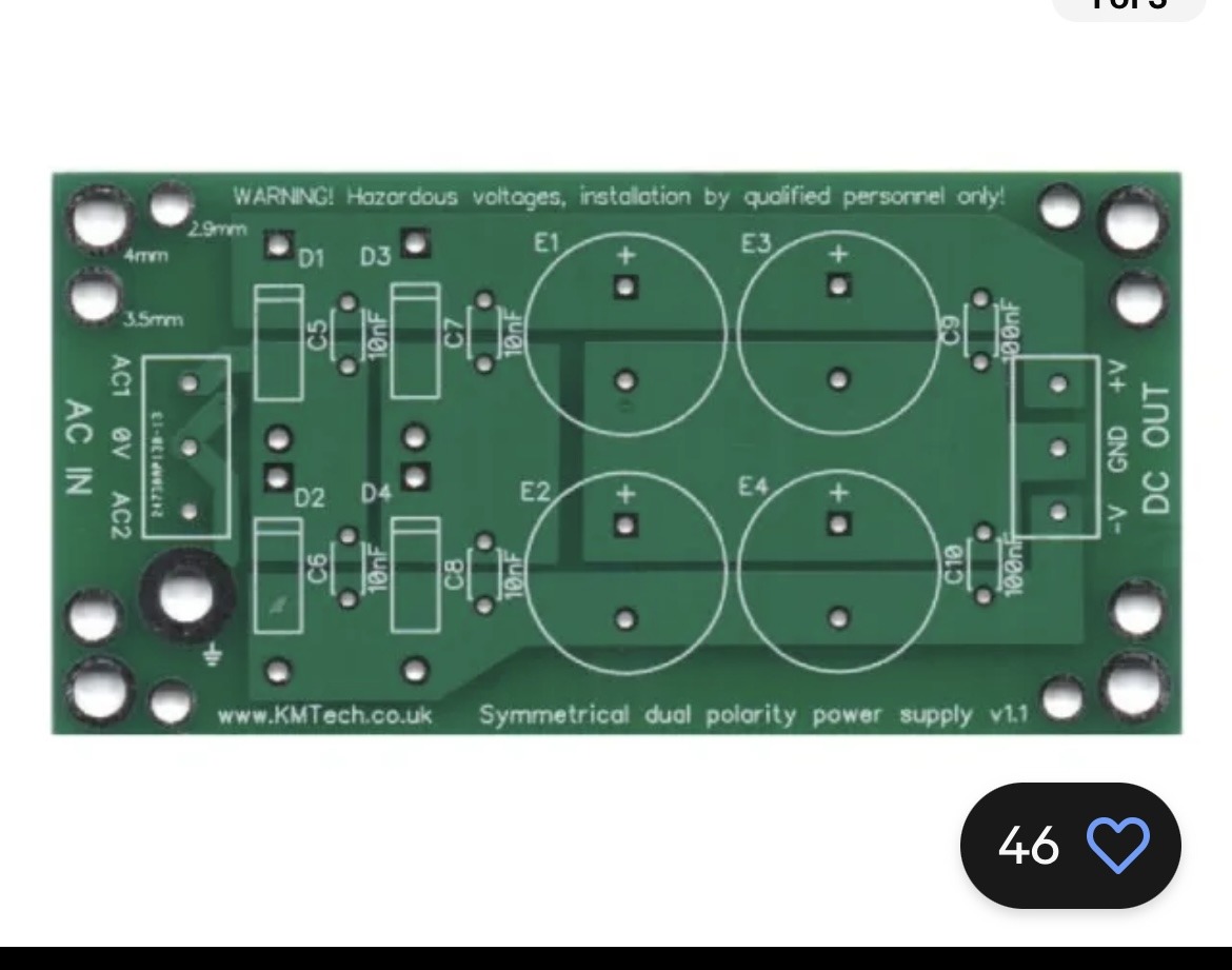

Hi all, new here. I'm trying to build an amp with PCBs purchased to make up the amp and the power supply board. An 80va dual toroidal transformer is recommended.
I've put the circuits together and have now managed to burn 2 toroidals and one other transformer too!

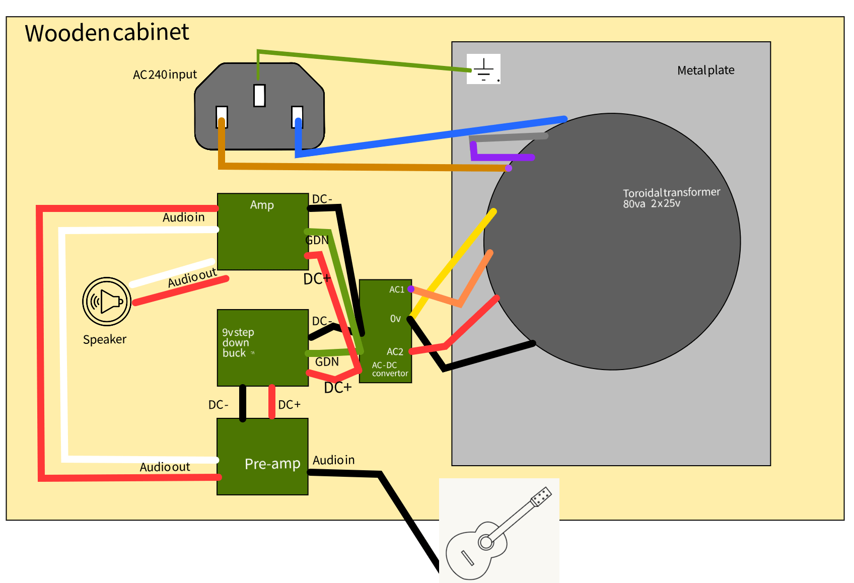

I'm not sure what I'm doing wrong but have posted an image of my setup here (excuse the poor quality!)
The project is a guitar amp in a wooden box. I've inserted a metal plate to have a ground point for incoming 240AC.
The transformer is mounted vertically on the back wall of the amp.
Any advice is greatly received!!

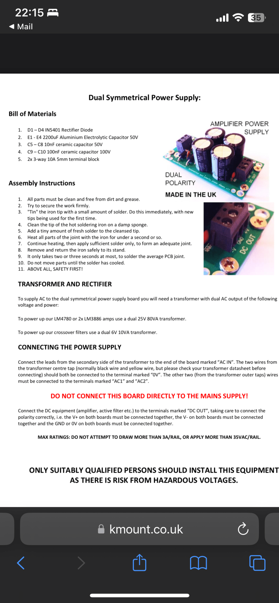

I had fused the grey and violet on primary side of the above toroidal to have the transformer in series. And black and yellow on the secondary side to give the 0v ( as advised by supplier of the amp kit).

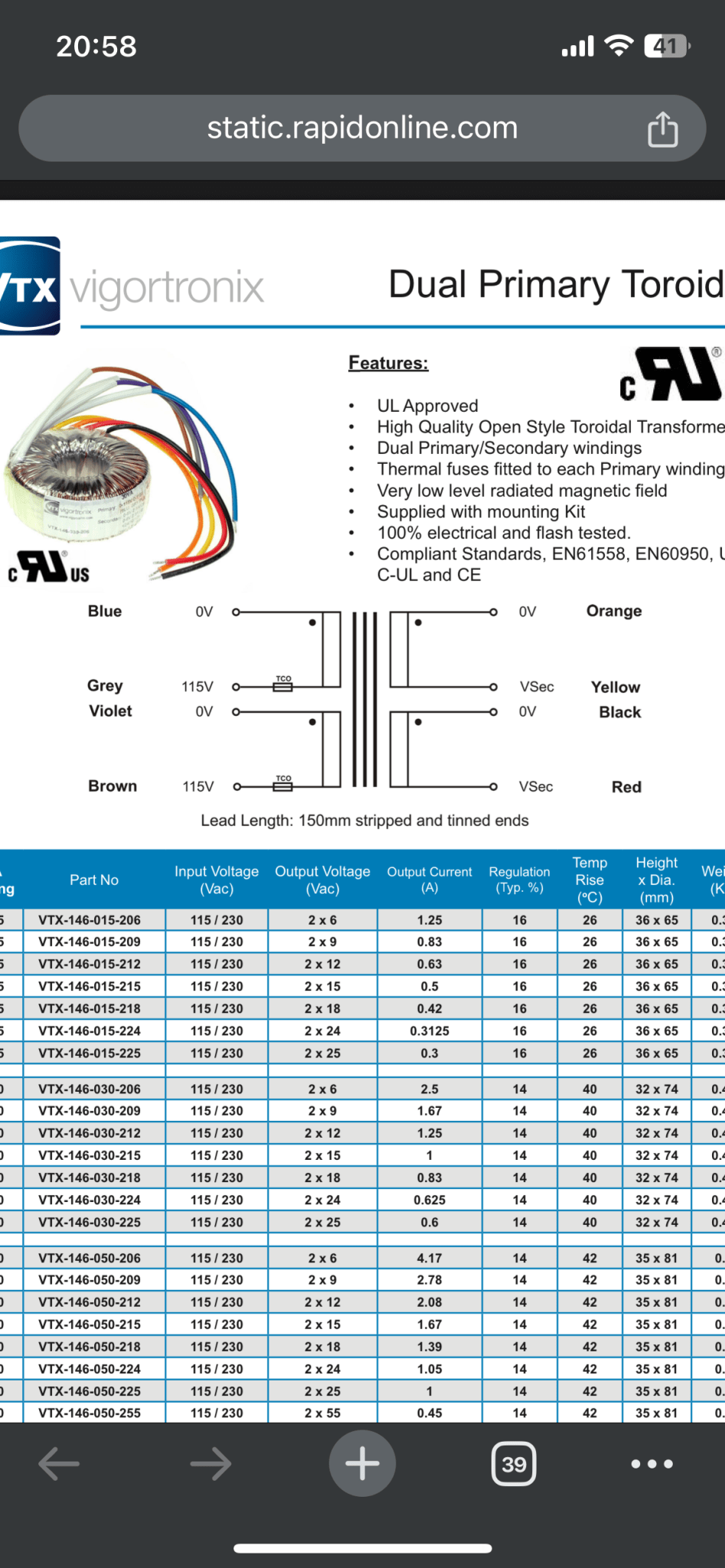

Here’s the data sheet, I haven’t added any fuses on either side of the transformer.
VIGORTRONIX 80 VA Mains Toroidal Transformer 2 x 115 V : 2 x 25 V VTX-146-080-225

Secondary connection may be wrong as in pic. disconnect bridge rect. and measure the sec./output voltages with voltmeter (0-25-25-50).

the metal plate. How is the transformer mounted? Are you magnetically shorting the transformer? Post pictures of actual unit under test please.

And the 9V step down buck - that looks suspicious to me as dual supply buck converters aren't very common and don't normally take a dual supply input...

One usually uses only slow (T) fuses on the primary side of toroidal transformers because of their large inrush current. Probably 400 mA T for 80 VA at 230 V, but it is usually specified by the transformer manufacturer.
6sX7's remark about mounting is a very good one. If the mounting hardware and enclosure somehow form a conducting ring through the hole of the transformer, you have an unintended shorting turn.

Your "9V Step-down buck" converter is suspicious. It could short the -V in to the -V out to the Preamp ground to the power amp ground to the main supply ground. You need more detail about what these blocks are. A "buck converter" does not isolate the inputs from outputs. Does it output one 9V or two, ie +/-9V?

The whole case is wooden, hence I added a metal plate to attach earth to from mains side. Do I need to earth/ground the dc side to same point?Earth connection needs to be direct to the case if its metal, crimped and bolted securely, and ideally tested.
