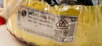

I received a gift this
toroidal transformer
Your opinion is worth anything?
Is he good enough to build a nice power supply 9V to my project on the denon dvd 3910 audio circuit

IF it works .. then why not.

thanks
When I think about it
I do not think that this transformer will not help me
Because I need to voltage the to the dac of
9V+
9 -
This transformer has only one
Secondary.
Sorry for asking i did not paying attention
Sorry 🙄
It seems ideal to me to me
But a bit expensive
25VA Encapsulated Toroidal Transformer 115/230V, 15Vx2
25VA Encapsulated Toroidal Transformer 115 230V 15VX2 | eBay
I'll see if There such like thisFor Sale
In voltage
12V +
12V -
Thanks again to all who respond

It will take about 25 turns of wire to make a new secondary with enough voltage for your use. I suggest twisting four wires together then winding those to make four new secondaries. Then use a bridge rectifier on each. Wire two in phase and two anti-phase. The you can combine one of each to give you less line noîse and the raw DC. A simple CR2C filter should then feed your regulator chips.
