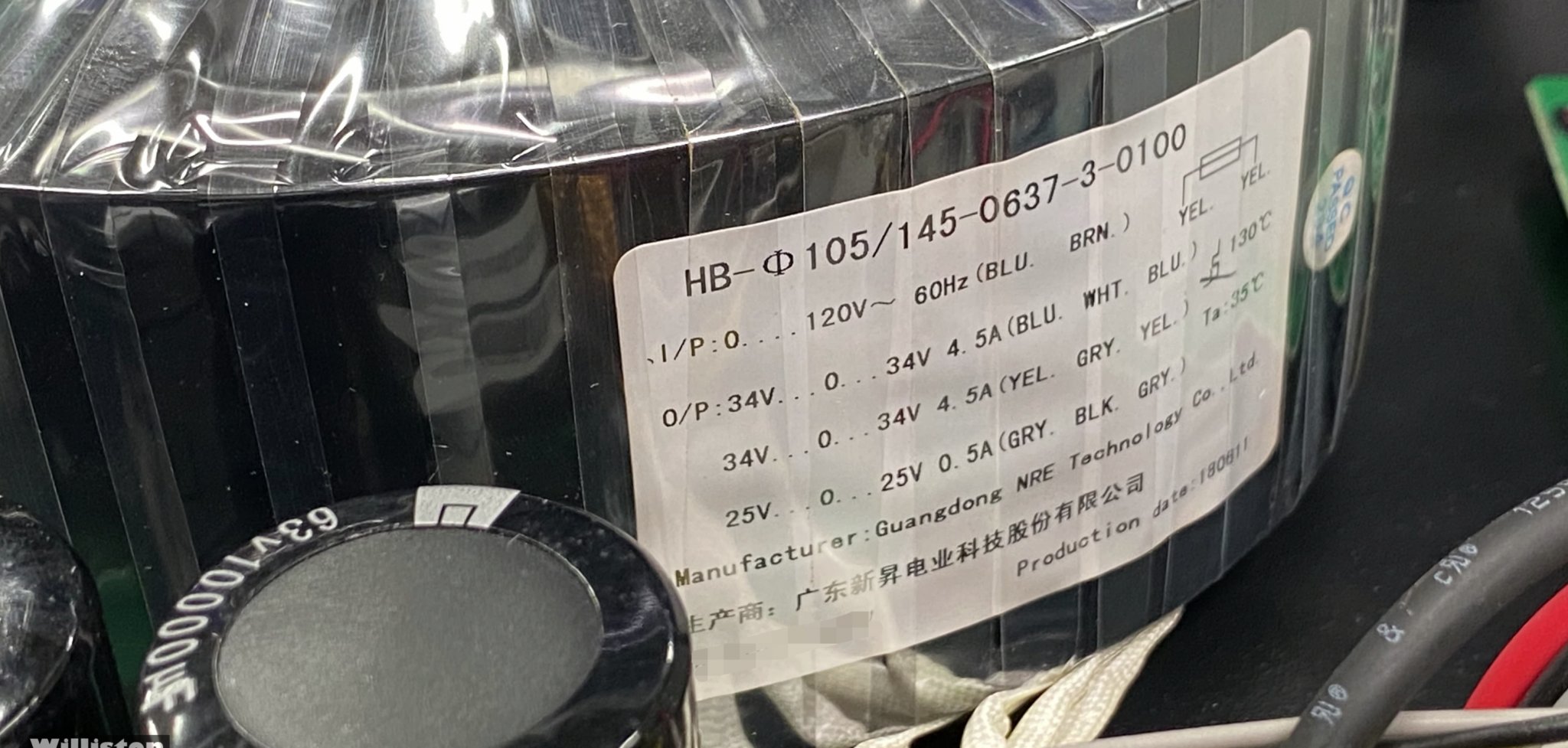

The calculated amperage requirements (6.2 A at 8 ohm and 12.4 A at 4 ohm) still seem to be greater than the secondary windings amperage ratings (4 5 A).
The only way I can understand the maximum continuous power ratings is if the amplifier is actually driven into curent overload.
Those dual secondaries being wired in series 34-0-34 V at 4.5 A for an output of 68 V x 4.5 A = 306 VA, are actually capable of withstanding over 9 A of current as if they were wired in parallel for 34 V x 9 A = 306 VA.
One last question: the secondary windings voltage ratings shouldn't be proportional with the primary winding voltage rating (120 V)?

The primary and secondary voltages are proportional in theory, without considering the internal losses due to loading.One last question: the secondary windings voltage ratings shouldn't be proportional with the primary winding voltage rating (120 V)?
I am amazed by degree of cheapness. By my calculations, that transformer is not good for more than 200 W/channel.

I'm not. Transformers are expensive. Shaving a few percent off of the cost of the transformer improves the profit margin of the product significantly. Besides, as pointed out above, most of us listen to music rather than sine waves. And even when we do listen to music, we often don't do so at ear-splitting levels. Now, if the amplifier was intended to drive a shaker table at the full rated power for days with a sine wave I'd definitely recommend a larger transformer. 🙂I am amazed by degree of cheapness. By my calculations, that transformer is not good for more than 200 W/channel.

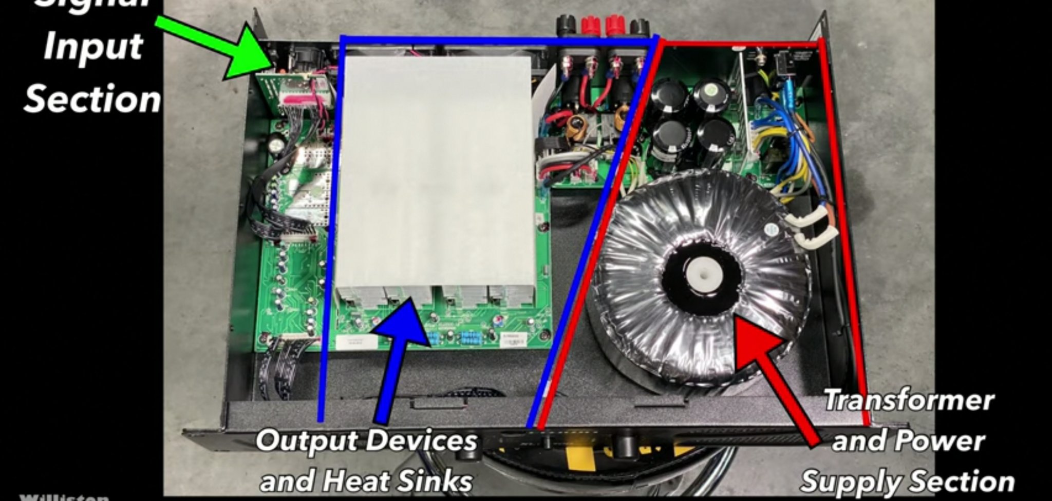

Well, I am a DJ and I do use a PA reinforcement system, but with much higher power capabilities.
This particular amplifier (XLI1500) is used to drive a set of loudspeakers rated for 165 W continous at a nominal impedance of 6 ohm.
I never use the amplifiers to their full rated power ratings or close to their limits, because I want to maintain a good headroom for peaks and ensure the termal stability of the amplifier.
I want to understand the workings and limitations of this amplifier and if, possible, to improve its performance.

They're the same amp layout. Difference in power transformer sizeMaybe, but then why the 34V taps?
Do you have a schematic?
these amps delivers massive power.i own 4 xli 800 and 1 xli 3500.tested with any compination on pro neo subwoofers and side to side with my dynacords 5 times more expensive amps they are amazing and not underated. i mean look at the price the only thing i found is crap capacitors inside (ok cheap amp) change it with high quality and the amp keep going for meny years
