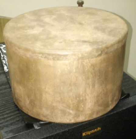

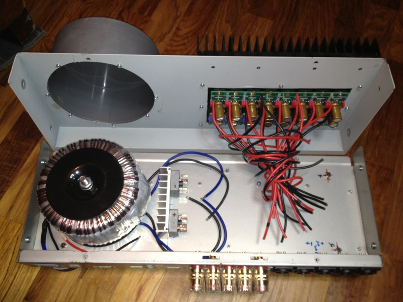

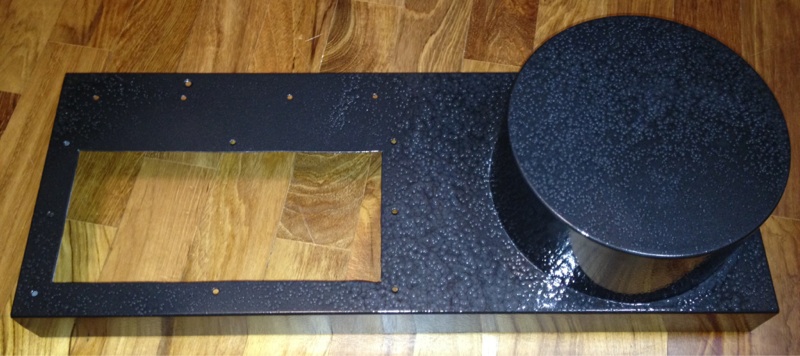

I used a PVC pipe endcap for my latest project... not too worried about shielding - wanted something that could be mounted without a plate underneath.
After painting with Rustoleum hammered black ...

I found some fan ducting that was useful, but can't find the reference in B&Q any more. I'm in UK.
Greenwood solid ducting, B&Q, 10.5cm internal, for fans NDX100, NTX100
