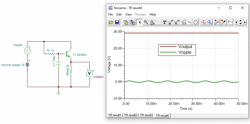

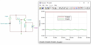

Do you really need regulation for the power section? How about just regulating for the preamp?
My experience with high gain amps say for microphones, is that ripple is of a bigger concern than regulation.
That is easily combated by using an NPN bipolar transistor set up as a capacitance multiplier. Two resistors a transistor set up as emitter follower and a relatively small capacitor on the base gives you wonderful ripple rejection on the supply. The transistor hfe multiplies the capacitance value. With an Hfe of 200 a 100uf cap becomes a 20,000uf capacitor. Those three components are cheap enough you could afford a circuit per section of preamp. Maybe you are building an 8 channel mixer for example - capacitor multiplier for each section. A small T0-93 transistor has sufficient current in this case.
For the life of me, I could not get rid of that last bit of hum using regulators for a discrete op-amp design I made. A capacitance multiplier was 10x as effective at a minimum.
Most class A/B amps just filter the supply as there is very little to be gained from regulation as they reject common mode noise on thier own, It's the high gain front end that will amplify noise. Note in the example you do loose 1 volt of power supply V due to base current and Vbe. So what in a preamp section.
