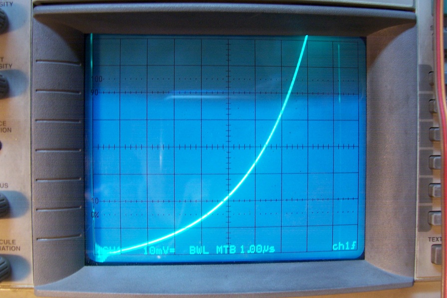

Obviously, the small amount of wire needed results from the intrinsic efficiency of the toroidal structure and high initial permeability of the ferrite cores; together, these mean that the inductors will saturate at relatively low power. Can somebody tell me how to measure the level at which these coils reach saturation?

Ungapped ferrite is probably the worst choice possible for this kind of application. It saturates very easily, and the initial accuracy is poor, as is the temperature stability.
In addition, the datasheet of these cores looks like a joke: there is practically no useful engineering data.
Anyway, let's try to work out an example based on the FT50-43.
The formula you have to use is Isat=(Bsat*Ae*N)/L.
Bsat is not given in the datasheet, but from the context I can infer that it has to be a NiZn material; this type of material is good at VHF, but has a poor saturation tolerance; let's say 150mT.
The effective core area isn't given either; it can be approximated from the physical dimensions: ~13.6mm². Number of turns is 33, and inductance 0.56mH.
Thus Isat=(0.15*13.6 10-6*33)/0.56 10-3=0.12A. That is the peak current value at which serious non-linearities will begin to show, that is about 85mA rms. Not very useful for Xover coils
To illustrate the above, here is an example: it shows the behavior of a comparable coil, the current plotted against the volt.second product.
The vertical scale is 100mA/div. The characteristic begins to become visibly non-linear at ~200mA.
Of course, this coil is somewhat different, it is a 250µH one, has a different section, number of turns, and the material is not exactly the same, but it is the same kind of crap.
