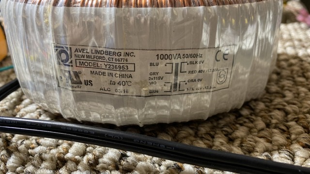

I bought an Avel Lindberg 1kva Toroid 15+ years ago. It warmed up when connected to the mains... got to over 38C with no load. They sent me a replacement... but this guy is still with me. They didnt want it back.
Question I have is... how warm can it get and be considered safe? 40c? 50c? 80c? Measured on the outside? I really don't want to throw it away...

Ambient 23c. The Toroid is 1000va with 45-0-45 secondaries. Other 1kva Avels never heated up. I have a bunch of other large toroids... they dont heat up.
this one goes up 10-12c above ambient in 15 minutes. I can keep testing... I just need to know how hot should it get before I pull the plug... this was the original question.

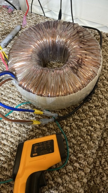

Pics

So I measured the voltage on the secondaries, when powered by Prim 1, I get 40-0-40 on the secs.
When powered by the Prim 2, I get 43-0-43 !!!
So it seems one of the prims has a few extra turns.
So the question I now have is... how can I salvage this toroid, I am sure if I power it with only one Prim, it will not heat up (still to be tested) but what does that mean, is the 1000va trafo now a 500va trafo?
