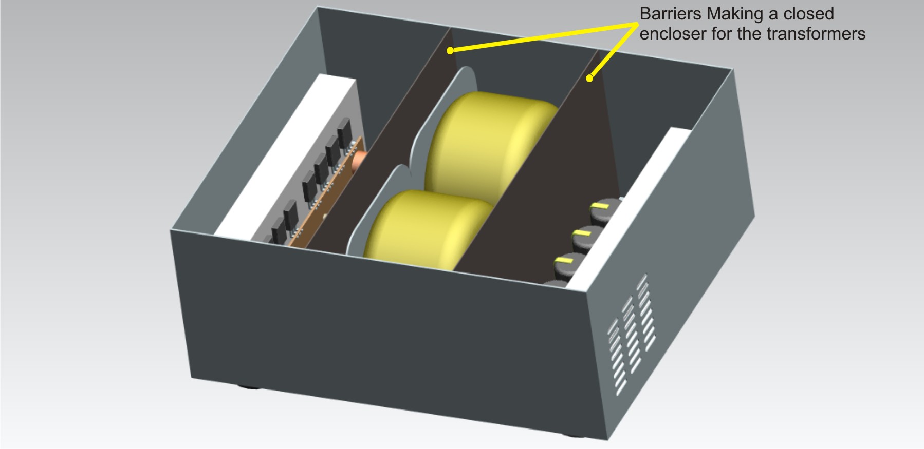

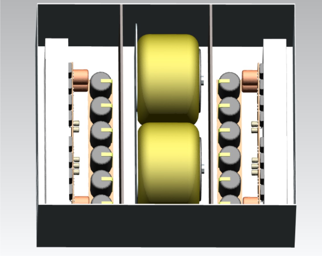

So, How about making a Barrier between the Amp Boards & the transformer, just like i have shown in the virtual images I made below.
Making a 1mm Steel or a 5mm thick Plastic wall/barrier between the transformers & the Amp boards. Also covering this wall with a thin layer of Leather. Will this method do any Good to shield the amp boards from Electromagnetic waves being emitted from the transformers? Or is it a waste of time to make these Barriers?
I'd use 3mm steel. I suspect 1mm won't make much of a difference, 5mm plastic I'd be surprised if it had any effect at all I can't see any reason the leather would help but if you have a theory on that I'm all ears! I used lead for a shield on my torroid years ago, which did have an effect but not as much as I would have liked, I since found out that steel is a much better attenuator for EMI.

To be Honest i did not come up with the Leather theory. Its just that not long ago i had opened up a Hi-End Amplifier (Chinese) the toroid transformers were contained in a special Round enclosure, i think steel was the material of the enclosure about 1mm thick & the outer surface of the enclosure was completely covered with some sought of leather material. I thought maybe the leather covering meant something.
It could be used as an insulator to ensure that there isn't a shorted turn.

I'd use 3mm steel. I suspect 1mm won't make much of a difference.
In that case i will have to drop my plan to even make a barrier, Cutting a 3mm Steel Plate as per the required dimension seems a time consuming & a expensive process (using laser cutting method).
1mm might be adequate my comment on 3mm was based on some recollection of something I had read and not actual experience I have only used lead for sheilding. Have a look at this thread DIYHiFi.org • View topic - Power transformer shielding(external) at least one poster is saying that 1/4 inch aluminium is a good shield.
