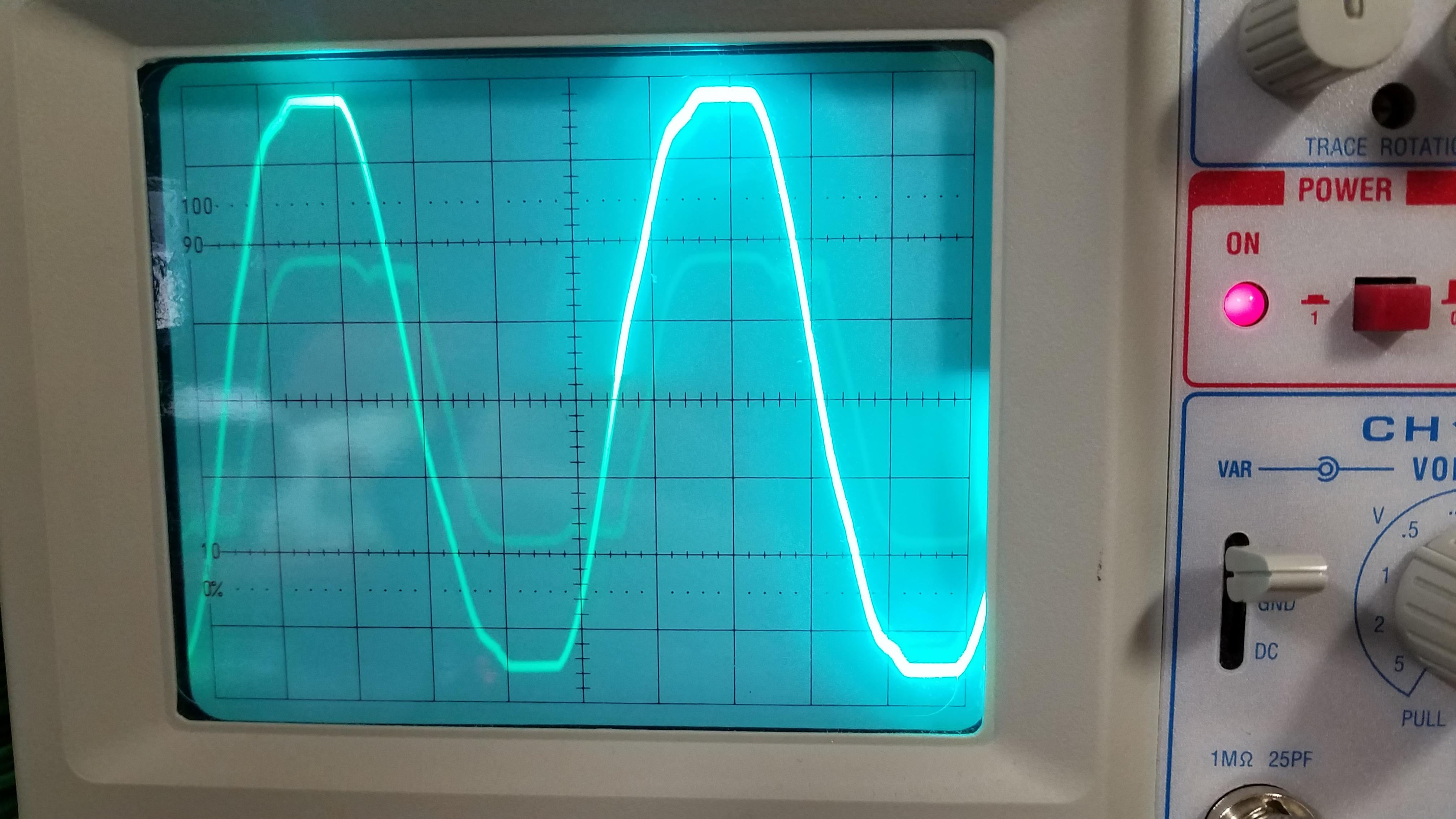

Definitely just got a smoking gun. Here's a couple dual trace shots of the HT and Aux supply. The brighter is the HV winding, the LV is faint. I've never seen anything like this before...it appears the energy from the HV winding is propping up the Aux winding voltage, not allowing it to change. What is this even?
Given that your scope probe gnd is at the neg end of the bridge for each trace, and you have shifted the trace down to allow the full B+ range on the screen, then the flat top and bottom sections are when the bridge diodes are conducting and the winding end is clamped either one diode drop away from gnd or B+.
When the bridge diodes are not clamping the winding ends, then there are only stray capacitances charging up and down to control the voltages that you are probing.
Lets follow the LV winding trace first - it appears to start getting clamped before the HV, and un-clamps about the same time as the HV, and the edges appear a little rounder (which is likely just the channel gain not overlaying the waveforms, but could also be related to the diode voltage drop as a % of the waveform p-p voltage).
I'm thinking the LV trace then doesn't change much for a while because of the large variation in schottky diode capacitance with voltage. The diode that was just conducting exhibits a lot of capacitance when the junction has close to 0V across it, whereas the other diode in that side of the bridge arm is significantly reverse biased and exhibits a much lower capacitance. The winding current that is charging/discharging those diode junction capacitances is not large as it is related to dV/dt, and dV/dt is relatively low for the LV winding as compared to the HV winding. Hence it takes a while for the voltage on that winding end to be charged up enough so that the previously conducting diode capacitance falls enough to not constrain the winding end voltage (and both winding ends get 'clamped' by their previously conducting diode capacitances in the same manner).
In post #11, pic 1, that region of fuzz/noise is during the time when just diode capacitances are determining your trace voltage waveform. That fuzz could be related to diode turn-off energy in one/all the windings trying to find winding current paths to take - but also could be related to you probe gnd position. The advantage of the tuned snubber on each secondary winding is that it can rapidly attenuate the winding currents that appear to be causing that fuzz.
But this is probably just an aside to your main hassle - but none the less worth appreciating.

First thank you for the excellent explanation, sincerely. But I really was hoping you wouldn't say that. 😉
After a little more experimentation, I found that if either LV supply fuse was removed, the waveform looked fine. It's only when both are active. Would it be a bad idea to swap the XFMR leads on the Aux supply since the 2 LV supplies are relatively the same? I'm thinking we could maybe cancel some noise that way since the currents will be out of phase.
Just to verify the toroid is culprit can u unscrew the cnt bolt and rotate and vary its angle. Have the guitar laying so the noise is obvious. If it is the toroid the noise will change if not it is not the toroid. I think...
I tried this and no, it doesn't seem to matter. Which is making me wonder because it surely has to be magnetic in nature since the guitar is pickup source.

So its not the toroid! No need to spend time on that... It must be the rectifiers or something in the supply circuit. Are u using full wave rectification on all windings? If half wave u may build dc bias on the core since its not a symmetrical load. How many secondary windings? Is there a winding being used to supply several rectifier/circuits?

Sorry I've been MIA, there was a lot to try and I was being meticulous about recording results and experimenting.
