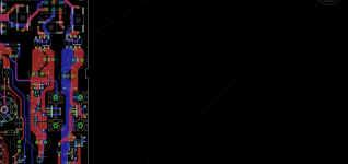

As far as loop areas, I tried really really hard to minimize every single loop area. Loops are either routed right next to or directly on top of one another for the most part, even the transformer leads are super short (3.75" for the primary, 1.75" secondaries).
Attached are the supply layouts. First is HV, second is the heater supply (left) and Aux supply (right).
