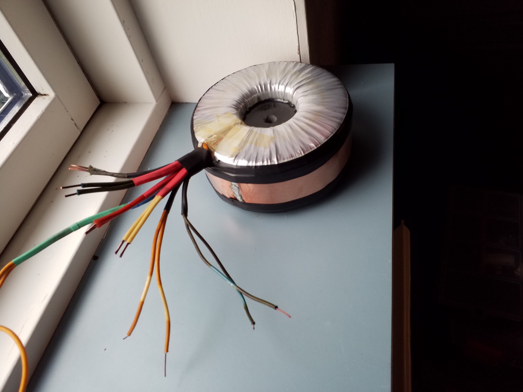

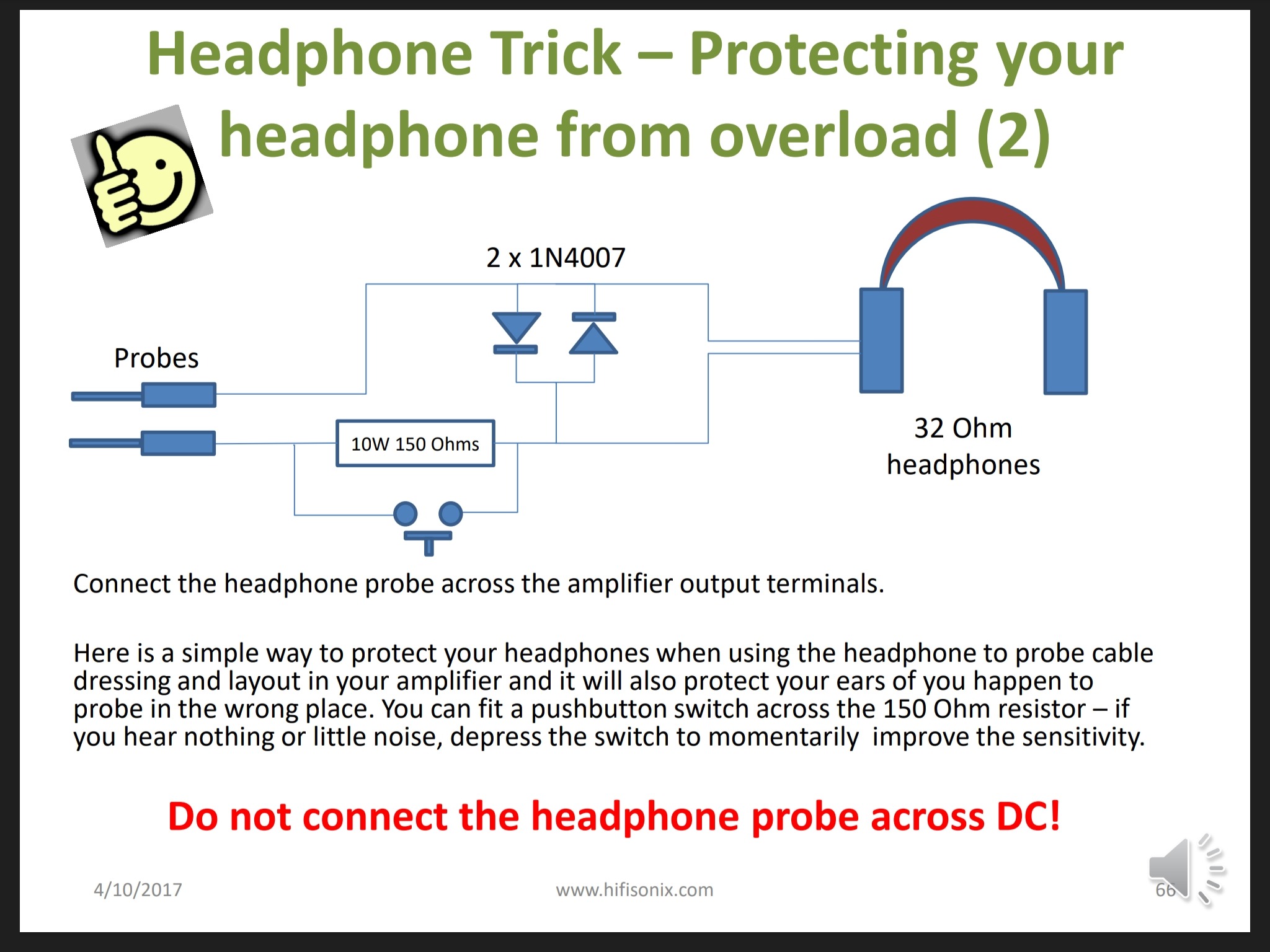

I have used this method a couple of times, listening while moving/turning transformer and cabeling.
You get immediate response, very intuitive .
And the band does help, here is my latest used trafo "improved" with band, it's for the p3a.

For a toroid a regular Gauss band is almost useless, because the stray fields are aligned with it; it can have an electrostatic shielding effect, but that's about it.
The Gauss band equivalent for a toroid would have to be a continuous, flattened copper sphere encompassing the whole transformer, which not very practical.
The alternative is a GOSS band, and this will work since it is ~aligned with the bulk of the stray fields
Reactions: newvirus2008
One more point: the above applies to correctly wound transformers: each individual winding needs to have an even number of layers, and the winding direction needs to be reversed at the end of each odd layer.
Failure to do so will create "ghost" turns, meaning non-zero external field, magnetic leaks and leakage inductance.
To determine if a transformer is properly built, you can wind a dozen turns of insulated wire around the periphery, where the Gauss band would sit, load the transformer to its maximum and see if a voltage appears across the auxiliary winding.
If a non-negligible voltage appears, it means that the construction is incorrect, and in this case, a Gauss band can be used as a band-aid, to mitigate the problem, but the best option is to start with a good transformer
