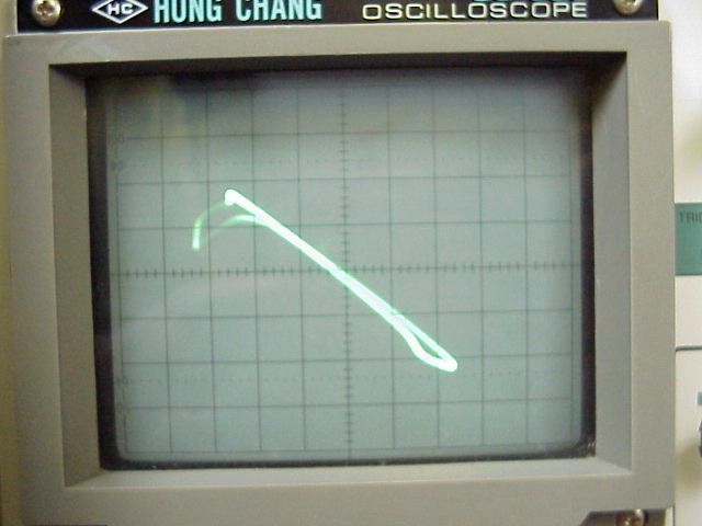

Did some mods, and the power supply now is +/-22V
The total bias is 7.78A
The AC current gain is 50%.
The number of fets is 16.
This is all for 1 channel, and according to berekening.xls I am supposed to have 100W into 8ohm and 121W into 4ohm.
The reality however, is different.
8ohm: 59W (19V*3.1A)
4ohm: 30W (10V*3A)
measured with a true RMS-DMM just before clipping.
I took pictures of the XY-axis scope result.
The amp is playing extremely well at low volume.
What could be wrong?
The first picture shows the result at 8ohm.
/Hugo
Netlist,
seems like you don´t have enough ac current gain and 3A is the max you can get out of the amp.
What you can try is to measure clipping voltage with no or a very high load (the output to ground resistors for example). If you get around 28V (40 volts peak) then at least this part of the amp is ok.
Now you´ll have to see why you don´t get more than 3A . 3A would mean 4.2A peak current and a total of 4.2A bias (both sides) at 50% ac-current gain.
If as you say you´ve got 7.8 A you should have 7.8A peak and 5.5A rms. Since you only have 3A rms your ac-current-gain is only around 10%.
