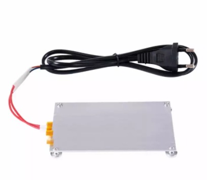

Replacing the chip will work since it is pin by pin compatible. (Unless there is some form of elaborate IP protection technique that will melt if the IC section was soldered LOL) Also, TPA3251 and TPA3255 have different gains so if you put the wrong chip you won't get the same performance (or might not be stable at all because of PFFB configuration).
Heating plate is just around 4USD. With a variac, you can easily control the temp and desolder the IC without damaging it.
The original IC can be put back if anything goes wrong.
