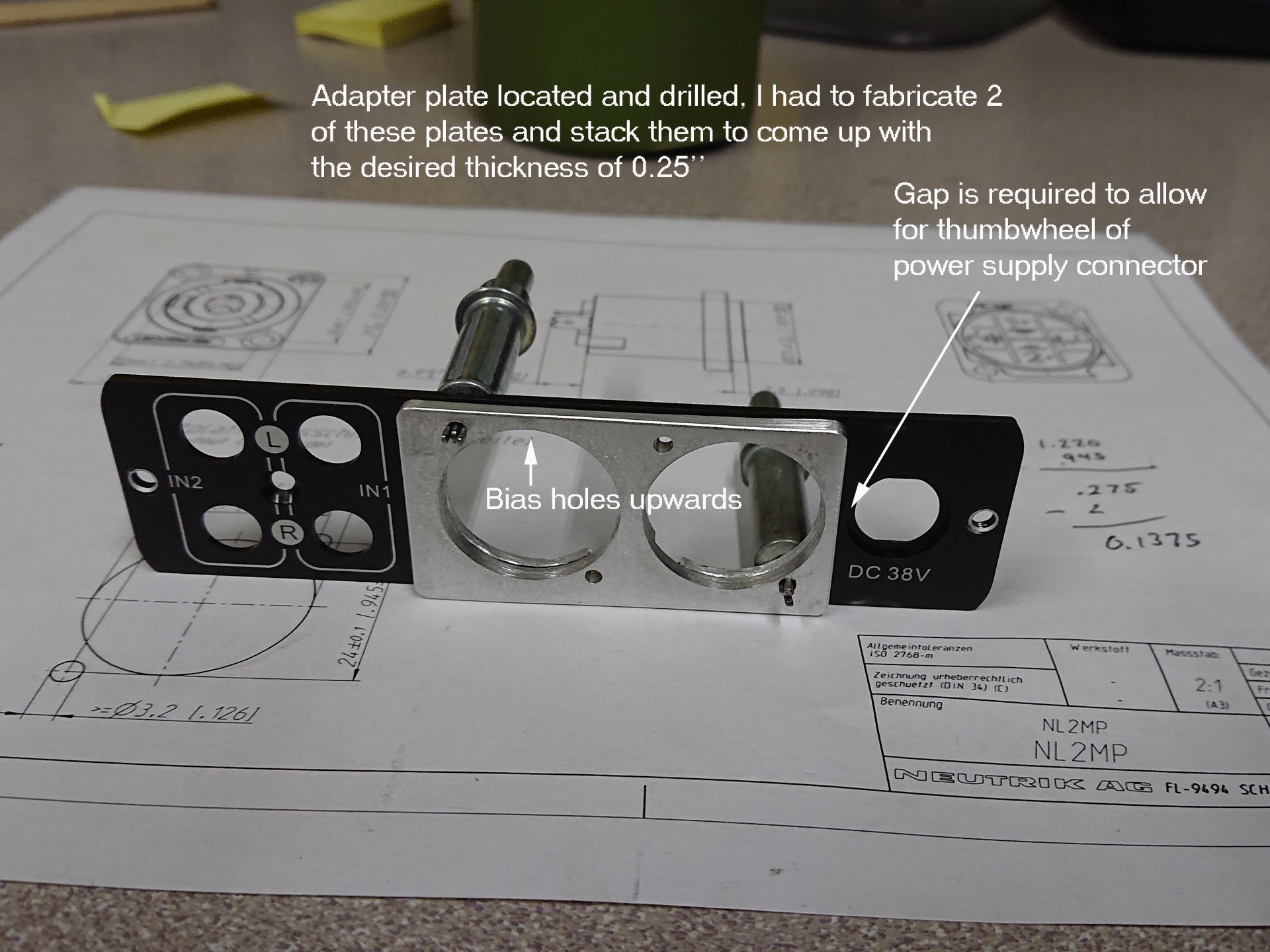

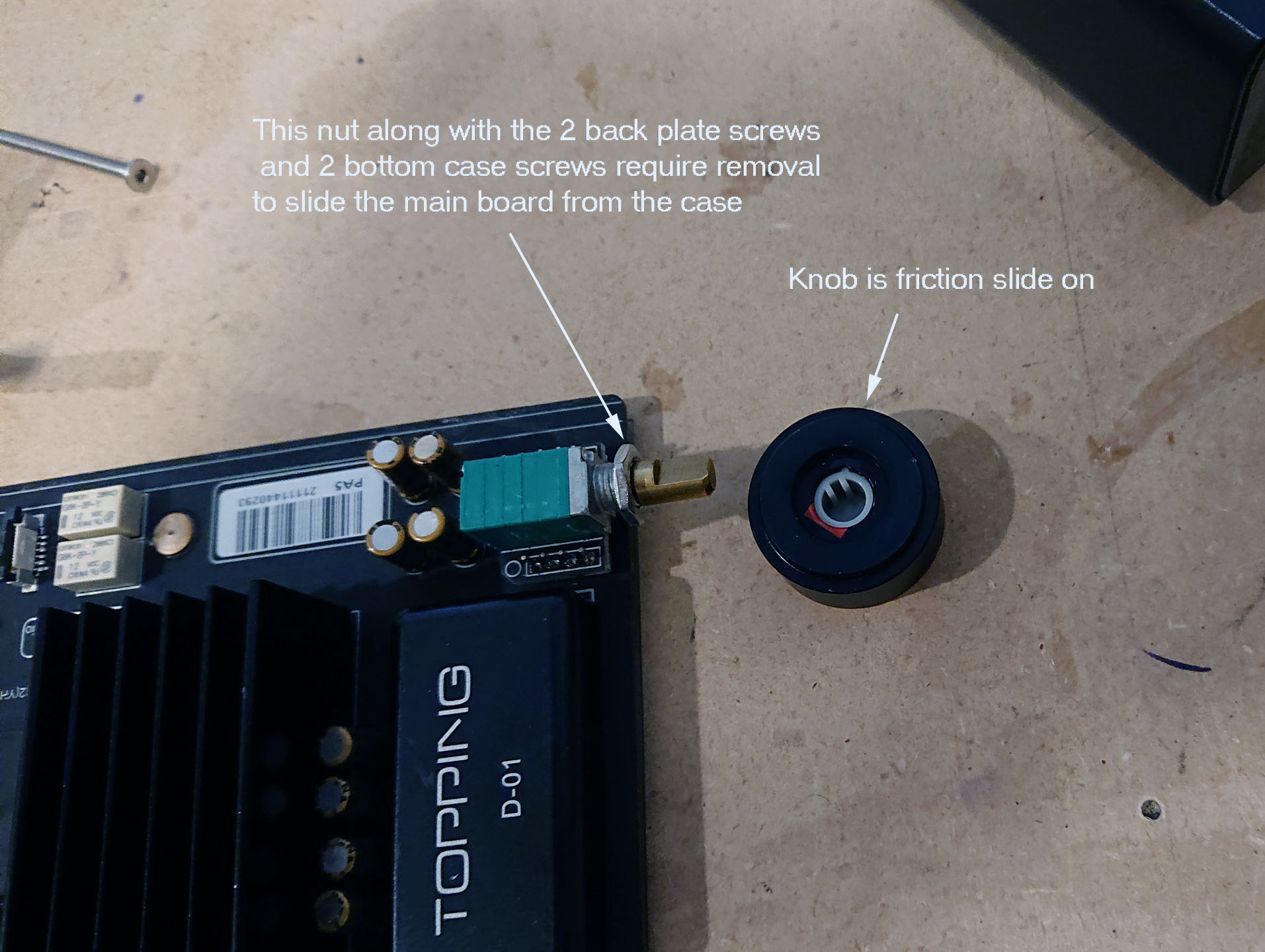

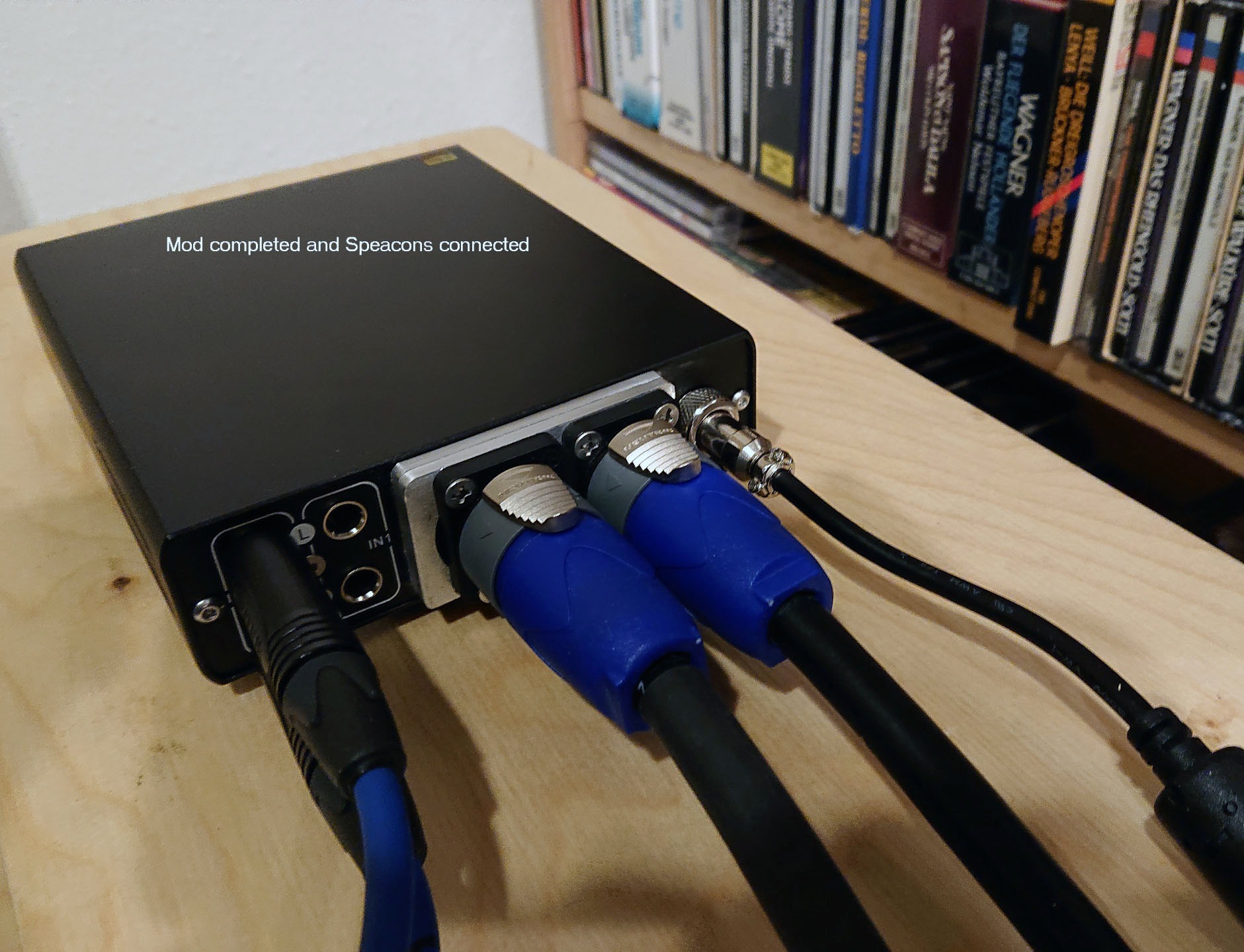

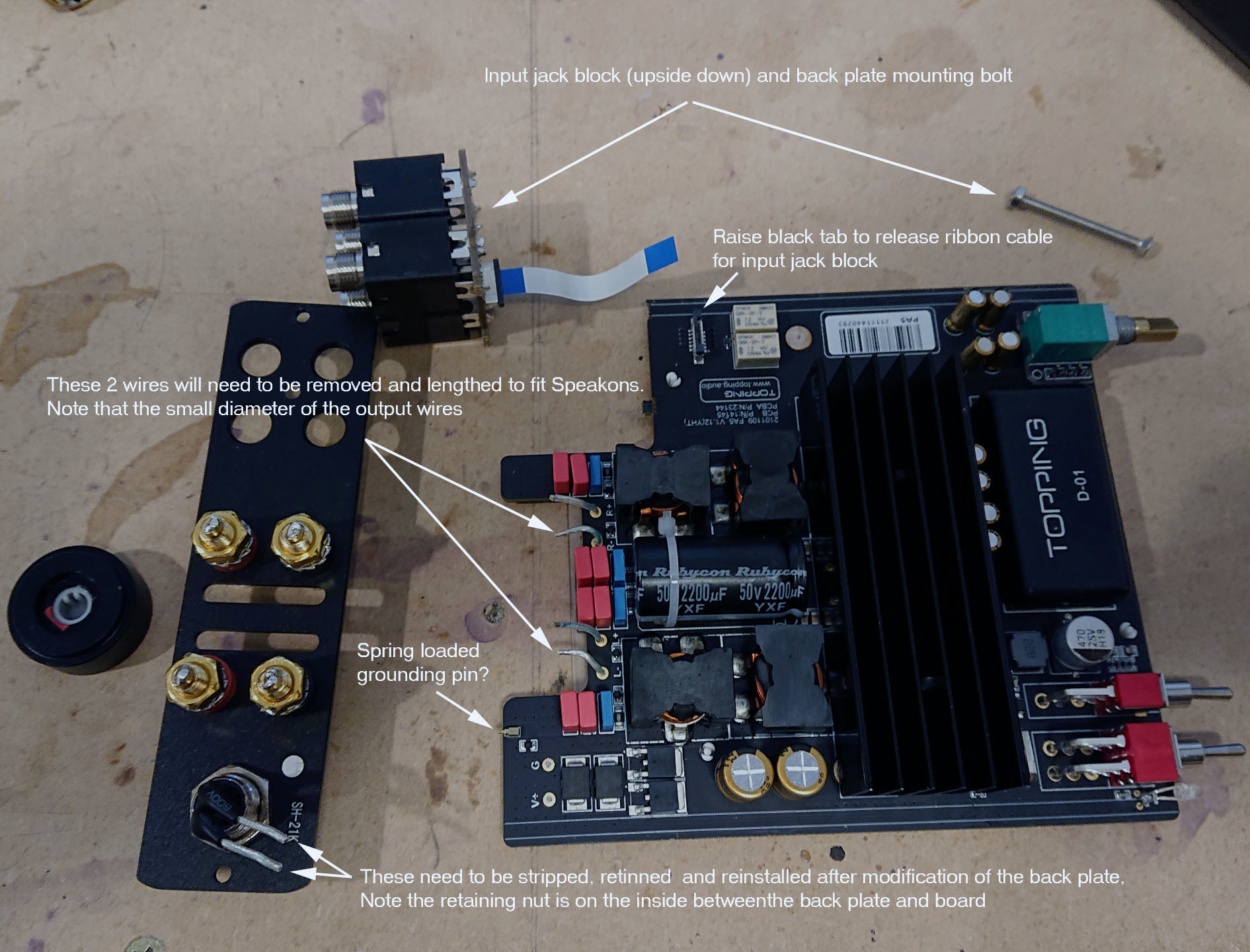

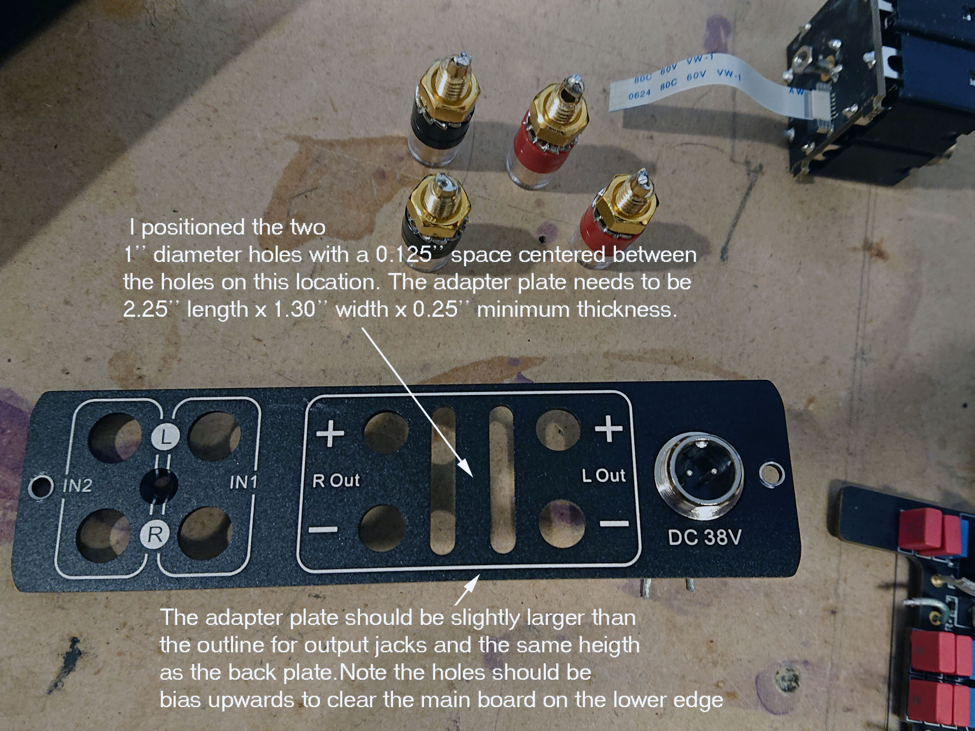

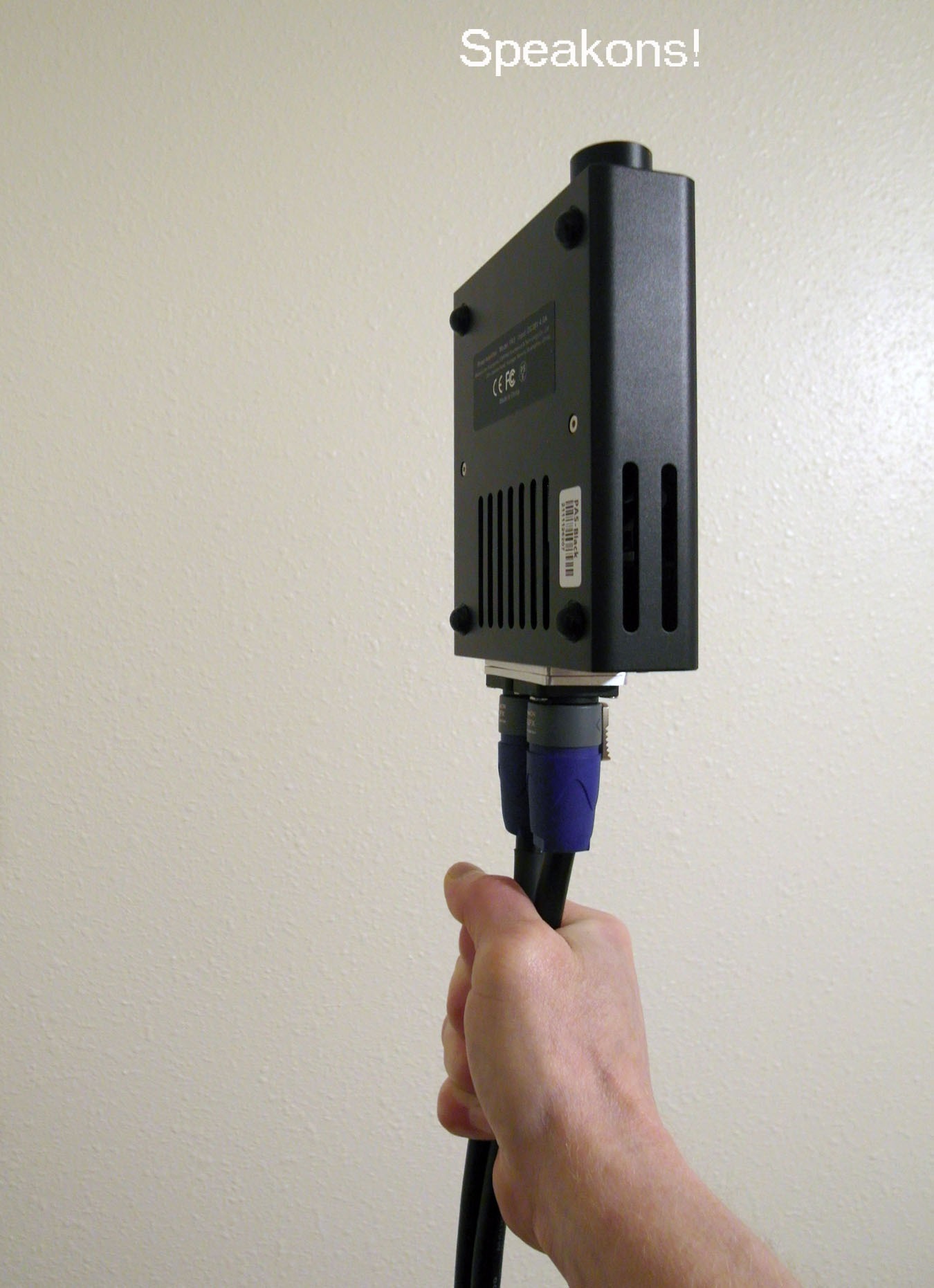

I find the PA5 to be a bit of an odd duck with pro audio balance inputs and consumer level small 5 way binding post outputs. Upon receiving mine I found foremost reaction was the replacing the later with Speakons as the amp was to be used whenever, wherever and my history with binding posts have relegated them to the ash heap upon discovering Speakons. The following are my experience replacing the binding posts.

View attachment 1016093View attachment 1016094View attachment 1016095View attachment 1016096View attachment 1016097View attachment 1016103
very nice work but the slits in the back plate aid ventilation. Removing them can be dangerous. Of course there is no more room for them now….

Oh I think there is more that enough ventilation,very nice work but the slits in the back plate aid ventilation. Removing them can be dangerous. Of course there is no more room for them now….

Just flip it over so bottom vents face upwards.very nice work but the slits in the back plate aid ventilation. Removing them can be dangerous. Of course there is no more room for them now….
BPT
BPT
Both bottom and top cover have ventilation holes )
Mine doesn't. It has bottom and both sides.Both bottom and top cover have ventilation holes )

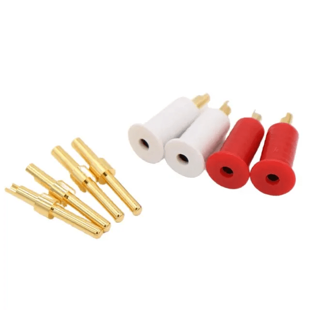

Did you check the quality of the binding posts, take a magnet to all the parts? Ferromagnetic? Do you think you noticed any improvement after installing Speakon connectors?
