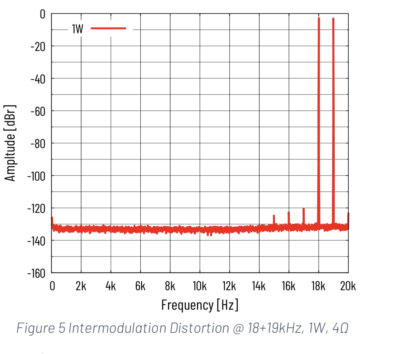

If that’s the case please share a class A/B amp with a better 18+19k IMD result than thisNo doubt this is a pretty hard test. But I agree with Amir that is beyond the range of audibility. So - nice to have - but not really important imho.
Besides I agree that a bleeding edge class-D amp will loose compared to a bleeding edge linear AB amp in terms of noise, slew-rate and hi-frequency distortion. But with TPA3251 and some post-filter feedback the only thing that could nag me is the residual noise level - not too bad at all - but there is about 10-20dB headroom for improvement.
It is a pity you did not specify your EUT. And I can only refer to the linear/class-D-amps I measured.
It’s the Purifi 1ET400A class D module. You’ll need to update your database to include today‘s class D amps.It is a pity you did not specify your EUT. And I can only refer to the linear/class-D-amps I measured.
Thank you for your reply. I admire Bruno Putzeys work - but this is DIY - so my reference are DIY amps I can afford.It’s the Purifi 1ET400A class D module. You’ll need to update your database to include today‘s class D amps.

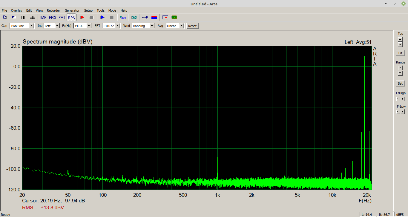

The IMD debate gave me a kick to do some IMD measurements of my own. Using my laptop with ARTA, an EMU-tracker pre USB-Interface, a 30V bench supply and a 4 Ohm dummy resistor I tested my TPA3251 prototype pcb module. The 1kHz peak amounts to -88.1dBV which results in a distortion level of -101.9dB below 5W/4 Ohms. Estimated accuracy is within +-3dB. Just to show an example of a real DIY solution.

Looks to me like the side bands are about -72dB below in the high frequencies. 48dB worse than the Purifi. And slightly worse than the $68 Icepower 100AS2 module1:1 - and btw, this forum is not the center of my life. I do not read all threads, and I forget a lot meanwhile.

Certainly a TPA3251 cannot compete with the purify, did you expect something different?Looks to me like the side bands are about -72dB below in the high frequencies. 48dB worse than the Purifi. And slightly worse than the $68 Icepower 100AS2 module
