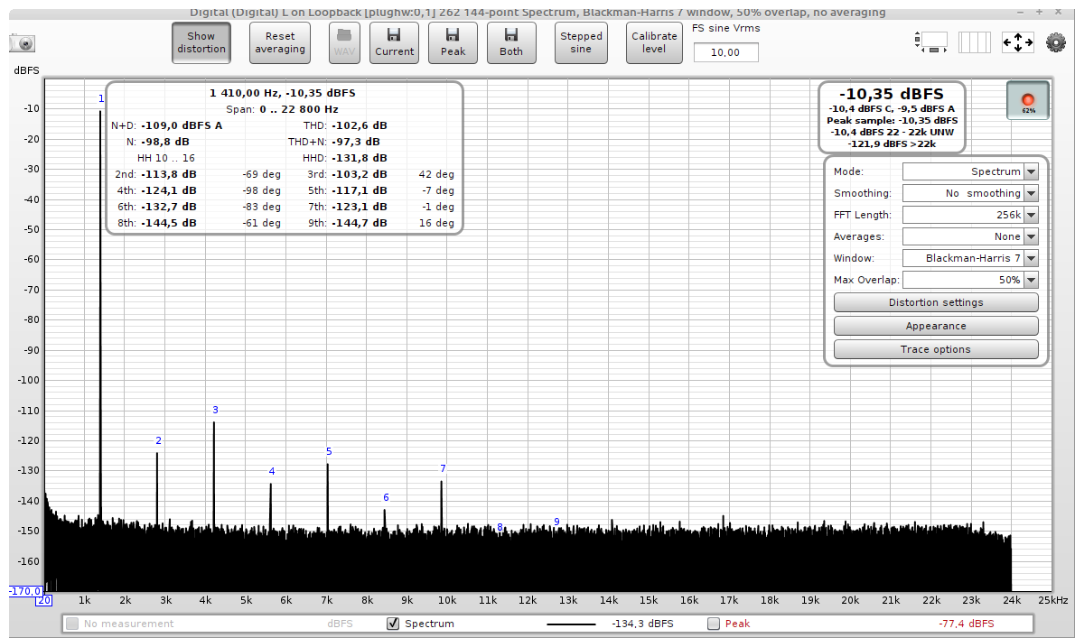

I am not sure I understand your question. The static polynomial transfer rotates phases only at multiples of 90°. But a real circuit is affected by dynamic distortions which further rotate the distortion phases.
An example: The first chart shows a real measurement of a DAC/ADC loopback. The phases listed in the upper-left table are different from multiples of 90°, especially H2 and H3.

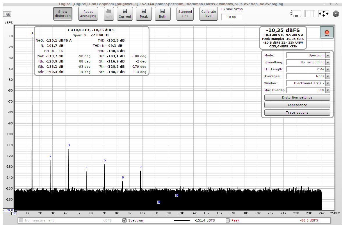

The second chart is a measurement of a digital signal, generated at the same frequency, the same level, with some white noise added to look similar, and with added H2 - H7 harmonics at exactly same level as the real measurement. The harmonics are generated by chebyshev polynomials, resulting in this static transfer polynomial:
Code:
4.47e-05 x^7 + 7.41e-06 x^6 - 5.60e-05 x^5 - 6.13e-06 x^4 + 3.89e-05 x^3 + 3.26e-06 x^2 + 9.99e-01 x - 1.64e-06
The chart shows that all H2-H7 phases are almost exactly at multiples of 90°. They must be, because sin^2(x) yields -cos(2x) (H2 at -90°), sin^3(x) yields -sin(3x) (H3 at -180°), etc.

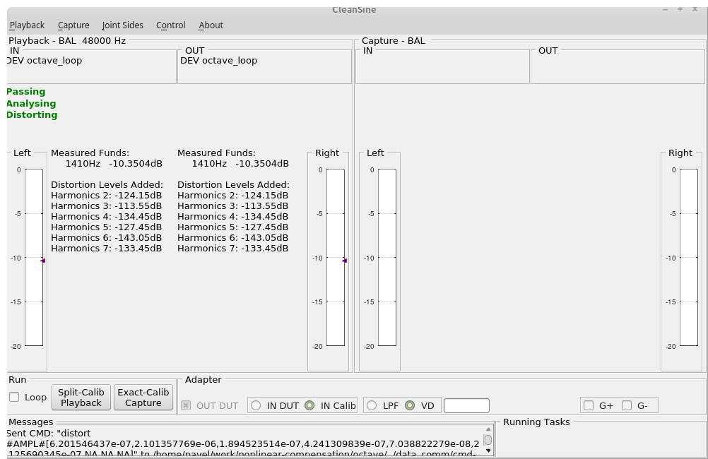

The third screenshot is my distortion-compensation tool introducing the distortions into the stream.

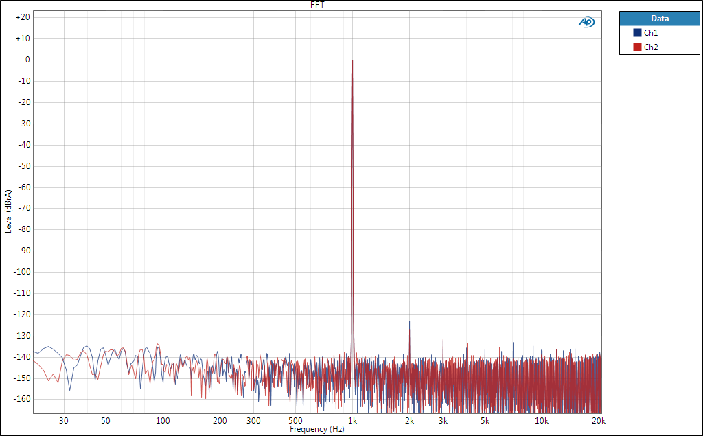

Allo is now shipping the Boss2, which is based on the CS43198. They say that the drivers are now included in RPI 5.4.77 kernel onward.
They are also selling a complete player and put up the attached AP FFT on their website: BOSS2 Acrylic
This looks pretty good - I may consider an upgrade for a player I built a few years ago: pi based systems - Page 6
