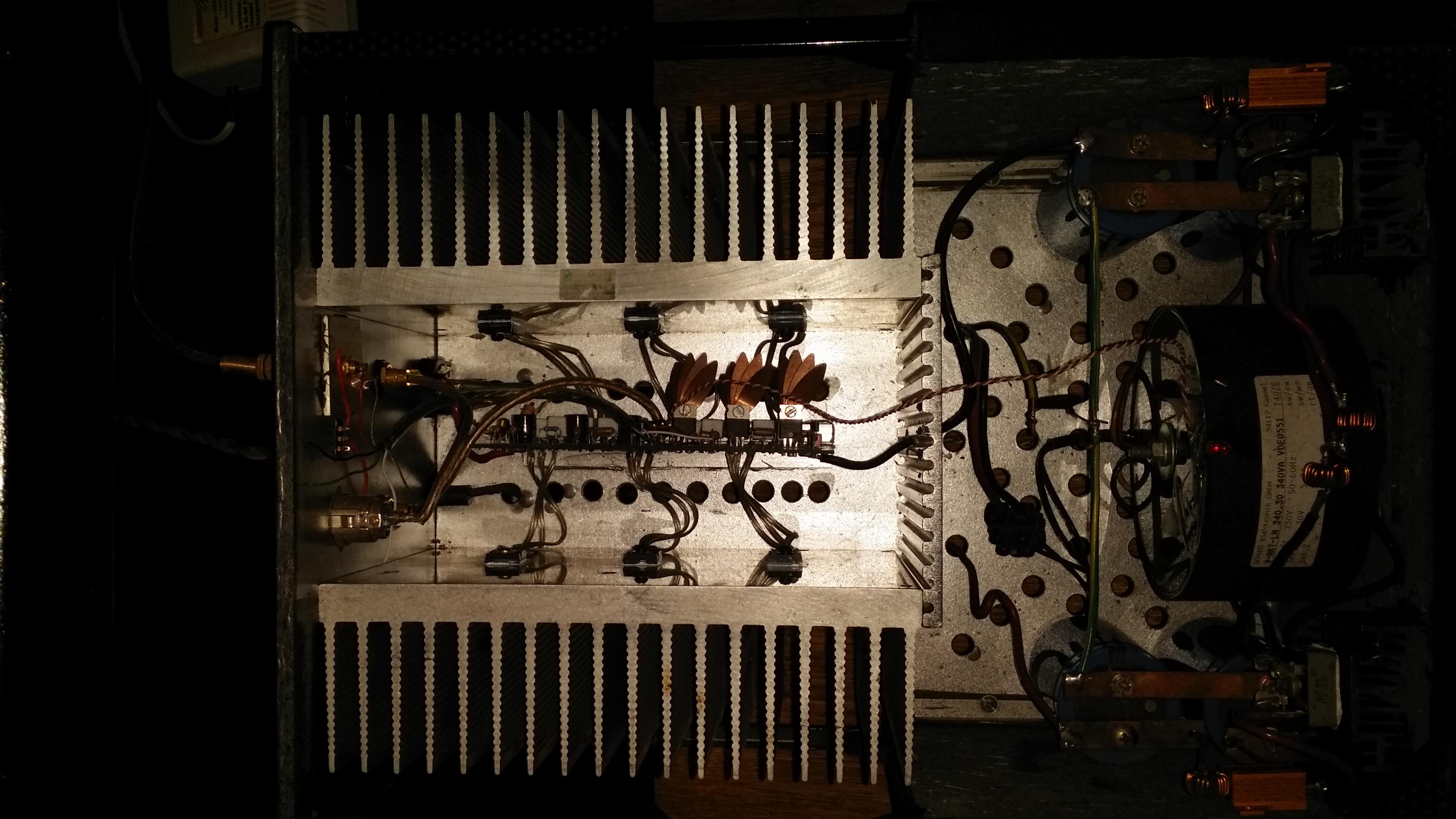

hello to all.
not able to find the answer, i'll ask the question.
the R19 you are all talking about, what resistor would that be on the boards from Kristijan Kljucaric?
i know i have plenty of heatsink as my amps stay at about ambient.
Thnx zen mod.
That would suggest that i need the 221k resistor or R17 on my KK pcb.
Starting with a trim pot of 200k should do the trick.
Yes, I pulled it out of my Aleph 2's many years ago. Full blast they bias at 4 amps and they sound incredible. Be sure you have adaquate heatsinking though as temperature is inversely proportionate to bias current. Aleph 2 is normally ~3 amps bias and runs hot. When you go to 4 amps is going to be blazing hot. I over heatsinked mine when I built them so no issues. They have been running this way for 12 years!
You can also install potentiometer in there and dial it to your liking and also to safe temperature.
- Top ten ways to a better Aleph?
