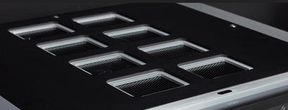

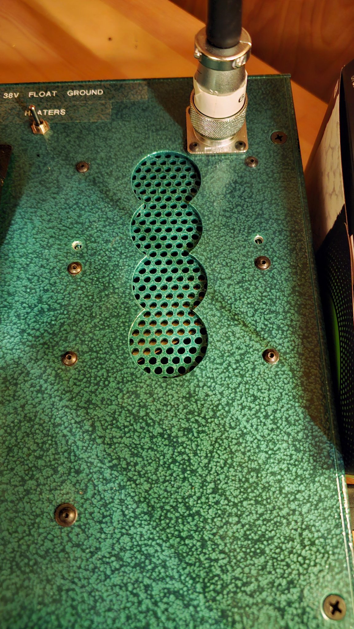

On my 1964 BELL 2420 cover - which had NO vents ! - I installed two air conditioner grids :
You guess that the tubes rendered me happy "cool-instead of warm" thanks !
I simply cut the openings in the top with a jigsaw, and drilled 6 holes per vent to fix them in place.

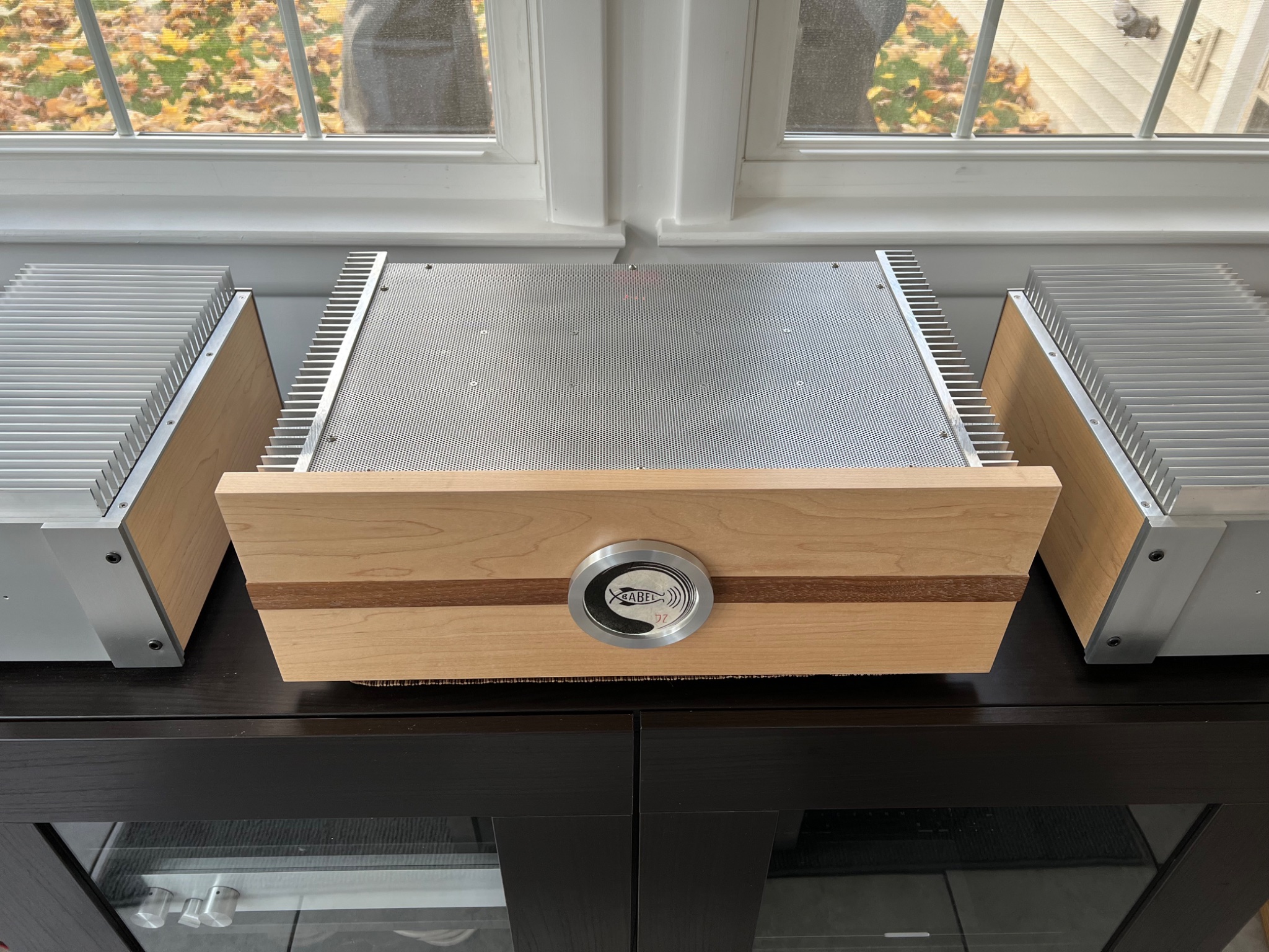

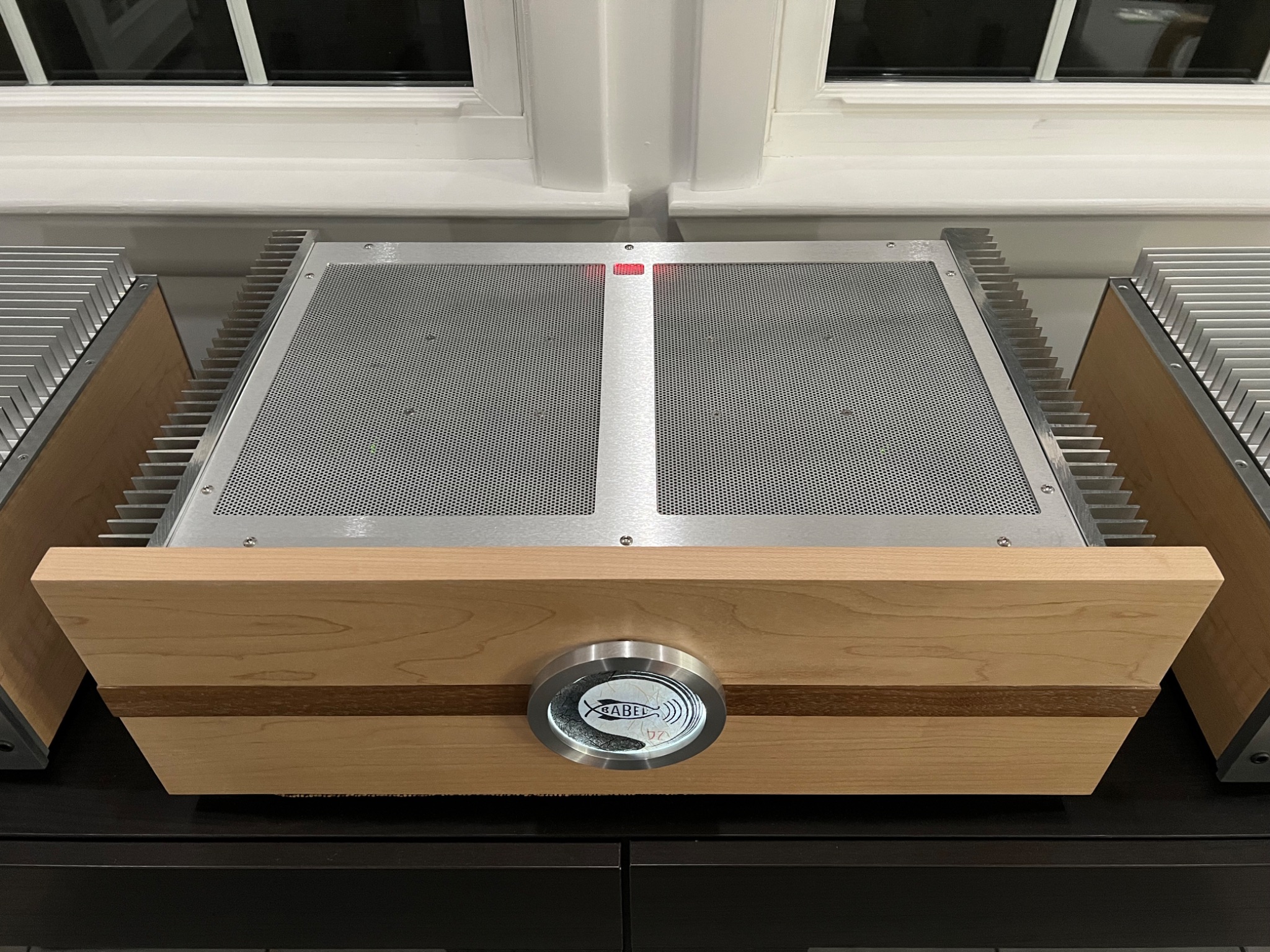

Can you assemble the top in layers?
This is what I did with my very modified eBay DIY chassis.
A full layer of perforated aluminum screen sits on the top of the chassis.
A second frame layer over the screen is made from the original solid aluminum plate top.

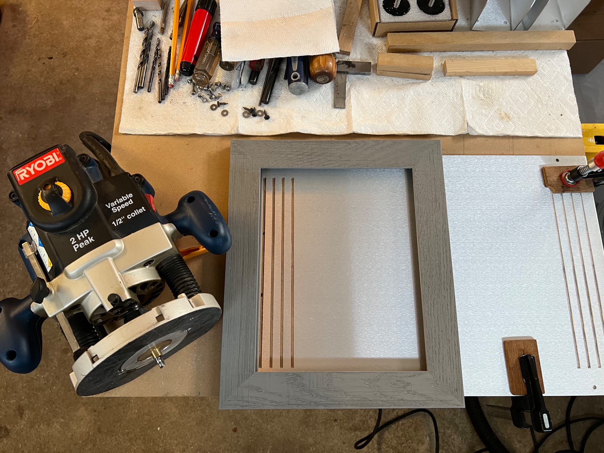

It can easily be cut by using a cheap picture frame as a guide with a router using a carbide bit.

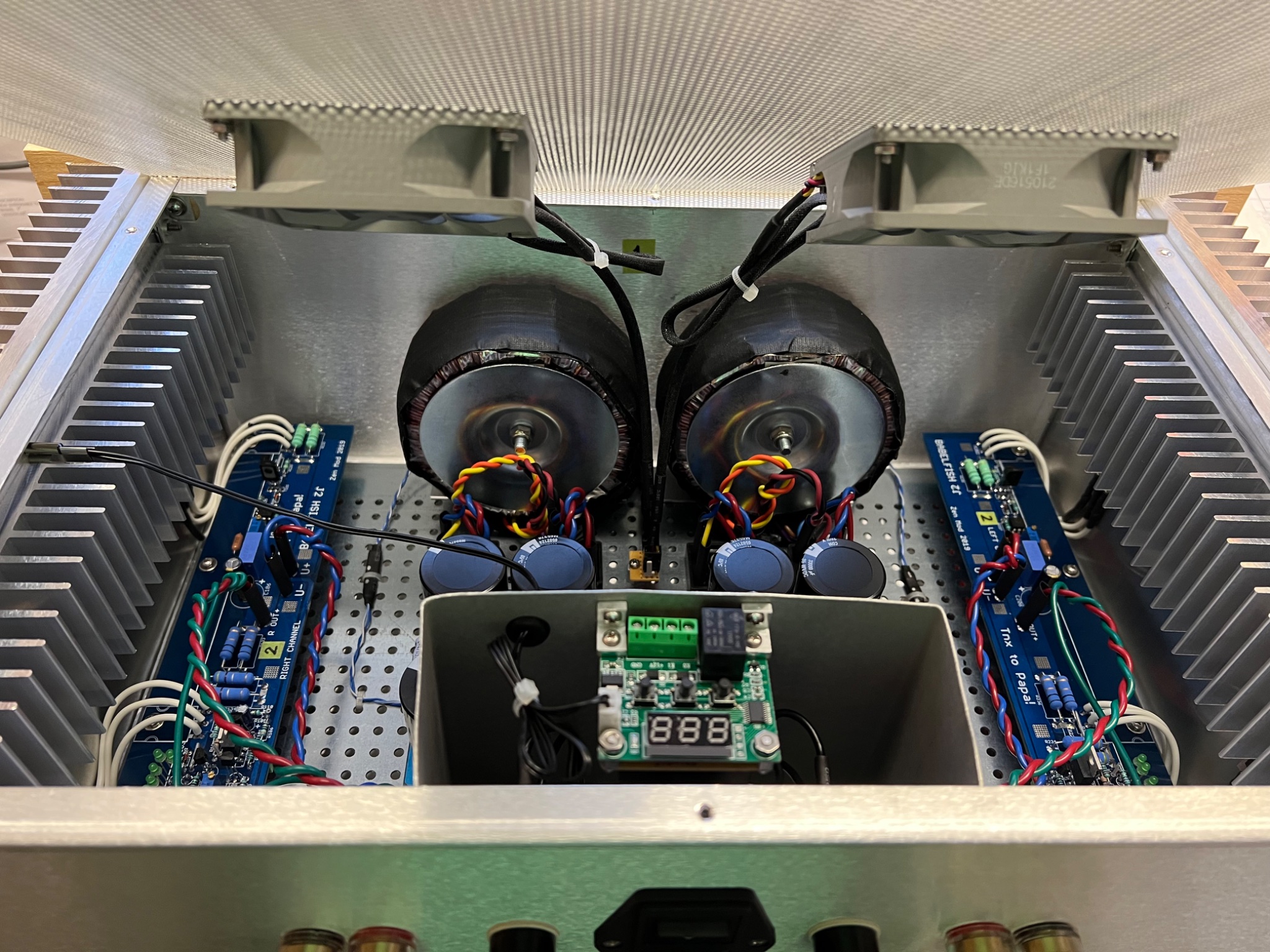

Just a note…since there are concerns about ventilation, rattling and grounding.
If you look closely you will see there is a cooling system I had to install in my amp using additional heat sinking and fans in order to run the amps at the current I wanted (about 1.8A). The chassis was a bit small for that to begin with…approximately a 4U/300.
There is a pair of 3” Noctua fans attached to the bottom of the perforated screen top that I power off of a voltage regulator so that I can tune the speed of the fans to operate silently.
The cooling system is monitored and run by a digital thermostatic relay. It is affective at maintaining the temperature range I preset.
I have never had any vibration noise problems with this top plate design.
Since the entire chassis (except face plate) and sandwiched top plate of the amp are made of aluminum and held together securely with hardware there is no issue with grounding either.

Top job! Seems like Babelfish! Logo is creative! Which mono-blocks are adjoining to BF?Can you assemble the top in layers?

That's a great idea and a very impressive execution! Especially cutting out the big holes and making the clean edges. I'll have to look into this.Can you assemble the top in layers?
