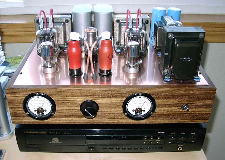

This amp is mine. I didn't build it, but I brought to the operating state 🙂

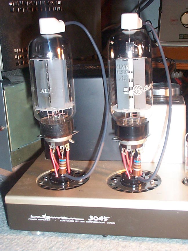

No grommet or anything, just a drilled hole; however, the wire has a tough braided cloth like material outside. The top plate is very thick, not much of a chance to cut through the wire.

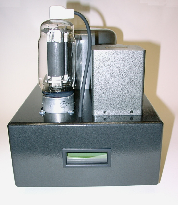

Here is the top half of my amp, showing the rubber grommet for the plate leads. I use a silicone insulated wire that is very limp and flexible, stocked in various colors by people who cater to model car enthusiasts. It's durable and stands up well to high temperatures. It also is a nice, snug fit into the tube cap
