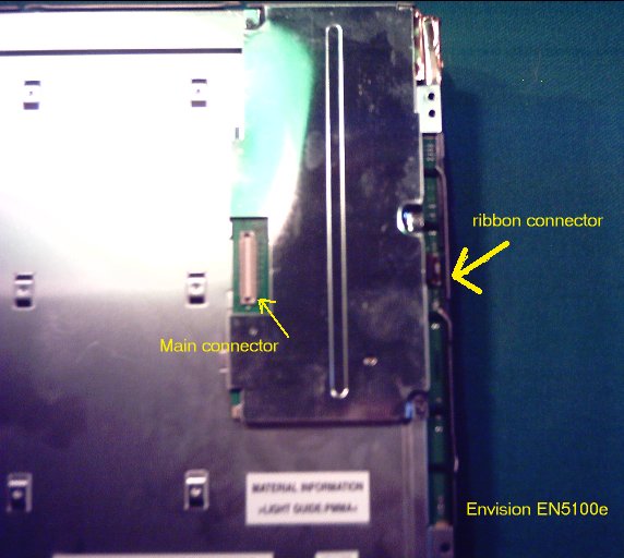

Hi, I started building a projector after reading alot of these great posts and checking out the Tom's hardware guide article. I have a Envision EN5100e and a Elmo l355 deluxe ohp. After removing the case I see the backlight panel is connected to the edge of the lcd with a short cable. Does this get removed? I've enclosed a photo. Any help or tips you could give me would be a great help. Thanks Gary
