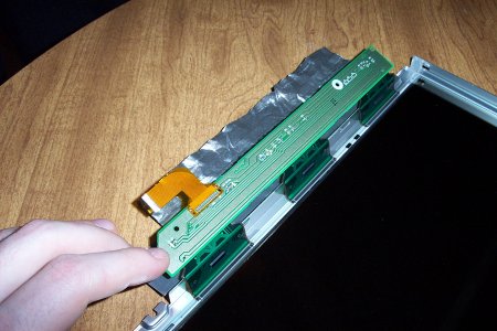

Only a little flat cable? Hehe try to lengthen it and get back to me!🙂 It's not only a little flat cable, it's a freakingly tiny flat cable with connections separate by the width of a single hair! There are many monitors out there that don't have that sort of connectors and it would be wiser to get one of those.
I have an Envision 5100e, the response time is 50ms but not destroying ~$300 LCD monitor is way more important than just the response time, at least it is my opinion!

hehehehe !!!🙂 My lack of experience is betraying me. However, you'll easily find flat cable extension in Digikey catalog. The flat cable problem is now less a concern.It's not only a little flat cable, it's a freakingly tiny flat cable with connections separate by the width of a single hair!
The purpose of the list I'm trying to build is mainly to find easily dismountable lcd panel and hopefully, give the chance to avoid cable extension etc...
Thanks for your feedback !

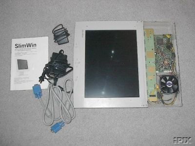

Envision EN5100e
Pixel Pitch 0.30mm x 0.30mm
Display Area 304mm x 228mm
Brightness 200 cd/m2
Contrast Ratio 250:1
Response Time 50ms
Viewing Angle Horizontal: 120 Degree
Frequency Horizontal: 30K~60KHz
Pixel Frequency 100MHz
Resolution 1024 x 768 @60Hz (recommended)
Color 16.7M
Pros:
1) Very Easy to dismantle
2) No lengthening needed - Vertical/Horizontal boards are embeded into the glass around the LCD.
Cons:
1) Slow response time
Tommy

I'm sure many saw the ebay thread with the converted slim win 15" lcd
that sweet puppy is on its way to me 🙂
