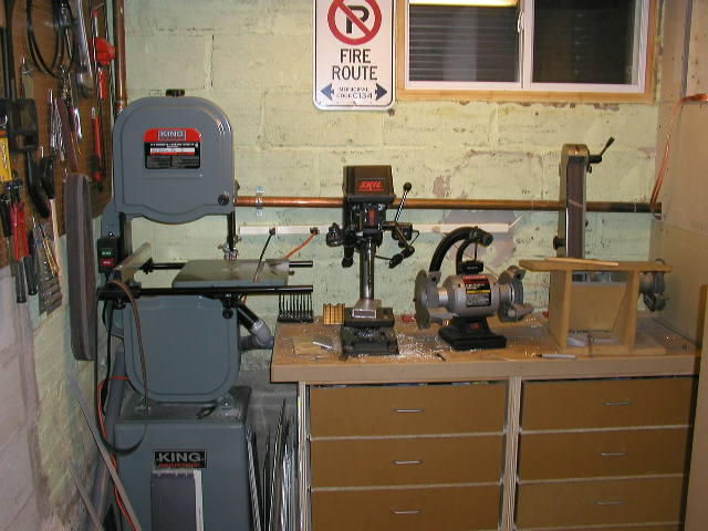

This is actually what I'm using for years. I was always thinking about upgrading to a bigger one, but somehow this one is good enough for all my needs and not too big, so other machines can fit my bench as well.;)
I also recommend buying a band saw, for metal cutting, (my first one was under $100) and a belt sander. Both are necessity for metal work, yet they can be bought pretty cheap, especially when used.
I'm using a special disc on my grinder, made of some sort of fibers, which is perfect for deburring. All machines are connected to central vacum.
