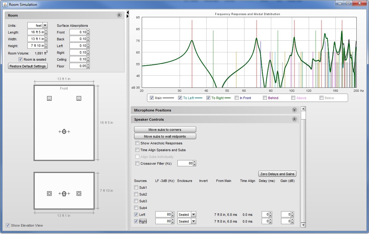

I find that there are two extremes and of course a continuum in between. 1) Make it sound like the performers are playing in your room OR 2) Create a window into a performance captured in another room. To accomplish 1), you want a dead recording (no ambient recorded venue information) and omnidirectional or very wide dispersion speakers, placed out in the room, away from the walls a bit. This ensures the sound is bounced off all the walls and ceiling and gives your ears many clues as to the location of the sound sources and lights up all the room modes and reflections. For dual mono recordings, (Beatles) It sounds like the singer is located at the speaker, or if panned, some where on a line between the speakers. To accomplish 2) You want recordings with lots of ambient information and relatively narrow fixed dispersion speakers and a dead room. (ala recording studio setup). This hides your room acoustics and presents a window into the recorded space. Of course most setups are somewhere in between.
Simulation!
So before applying room EQ, it is good to decide the goal for your room 1) or 2) above and then you can save lots of time using a simulator like the one in Room EQ Wizard to strike a balance between room treatment and EQ.
