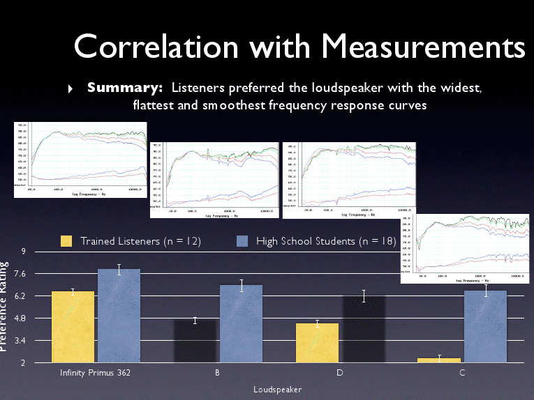

OK, I hear all the little cranky complaints about speaker placement, etc. but based on nearly 30 yrs as a Toole-watcher, don't think it amounts to serious criticism or indicates a pernicious bias in the testing against Speaker M.
How about taking on the acoustical measurement? Speaker M has a frequency response that looks jagged all over the place. Awful. Harman does an interesting official anechoic test: first they rotate the speaker on a turntable while standing up to do polar. Then they spin it on its side to do what can be called power or directivity index, depending on your theological commitments.
Anything about Speaker M that would impair it in that kind of test? Electrode spacing or shading? Inherent comb filtering? Gravity on the Saran Wrap? Fiberglass particle contamination?
Might be true about Speaker M. But my ESL feeling is that they are a sweet and smooth as you'd want while shoving heavy cardboard or aluminum domes around is fraught with danger of numerous ringings.
To make things a bit easier here are the graphs of the speakers under test
http://seanolive.blogspot.com/2010/06/some-new-evidence-that-generation-y.html
Audio Musings by Sean Olive: Part 3 - Relationship between Loudspeaker Measurements and Listener Preferences

Who would have thought it .. earthlings actually prefer good sounding hi-fi..😛
