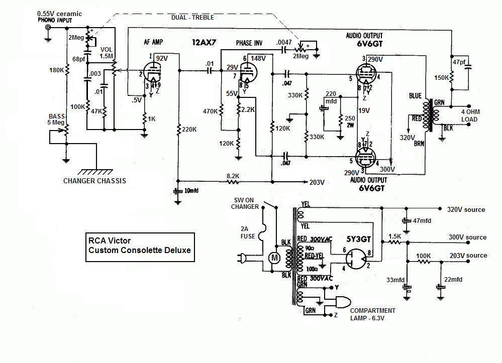

I designed this PP 6V6 amp for a phono system a while back.
Sounds great too.

Just curious, why do you need so much gain? What source are you using?
Thanks for the links..........not really "so much" but just a reasonable amount, I figured this amp would be a bit more powerful than my single-ended amps (both watts and delivery) but it sounds muted. I did spend a few hours listening to classical near-field last night, through some cheap Klipsch bookshelfs and it did sound quite nice in that setting.
The extra gang of the tone control on the phase inverter grid is inside the NFB loop where it could cause a problem. NFB properly applied tries to keep the gain across the band constant.
The other part of the tone control normally does all the work.🙂
Ah but however, there's no problems with that amp.
All that 2M/.0047u does is reduce or allow the treble feeding into the PI, in tandem with the other treble control, which feeds a bit of highs into the volume control.
Trust me, it works just fine. 😉

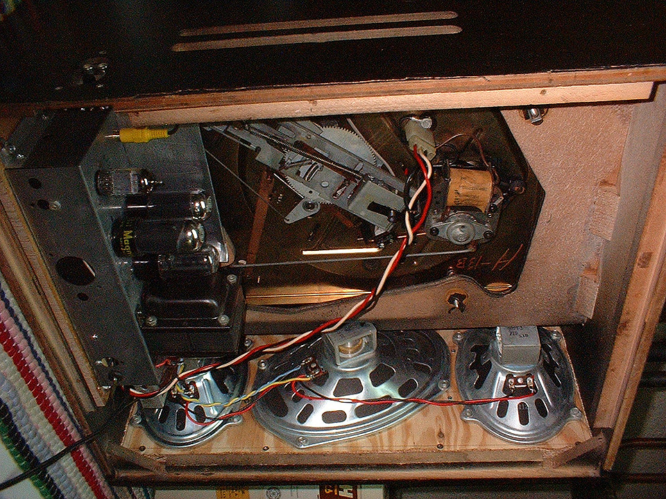

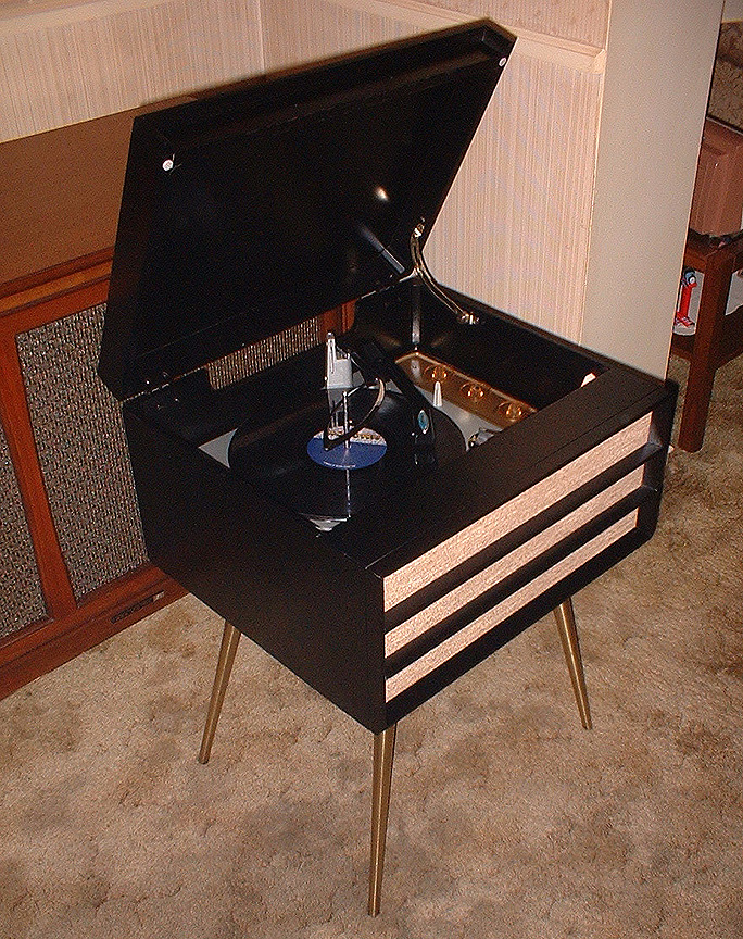

Here's the unit it's in, a small consolette phono.

The original amp from the consolette used a pair of 35C5's and small OT's, so was weak in the bass department.
Also, the front baffle was replaced with 3 full range 12 ohm speakers in parallel
My "improvements" overall result in punchy bass, sparkling treble, and turned out better than expected.
After stripping the cabinet down, a couple coats of satin black, and new grille cloth, it makes a world of difference.

Yes, the center speaker's a 6x9, all of them 12 ohms.
The amp chassis and speakers were taken from an old VM phono, similar in size.
I used the original OT and power OT, but completely re-did the amp to the above schematic in my previous post.
I also had to rotate the 5Y3G tube socket, because in horizontal use the tube must be oriented with pins 2 and 8 in the horizontal plane.
Adding a heat shield helps to keep from cooking the changer above those tubes.
So basically, the whole front baffle is loaded with cones, and the result is beefy bass that you can hear in another room.

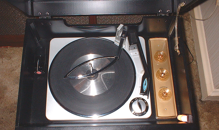

The record changer's an RCA, taken from an old 1963 stereo console, but wired for mono with a different better cartridge.
One of my customers gave me a set of tapered legs that were optional for that table model cabinet.

And the RCA changer, while being completely overhauled, has some minor enhancements done, and tracks records nicely at a respectable 4 grams.
