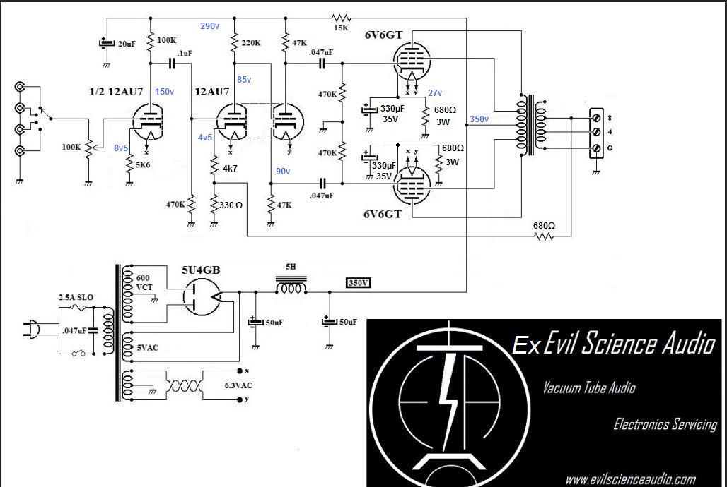

I've recently completed a 6V6 pp amp, built into a Magnavox 175ff chassis, based on the Dynaco A-410 here. Since completing it, I've reconfigured the power supply to use the stock Magnavox choke (.75 H) and some more capacitance. This was after following suggestions to plug the original design into PSUD and finding it to have pretty poor smoothing. I'm now starting to realize the whole design is full of compromises and what originally attracted me (simplicity) is a weakness in terms of front end gain. Two options I'm looking at, since I want to maintain the power section and the chassis are the original Magnavox design or this from Evil Science. The Evil design seems to have fewer compromises. I'm also liking it because I can get the required B+ using diodes and there should be enough heater current for the extra 12AU7, since the original Magnavox was originally designed to power a separate preamp. I would guess the Evil design utilizes 8k outputs but it doesn't say specifically. So which would you pick? Thanks for the help, I'm very new to most of this and learning a lot as I go.

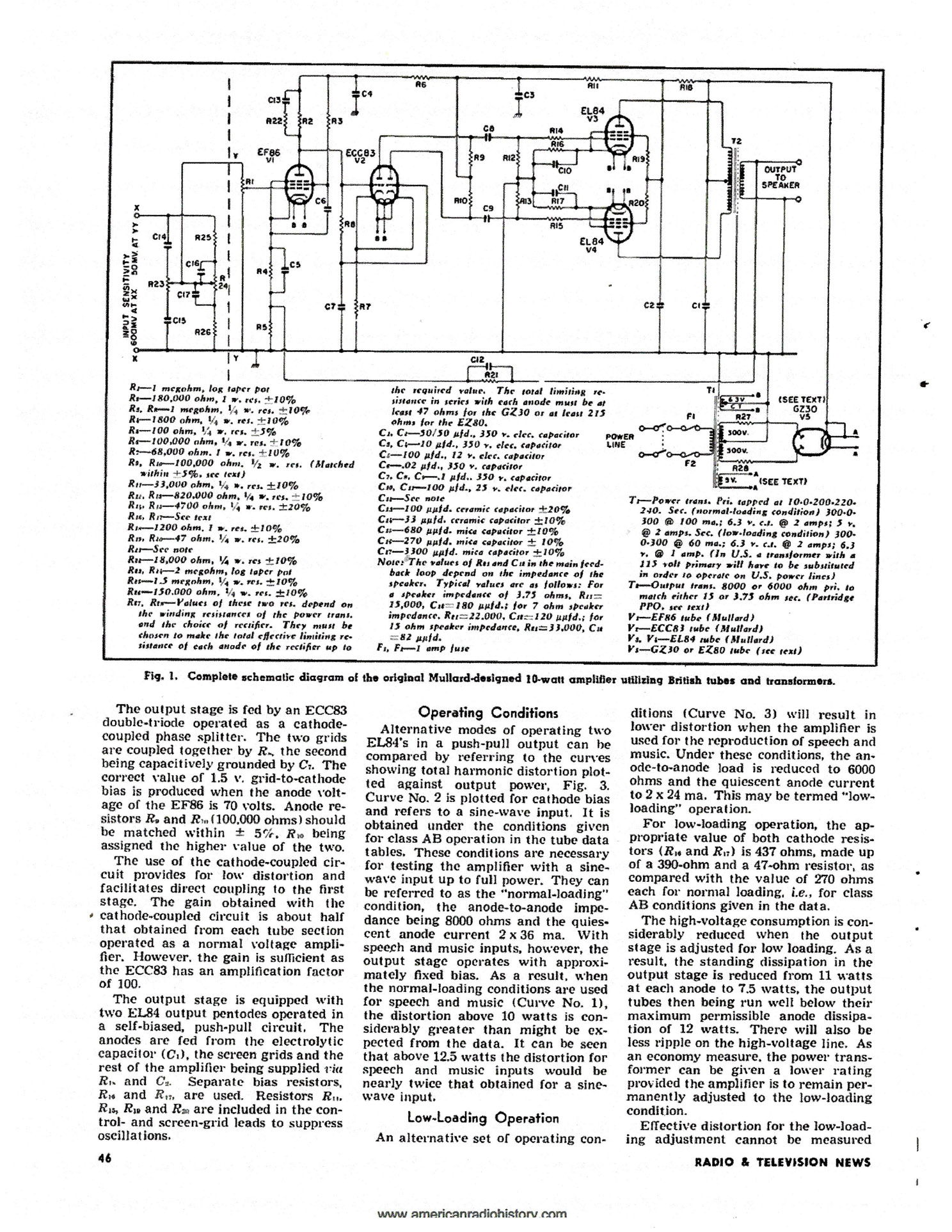

When with the same tubes & other parts you could build a bullet proof classic, the Mullard 5-10. Built by thousands, many articles published including plenty of modifications to further improve performance.
Attached one of the original articles on this side of the pond describing the circuit in detail. And a bonus tone control front end.🙂

That's with EL84, here we talk about the 6V6 needing more then double input voltage.
And who needs a pentode front these days, to much gain and noise.

All too true, but an amp designed for 6V6 or EL84 with proper biasing & OPT can be interchanged in almost anything. Don't think he has an EF86/Z729 anyway, a small triode will work well on the front end. With somewhat less gain.
If there is tube noise from a power amp, it is seldom from the front end. Better start looking somewhere else.
This is not rocket science at all. I don't subscribe to tube rolling, but this design challenge is not much more.🙂

Yeah, I think for my next amp I want to go with one of the "classic" topologies but for right now, I'm looking for a way to get a bit more gain and punch within a fairly specific set of parameters:
1) needs to work with the Magnavox 175 chassis and power supply, this means at most, one or two extra small (300ma heater or less) front end/phase tubes
2)needs to work with a 10w 8k output transformer wired in ultralinear
3)can't require more than a 350ish volt B+ at around 150ma (see pt limitations)
The three I posted all fall into this category (more or less). I'm glad to see some of you like the dynaco but to me it sounds a bit weaker than its 10-ish watts would suggest. All of my amps to this point have been 8-13 watt single ended units that deliver better bottom end and a more coherent overall presentation.
The Evil Science PP 6V6 Amp is very ordinary aside from the extra half 12AU7 on the front end. If the 2nd tube was a 12AX7 the extra tube would not be required.

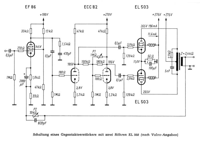

Many of those using the EF86 pentode as a front end simply connected it as a triode to reduce gain not required. There is a minor adjustment of the NFB network required, usually OPT dependent. Don't think that something that worked for someone else will work every time. It probably won't.🙂
More phase inverters attached, somebody liked them.

"The Evil Science PP 6V6 Amp is very ordinary aside from the extra half 12AU7 on the front end. If the 2nd tube was a 12AX7 the extra tube would not be required."
Dynaco did this in the ST35, (with EL84's and some positive feedback, but still) back when type 7247's still roamed the Earth, so this could be considered "classic". Mona's corrections are essential with random modern transformers, but the 7247's aren't.
You will have a hard time building a DC-coupled concertina with V+ of 300V driving the 6V6

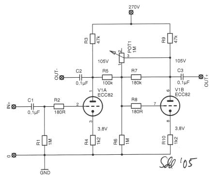

There is a capacitor missing (both schematics) unless you like +110V on the grids 😀
Mona
There is a capacitor missing (both schematics) unless you like +110V on the grids 😀 Mona
You are absolutely correct. When I find these trick circuits I make a copy & set it aside for future reference. One of those examples has what looks like a date '05', noted by the author. Both appear to have been drawn by a professional. I guess the error simply slipped thru the system, no one noticed till it had gone out the door.😱

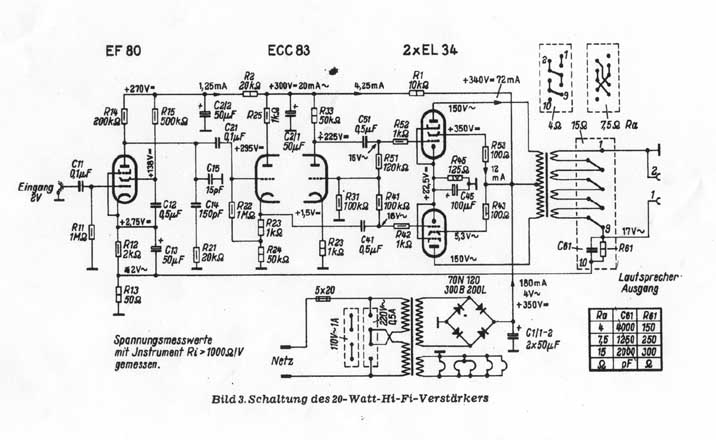

Attached another utilizing an anode follower from my file driving PP EL34s this time. It appears to be a production drawing.🙂

You will have a hard time building a DC-coupled concertina with V+ of 300V driving the 6V6.🙂 Mona
A good point, a problem many designers run up against. So AC coupling between those stages avoids that. Or use a pentode front end like a 6AN8, all in one bottle.

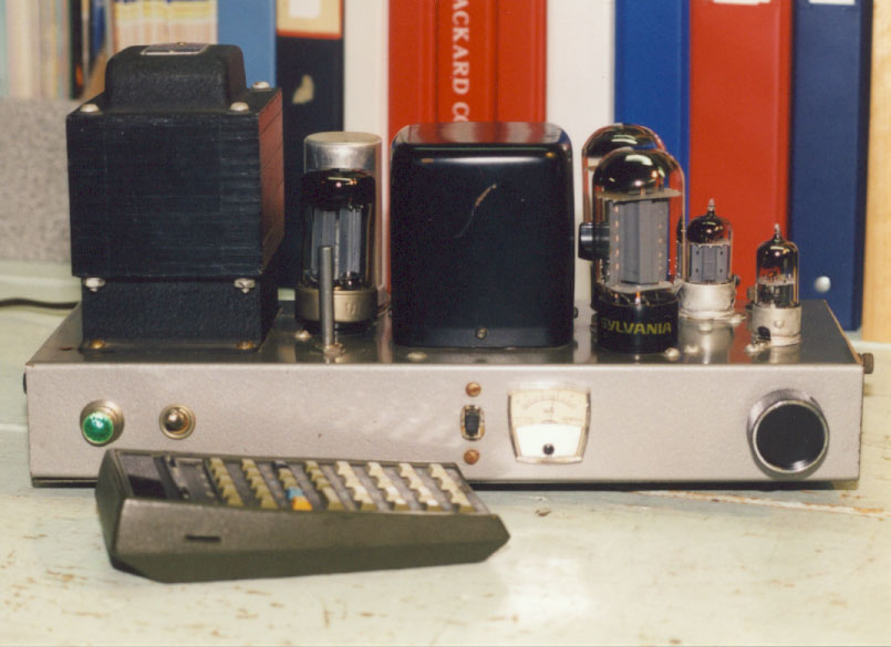

I went a further step driving PPUL 6L6GCs in a pair of amps built for my own use, the front end is a 6AU6 direct coupled to both sections paralleled of a 12AU7. That was circa 1962, they were in constant use till 1977 when I bought a Sansui AU717.🙂
