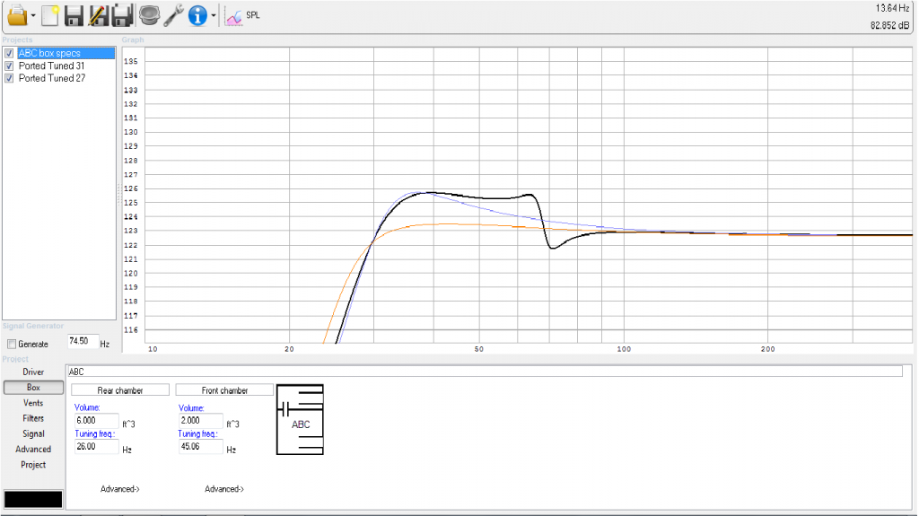

There's an spl graph that IMO shows a much flatter frequency response, between the ranges the woofer will be playing. The dip is also very significant because that's near where the sub will be cut off anyways.
excursion reduction is not a factor in either instance. This enclosure just appears to be the more efficient, and I have yet to hear one with my own hears. Why not build one?

Well yes, we were modeling two completely different drivers in very different tuning scenarios. If you implement a LPF right where the dip is, then yes it becomes insignificant. I had thought you were going to implement this setup with a LPF in a more "traditional" location in the 100Hz region.
Is that a simulation using the 12W7 you had mentioned before? It appears that the increase in sensitivity occurs mainly right before the higher-tuned port resonance; otherwise it is on-par with the blue graph, which I presume is the 31Hz tuned ported box.

You stated before that you want wide bandwidth, your simulated response shows only about 1 octave of passband. That's fine though, if that's what you want, it just doesn't match your previously stated goals.
Anyway, what you are doing here is using resonances spaced very closely together to get a narrow band of gain. There's nothing wrong with that either but there's ways to get this done a lot easier than this complex box with 2 chambers and 3 ports.
In fact, I'm simulating something VERY similar (using closely spaced resonances to achieve some narrow bandwidth gain) but I'm using a MUCH simpler box. It's a simple folded transmission line with about 220 cm total length.
Same effect but with more bandwidth, much easier to build, much easier to modify after the fact if desired.
BTW, once you put that your simulated response in car it's going to be anything but flat, it's going to boom like crazy around 35 - 40 hz. That's fine if that's what you want but don't think it's going to be anything close to flat.

It's shown in .5 pi space as opposed to your 2 pi graph, that accounts for most of the difference. Usually you don't model in .5 pi space but since this is going in a car it's kind of appropriate.
by means of wide bandwidth I thought an octave was pretty wide when compared to an "efficient" ported enclosure.
Look at the red line in the graph you posted. It's flat up past 200 hz. (Not including inductance or any real world issues like that.) And it will continue to be flat as high as the driver can play. That's wide, flat bandwidth. In that case there's only a single peak from the box resonance down at tuning, that's all the box contributes. But when combined with the driver output you get your wide, flat bandwidth.
Impedance peaks provide very narrow bandwidth peaks. This is true in all cases. But if you cluster a bunch of impedance peaks together, spaced close to each other the net result is relatively flat gain across as much as 3 octaves, that's how horns work.
A simple ported box has the one peak at it's fundamental tuning frequency (and others higher up that WinISD doesn't calculate and we can ignore for now). Your double chamber box has 2 peaks spaced close enough together to flatten out the dip between them. If you move those peaks further apart you will see a dip in the middle, same as a 6th order bandpass.
