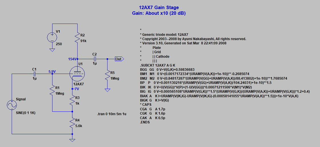

You can only reduce the gain so much by simply increasing the cathode resistor, without also shifting the tube's operating point way "to the right" on its load line. At extremes, you can be operating the tube at very low currents where linearity is poor. Local degeneration mitigates this, of course, but it's better to operate the tube in its linear region instead of relying on local feedback to clean things up.
An effective approach to lowering stage gain without compromising its operating point is to split the cathode resistor into two resistors, as shown in the attached LTspice file. The load line plot for this stage is also provided. Resistor R3 establishes the bias for the stage and the gain is set by R2 and R4. To reduce gain, reduce R2 while increasing R4 such that the sum of R2 and R4 remains about the same (about 100k in this example). This will keep the operating point in about the same place while the gain is changed.
The only downside to this approach is that there will be a positive voltage on the grid so an input DC blocking capacitor is required. But that is a minor disadvantage, I think.
I hope this helps.

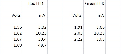

Example of LED Resistance at Some Currents
These are HP LEDs from the 80s. For the Red LEDS, if we take the diff between lines one & two the average resistance is 8.32R. Likewise the others lower down the list are 2.48R & 1.09R. That won't stabilize any common amplifier.🙂

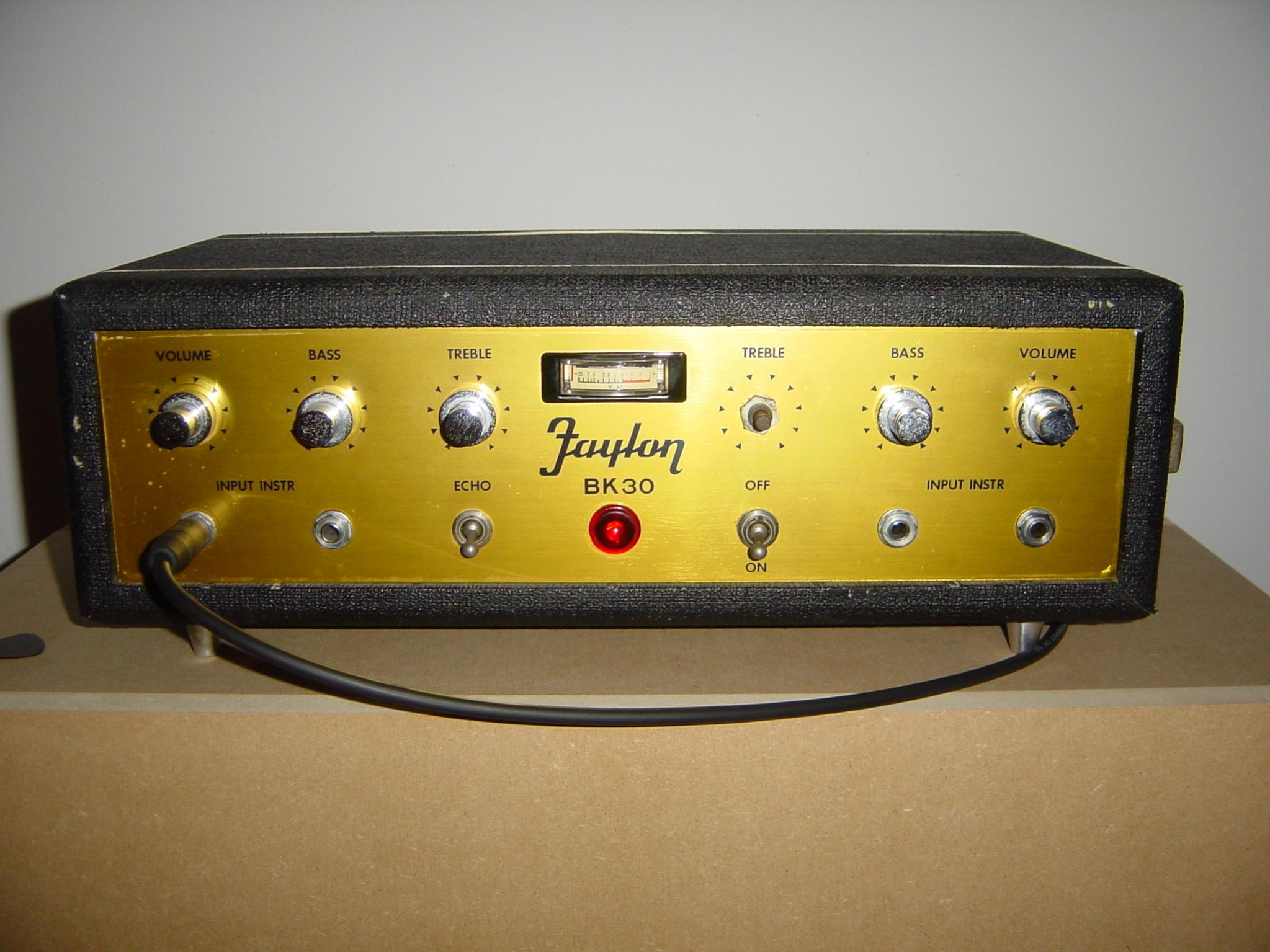

This Faylon BK30 guitar/instrument amplifier, of which I drew up the schematic, has feedback from plate to grid in the first stage of the two channels (and an ultra linear power stage).
A very quiet (noise/hiss-wise), and very nice sounding amp.
One mistake in the schematic though: The OPT is a Philips AD9047, the power transformer is a Craft 28TP4.
