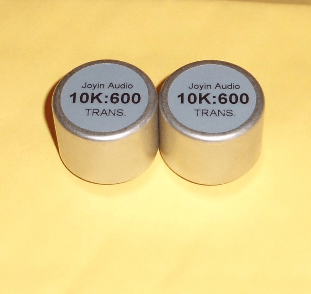

Hi guys, Well nothing has worked so far. I loading the CD input with resistors. it made a little reduction but nowhere new enough. however on browsing I found this recommendation. Which is a Jensen unit, trouble is cost is to high,

what abouth this:
4:1. a pair for $55, plus $ 15 ship - max input about 2V RMS I guess. It's permalloy, sensitive and very wide-band.
but silly to make a preamp than then discard the gain.
Why not take the route of a 1:2 transformer and use that for 'gain'?
